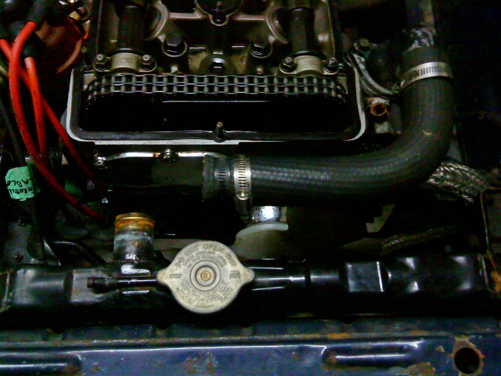

I have the standard k series radiator in my car with the 2tg and as the picture below shows the hose doesn't have the bend to fit on. As I see it I have 2 options
1. find a hose with that 90 degree bend in it - any ideas on that one?
2. Get a piece of metal pipe to fit between the hose I have and another hose that is a 90 degree bend...

as you already know just did my conversion and i did what red did... get the inlet moved to the other side. only took half a day for the rad shop to do it.
if you want to go down the cheaper way or get a ta22 radiator bud that might work to and it should fit aswell
Get the outlet moved as redwarf has done. Definitely the best solution - that is what has been done on my club racer.
I rang a radiator place and changing the outlet over is not much hassle.
My perhaps stupid question is, with both outlets on the same side of the radiator wont it make it pretty inefficient?
The coolant is still going to get pushed through the radiator by the water pump, so I can't see it being a big issue for cooling. Radiator place would know best though.
Out of curiousity, I wonder how a flipped AE82 Twincam hose would go. Looks like this, so just mirror-image it and cut it down to the right length
it would work but i have a feeling he has been convinced on moving the outlet on the old radiator across,
IMHO you should have just found a ta22 radiator and used that

Yeah i have been convinced. My radiator is in good condition and I think everything will look much neater this way.
