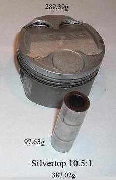

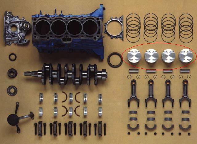

yes it will bolt on fine(albeit smallport has an external oil drain in the head which the 20v st doesnt or vice versa), there is the possibility of the pistons hitting a valve in the head, if you compare the 16v/20v piston you can see they are both fly cut differently, so there must be a reason why toyota redesigned the 20v pistons rather than reusing the 16v pistons
