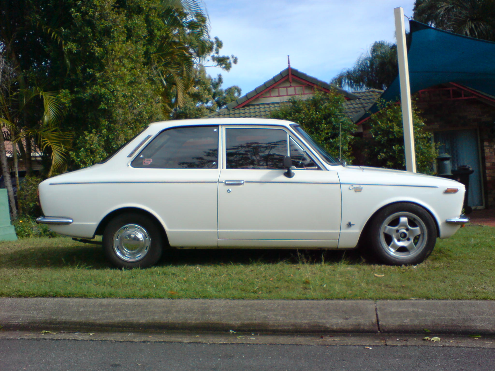

considering lowering my ke11 at the front,
obviously cutting the springs is an option but i am going to steer clear of that as its dodgey..
what setups are people running? brand of dampeners and springs..?
i have had a bit of a look around there is not to much out there for ke10's most places only have listings from ke20 onwards..
are ke20 front struts different from ke11??
any help is greatly appreciated
cheers
henry :)
