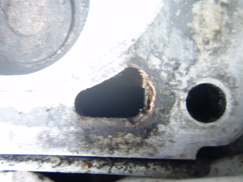

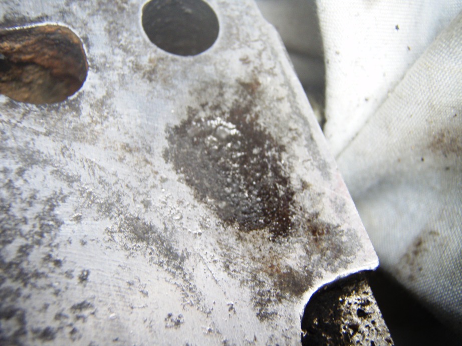

Hey guys, recently took the head off my ke55 as the oil was very milky and as suspected the head gasket was shot. Now the block appears to be fine but I'm not so sure about the head. one of the water galleries seems pretty corroded and there seems to be a kind of rough / indented spot on the head that isnt the gasket. Ive got some pictures and just wondering if this head could be fixed up or if id be better off just getting a new head
get the head re-faced, they take a tiny amount off until it is flat (usually 20 thou)
the corrosion is normal on any old engine, my 4age one is worse than yours
just get the head skimmed and it should be good, also don't forget to remove all of the old gasket from the block and sand it was a very fine (240+ grit) sand paper to make sure that its a nice face to bond with
Thanks for that, i figured i could get the head refaced but was worried about the corrosion. Cheers
That corrosion should be fine. You'd be hard pressed to find a head without it.
