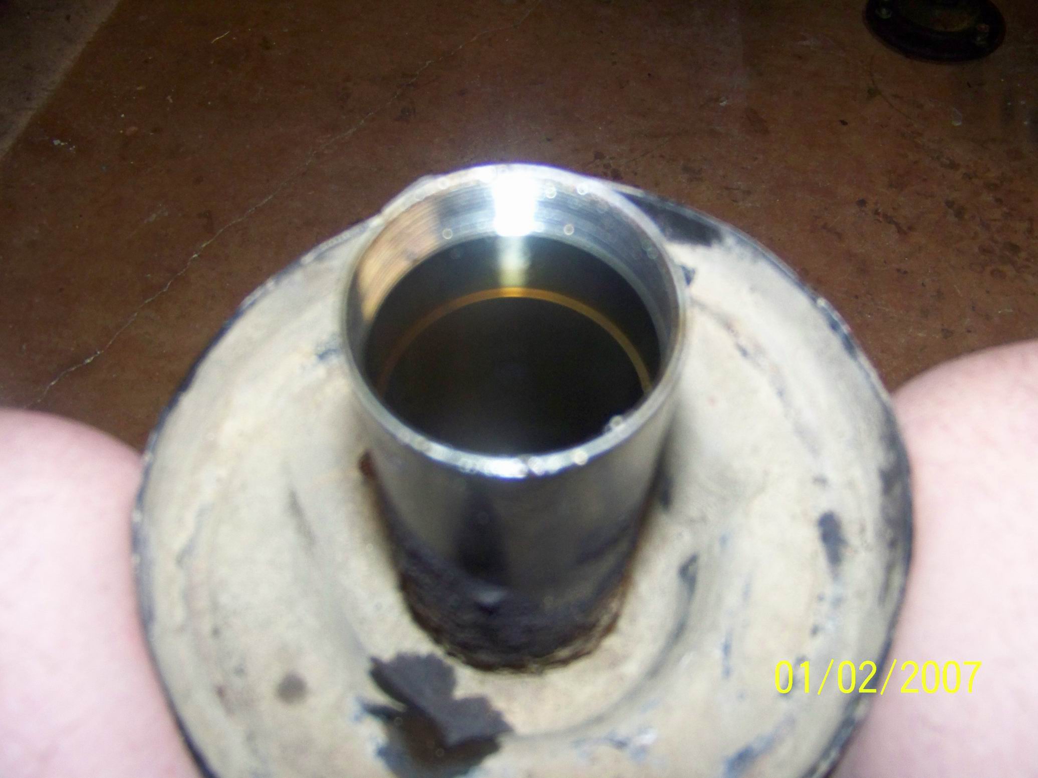

towe001 Posted September 21, 2009 Report Share Posted September 21, 2009 Righto here we go Length - 408mm Internal width - 43.5mm but as you can see in the picture - 32mm down the tube is where it narrows down (at a guess about 1mm thick) Quote Link to comment Share on other sites More sharing options...
