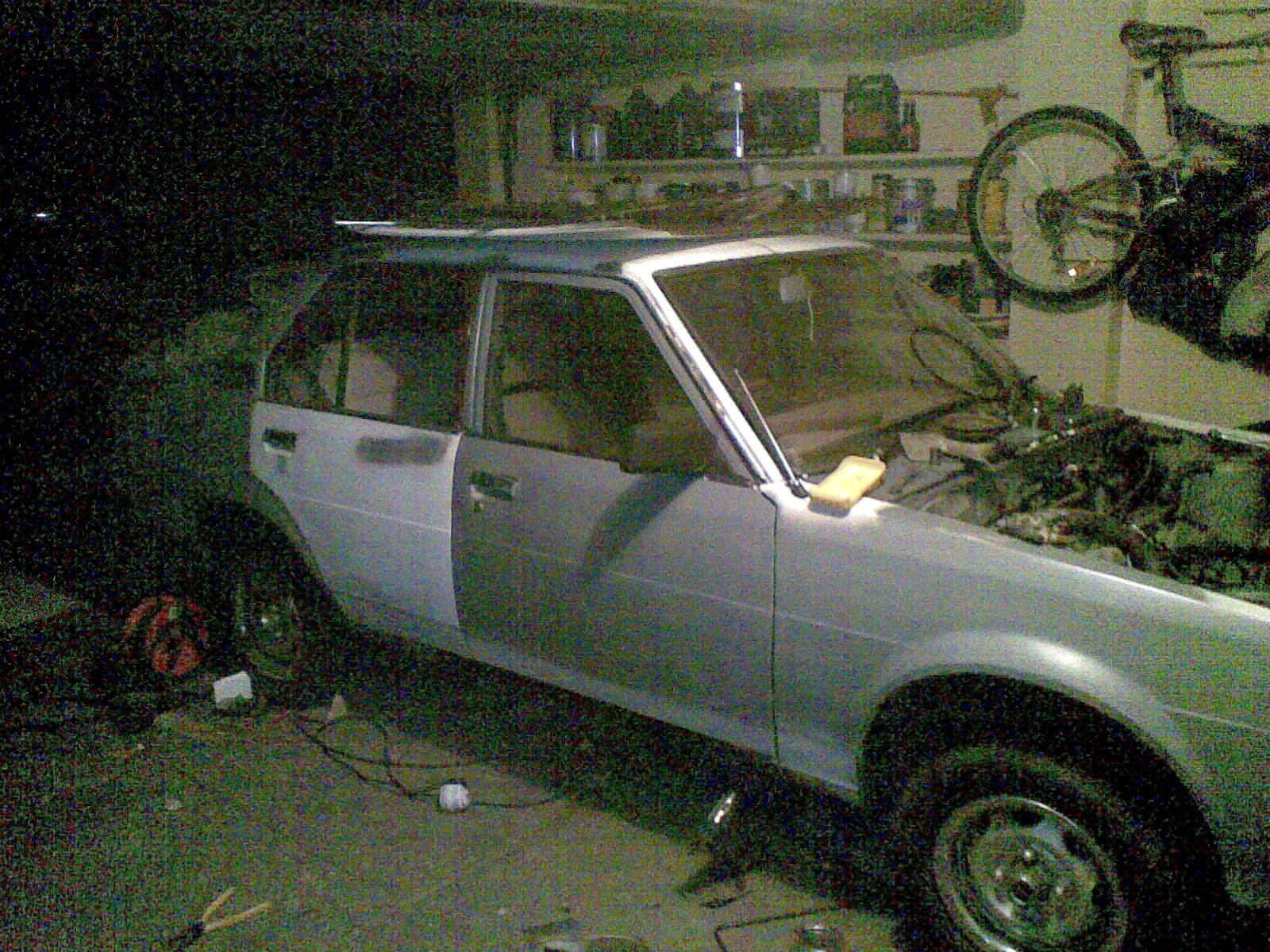

got paint on it all now just couple more coats and put it all back 2geva
