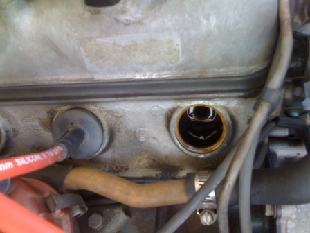

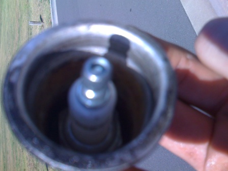

Stixy Posted October 22, 2009 Report Posted October 22, 2009 (edited) Ok so I’m not too in the know about the old K motor, but something doesn’t seem rite about this, I went to take the sparkplugs out of my mates 70 and as i undone the sparkplug the whole surrounding spun with it......... it kinda looks like someone has forced the wrong size plugs into the whole...... is this ok??? call me stupid but i have never worked on a 4K-c before Exhibit A Edited October 22, 2009 by Stixy Quote
jason12 Posted October 22, 2009 Report Posted October 22, 2009 Ok so I’m not too in the know about the old K motor, but something doesn’t seem rite about this, I went to take the sparkplugs out of my mates 70 and as i undone the sparkplug the whole surrounding spun with it......... it kinda looks like someone has forced the wrong size plugs into the whole...... is this ok??? call me stupid but i have never worked on a 4K-c before Exhibit A That happened with me as well, i just unscrewed the plug out of the cup, guessing then you just slide it back in (havent reinstalled them myself yet) Quote
Taz_Rx Posted October 22, 2009 Report Posted October 22, 2009 Yeah no dramas at all. If the cup come out then just remove the plug from it, screw in new plug, then screw the lot back in. :lolcry: Quote
philbey Posted October 22, 2009 Report Posted October 22, 2009 (edited) That's pretty standard. I usually fit the cup onto the plug before screwing the new plug in too, so you don't get confused and crossthread the plug etc. damn taz beat me to it.... Edited October 22, 2009 by philbey Quote
Stixy Posted October 26, 2009 Author Report Posted October 26, 2009 Awesome, thanks a lot everyone, i had a little mini freak out Quote
