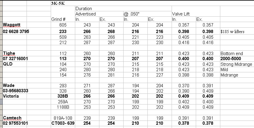

Here's as far as I've got- These are the milder cams that everyone offers.
I'm going for the Waggott 233, but this is a runaround for my daughter so you could easily go 275 to 280 duration.
They all quoted about $180 including facing the lifters and mailing back to you.
