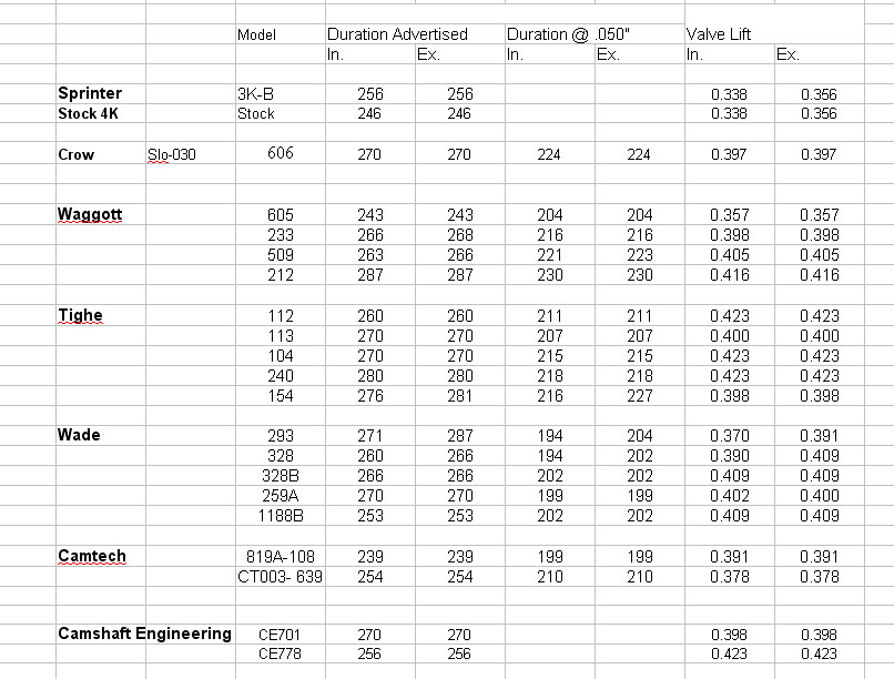

Here's the list of mild cams I assembled. All these companies do hotter cams than these.
I used Crow, it took a week & a half, cost $170 for a cam grind and followers refaced. The cam I picked (the 606) is right on the 0.4" lift, above which you need to get Holden 202 Red motor valve springs.
