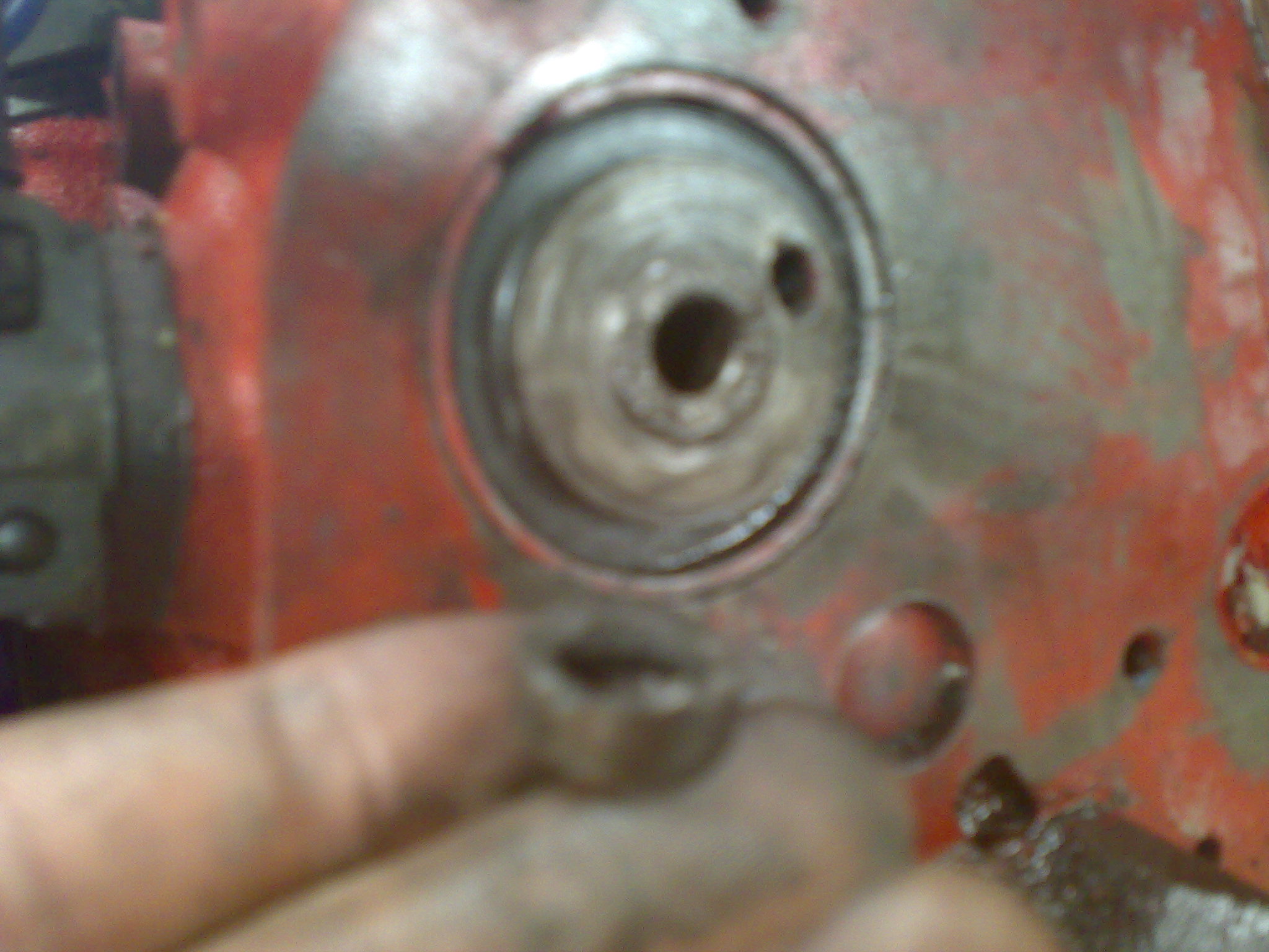

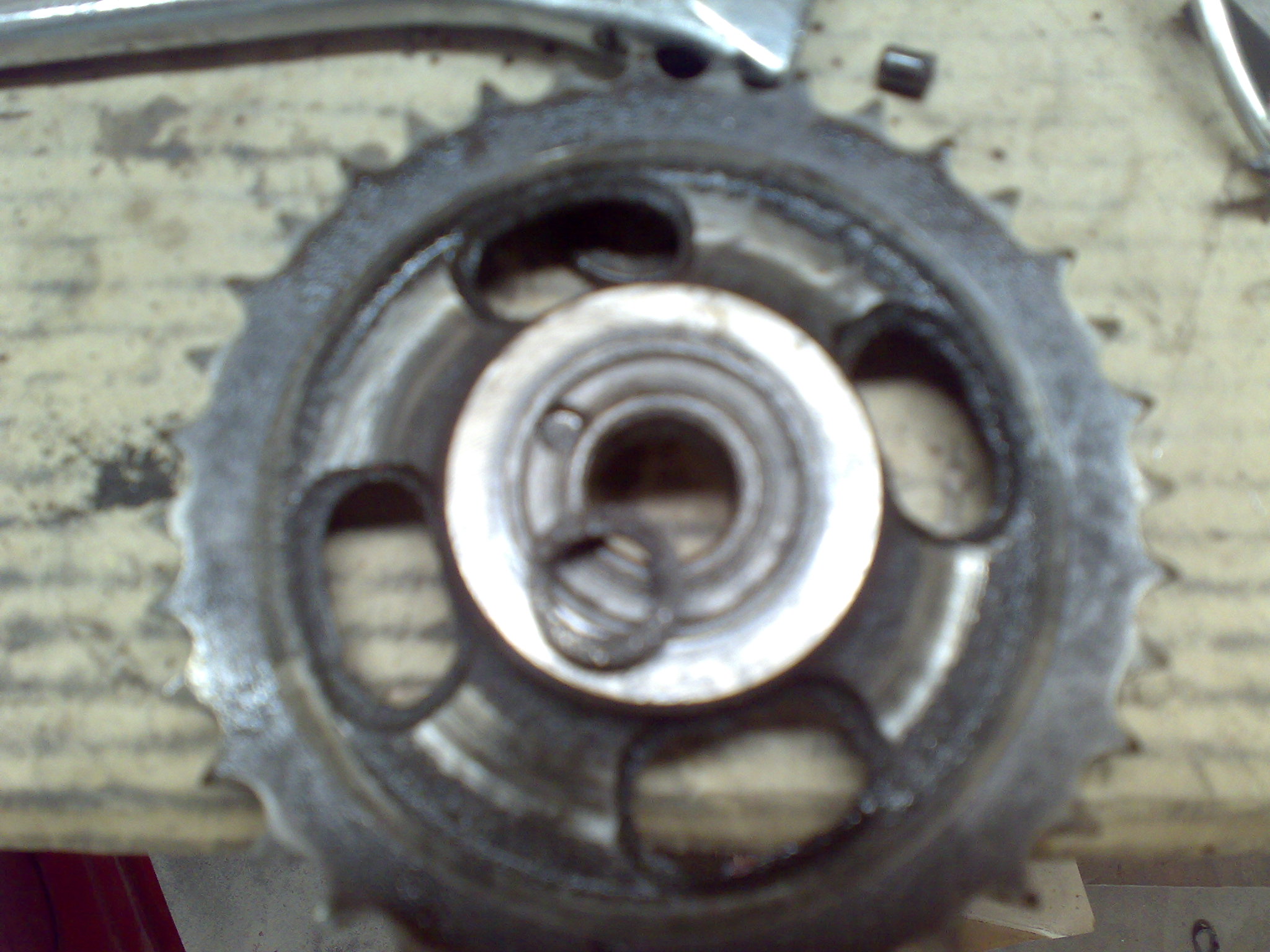

hi guys i was getting my car ready too sell , i just added a 40doce Weber and a few other things, so my problem is i went to start her and it sounded weird and began to flood its self cut a long story short the timing chain pulley that attaches to the cam was lose and sheared the 10mm neck off the end of the cam and snapped the key way , my quire is while the car was running for a few short seconds will it have done damage to the valves and push-rods or anything else
i demand pics! to check for bent valves, put a small amount of kero in the intake port, remove spark plug and check for any liquid in there.
maybe cover the port with your hand and put some air pressure in there for a more obvious results
and will the cam be fixable where the key way is cracked out now , i don't want to bin it its a big cam

Sorry to tell you but I think you'll be binning that cam. There's to much force going through that end that even if you could get it welded up then it would most likely just break again.

yeh mate it's screwed. Fatigue failure, it's always going to be at the keyway, it's the fundamental design flaw with keyways. Sharp Edge = Stress raiser = eventual fail.
