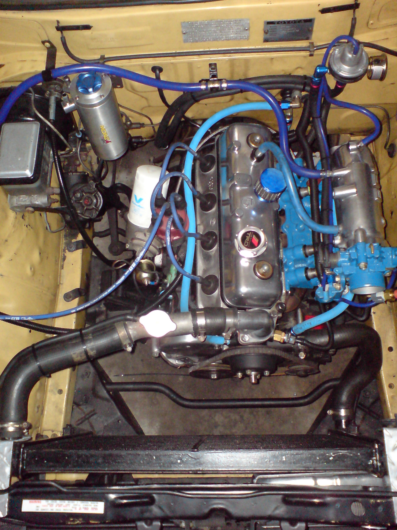

bezender sent me a few interior pics, so thought i'd throw them up in here.

Hate to say it mate but I think you might be up for a struggle to fit 7ke gear with that turbo location.
I'll take you some pics an measurement of my engine bay and we'll see.
In the meantime see if benzeder can take another pic of the bay looking directly down on the engine.
Thanks si. Just sent him a text to ask if he could get that pic and also a measurement from rocker cover straight across to get roughly where the turbo housing is
He said there is 90mm from where the inlet manifold bolts to the he's to the flange on the turbo. And it's 40mm forward of the head. He has taken pics for me and I will put those up on here after work whn I can get on my laptop. On my phone now
