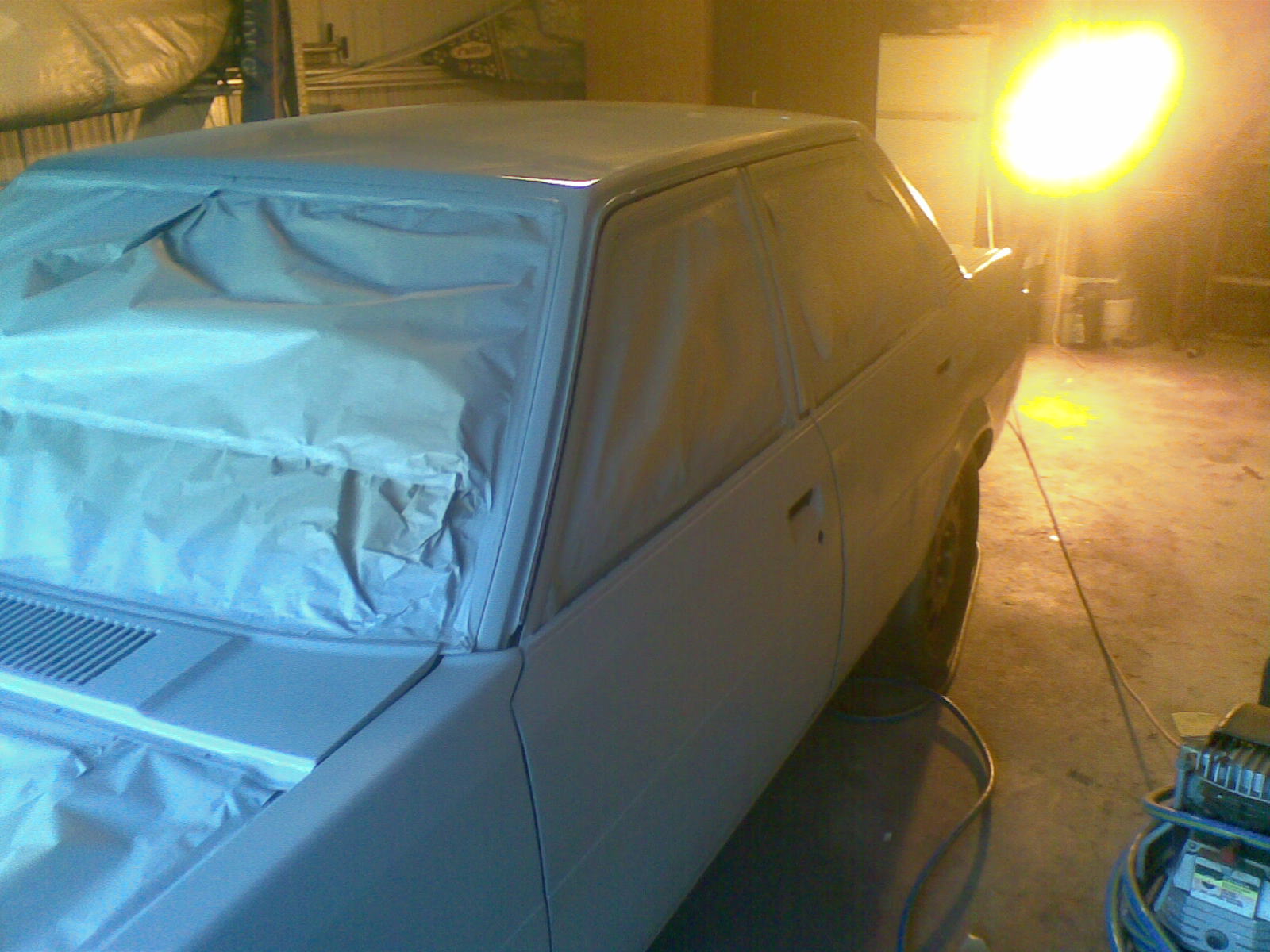

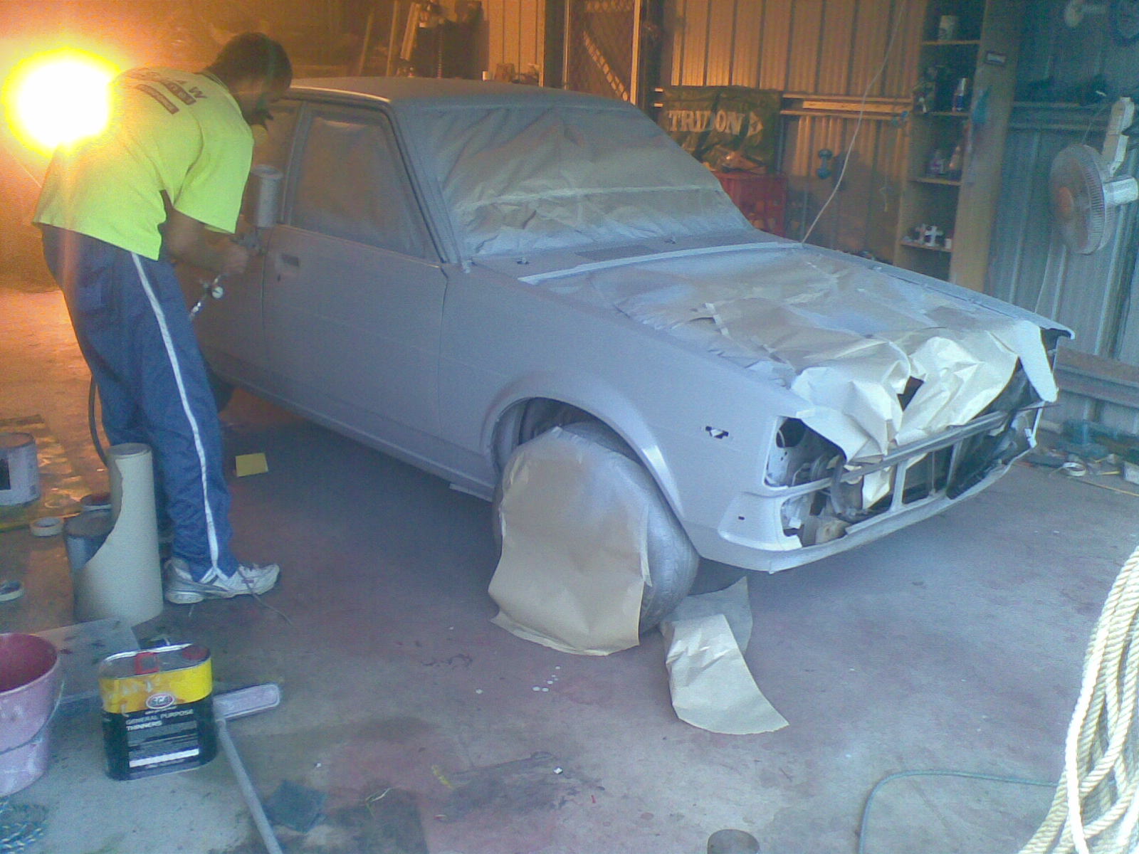

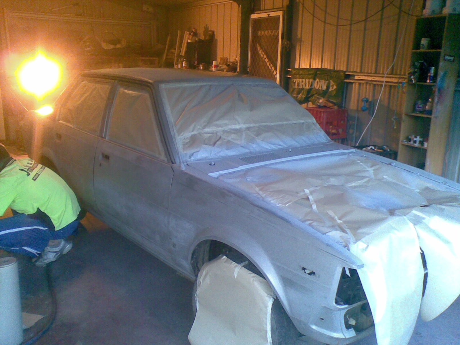

i primed my car today turned out pretty good do some final sanding on Saturday , then paint away
