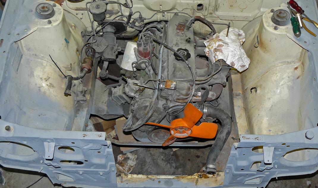

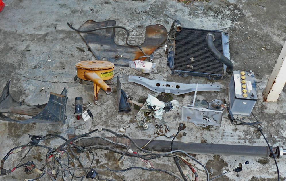

Got a few things done today!
Got sick of panel work so gone mechanical. :blinks:

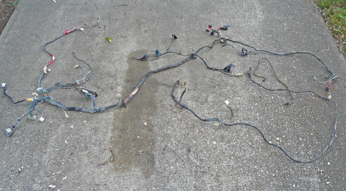

Removed all the wiring loom in one piece!

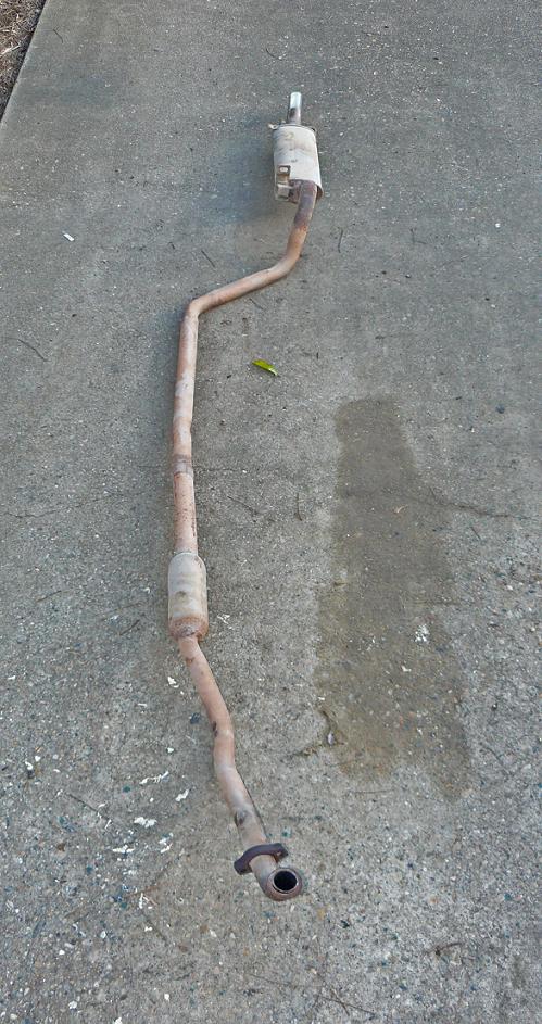

Exhaust and tail shaft out.
Radiator and support panel out.
Motor and box are ready to remove. :hmm:
Just waiting on getting an engine crane and then I'll be getting the brake lines and steering out to go over the engine bay and clean it all up.
All the old bits will be sold in the next few weeks, will only need a few of the original bits to go back in.
Finally decided to do the right thing and go for full engine management. :blinks: On the look out for K E.F.I. loom and manifolds.
Thanks for looking!

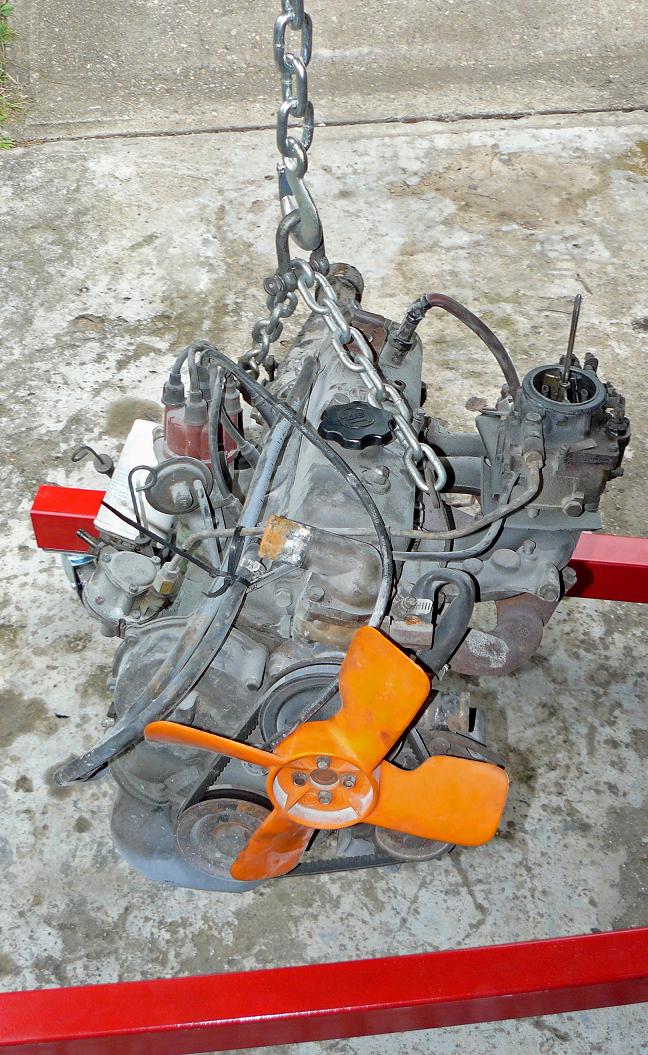

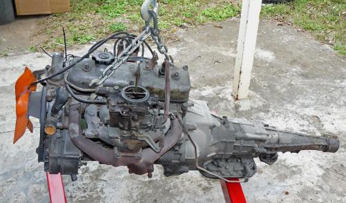

Finally got myself an engine crane, Fold up one, good when you have no space at all! :D
Got the motor and box out in one piece. Anyone have an idea on how much I should sell it for? :(

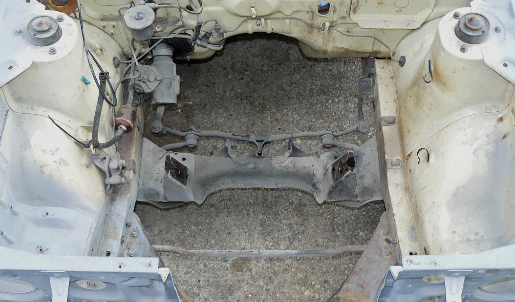

Helps having the radiator support out so much easier than some other cars.
Now need to get all the engine bay clear and make a start on that soon.
Now the search is on for the rest of the conversion stuff!

if you have a compressor and the space. i would invest in some garnet and a gravity fed garnet gun.
sandblast the engine bay. much mcuh easier and your guarenteed a clean sureface for the paint to stick to. not to mention it can get into all the nooks and krannies
and clean all your rust off.

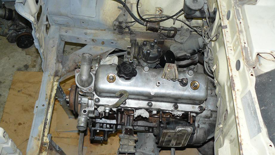

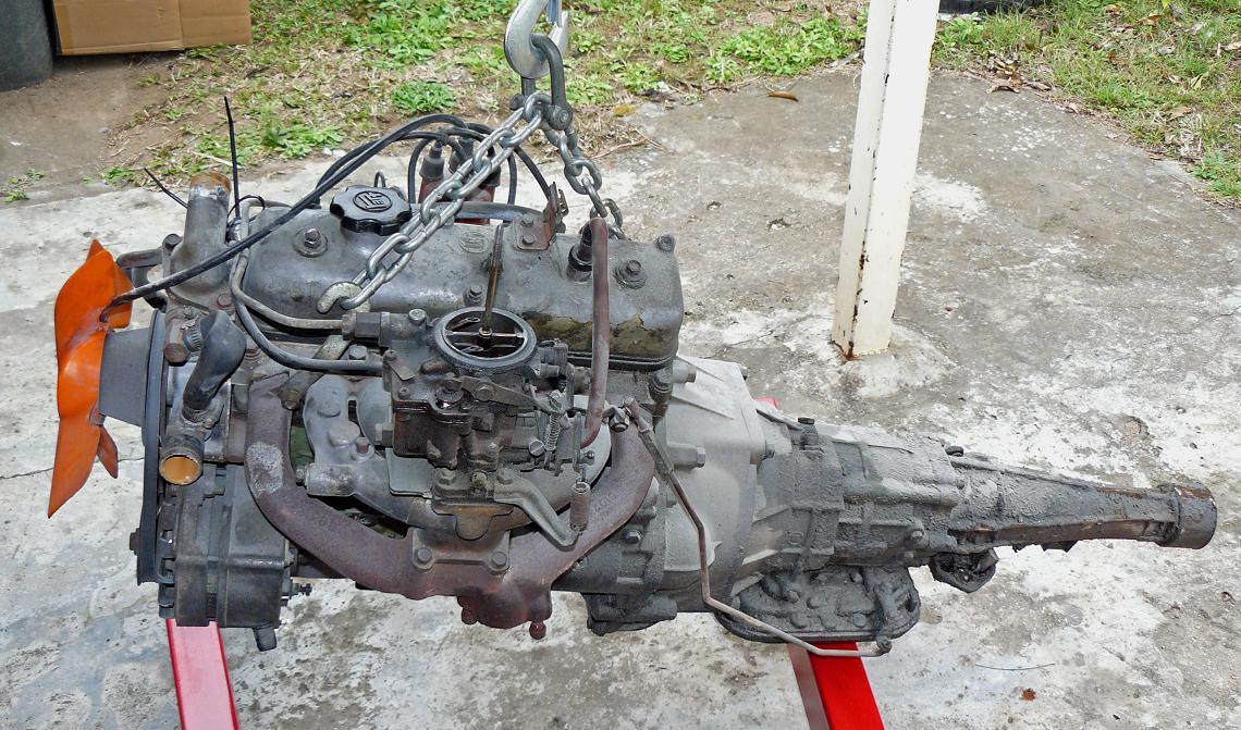

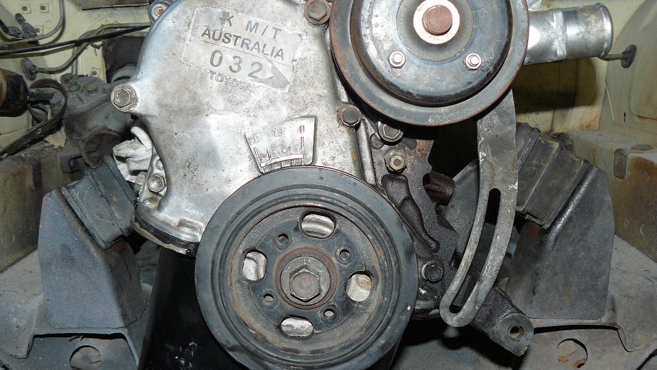

Picked up my new motor and gear box!
Got a K motor and an early W series box.
Test fitted and it seems to fit OK with the 3k mount on the motor.
Problem is the box hits the tunnel a bit so be onto that tomorrow, otherwise seems to line up.
Might get away with using the Toyoglide mount for the box?
The guy reckons its got some head work done but I don't know, looks a bit bigger than the 3k but yeah.

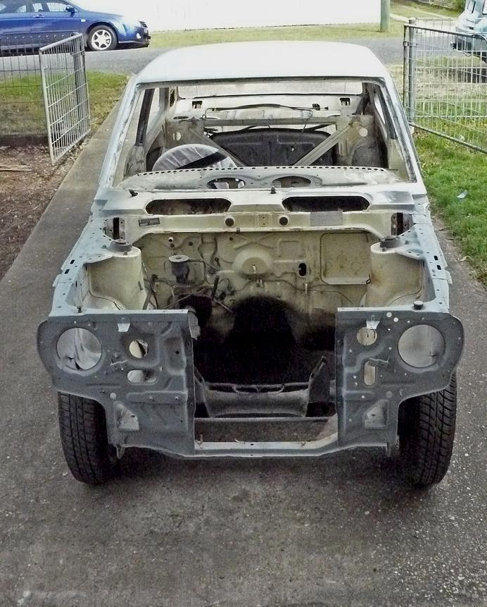

Big week ahead, have the week off to play round and strip the old girl down till just the rolling shell left.
Going to get the engine bay soda blasted, don't have the room, compressor, patience or the knowledge for doing that sorta detail the way i was doing it!
Ill post during the week to see what else i find...... Bloody rust and dodgy repairs!

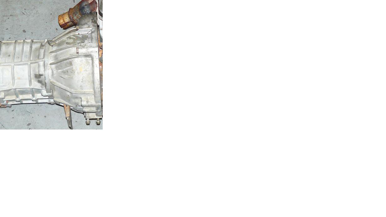

Out of interest, what bellhousing are you using with the w box ?
Cheers,
Dougal
Cheers,
Dougal
I have no idea!
I just got it complete and seen it working in another car! :yes:
It doesn't look weird?
Ill try and find out.
Edited by Handiman
Ok. I have heard a few guys mention K-W bellhousings and apparantley they are quite rare. That's why I asked.
