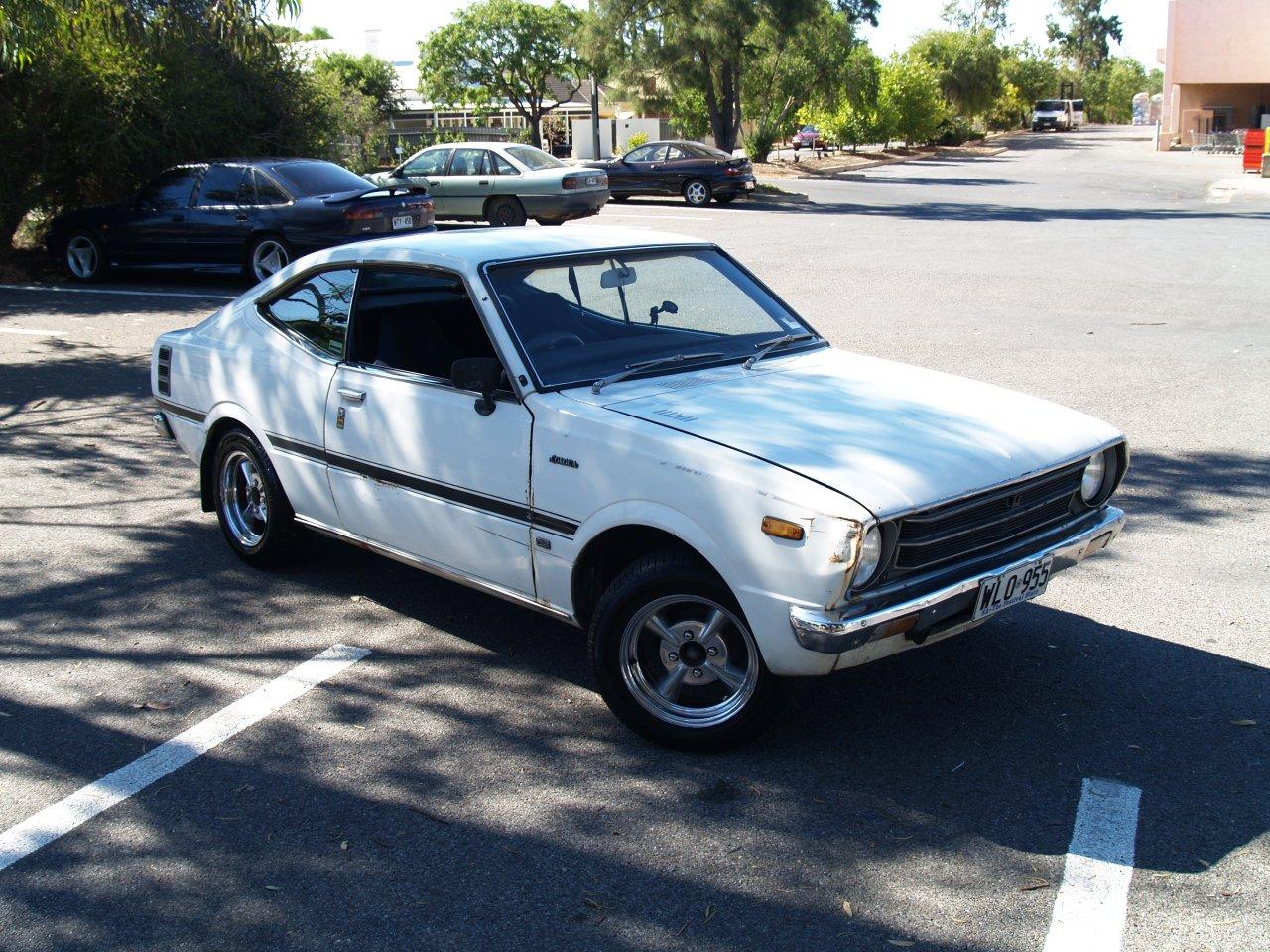

I don't know how people are feeling tonight but be prepared to get abused, first off use the search function and you'll find heaps of info on that, if you want brand new twin sidedraft webers i mean i'm not veteran at this but you'll be paying over a grand i reckon. I got told recently if your not going to fully mod the car put a 32/36 downdraft weber on it everyone does it and they go quiet good. I've pretty much got the same car, except mines a '78 ke35, done the rims, exhaust, rebuilt the motor, tomorrow i'm putting bigger brakes on. If you want to go down the weber path i have a 45 sidedraught here with a manifold that i might be selling soon, but you'll be looking at about 370....
Here's what mine looks like at the moment....
