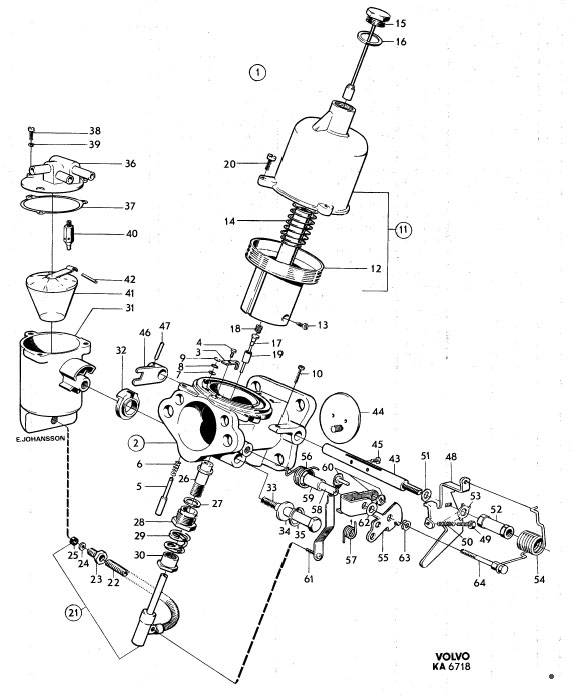

Well, last night I had the airbox off and lifted the slides to see how the throttle plates compared in their idle position.
There is a small (few mm) distance of freeplay in the dashpots (slides) before the shock absorber works in the oil properly, so the slides jump up quickly to start with.
One slide had twice the freeplay of the other, meaning it might flutter up and down quite differently. I played around with them and found it was much more even if I swapped the dampening valves over between the carbs. I'll drive it today and see if that helps.
You may be right, but I hope not! :abuse:
It would be a lot of work to pull it all apart and match the manifolld & carb with epoxy. Certainly it must be generating swirl vortices at higher air flows, but the problem is only from 2000rpm down to 1000rpm with zero throttle on over-run.
At that stage the throttle plate should be on idle and the engine has high manifold vacuum as it sucks hard to pull air through the closed throttle plate. I'm using closed throttle plates, not the newer ones with the relief valve set in them, (44 in the diagram) so there's another thing to look at.
