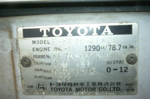

If it's a DX in NZ it's on the Build plate.
Have a look at the pic!!
under trans axle, first letter and number is the gearbox the next letter is the diff code.
All assuming this is a DX and not an Aussie car.
