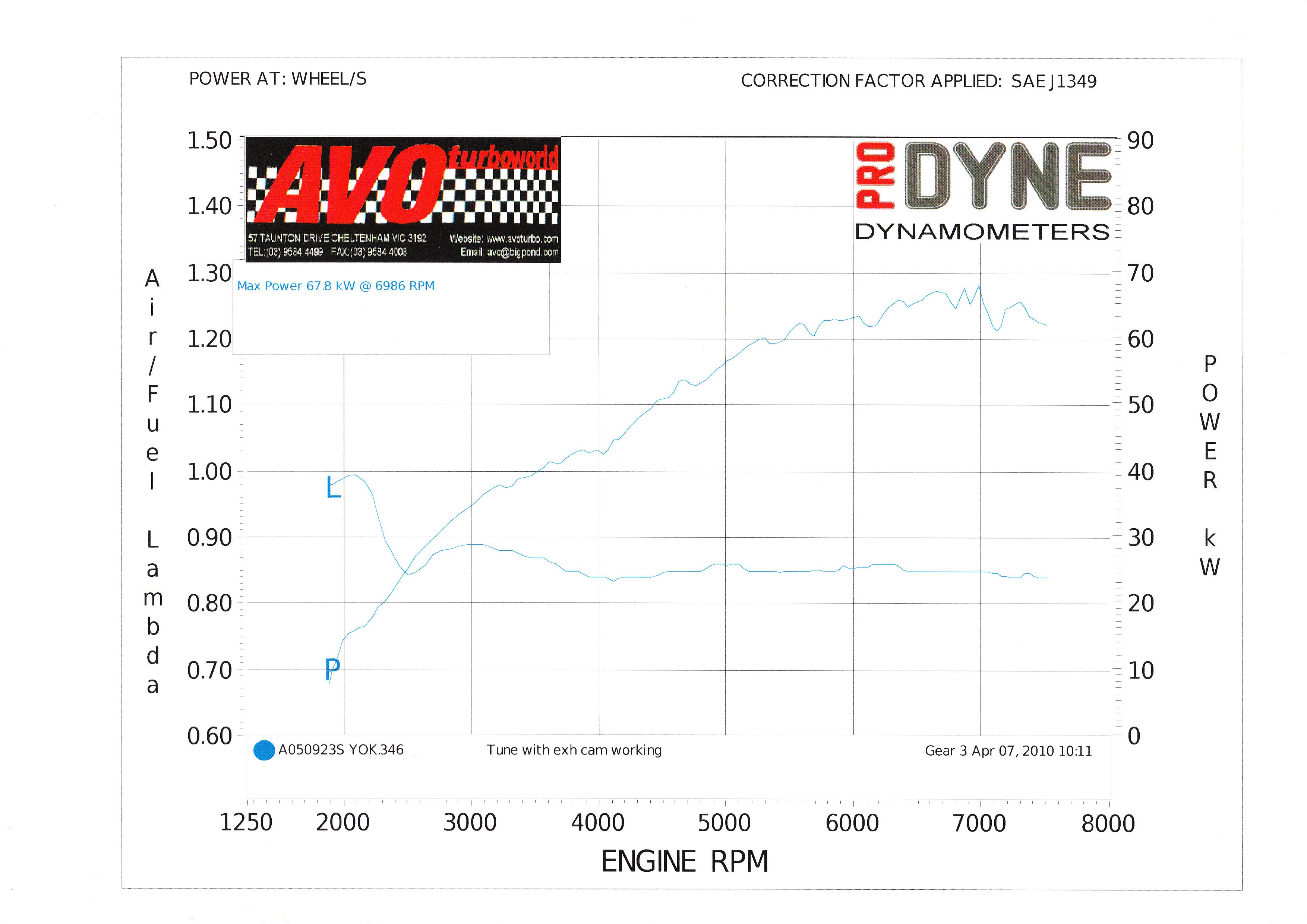

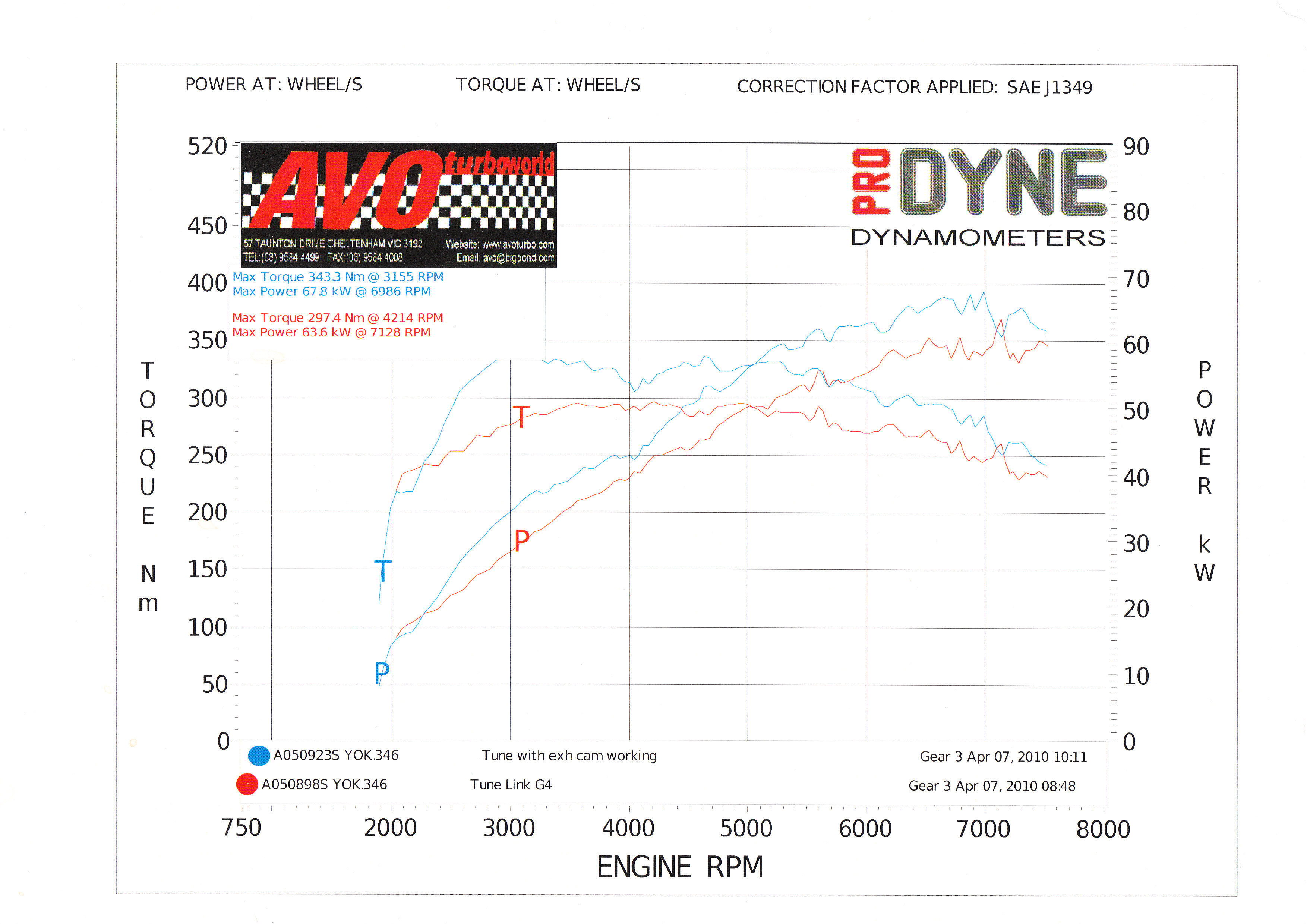

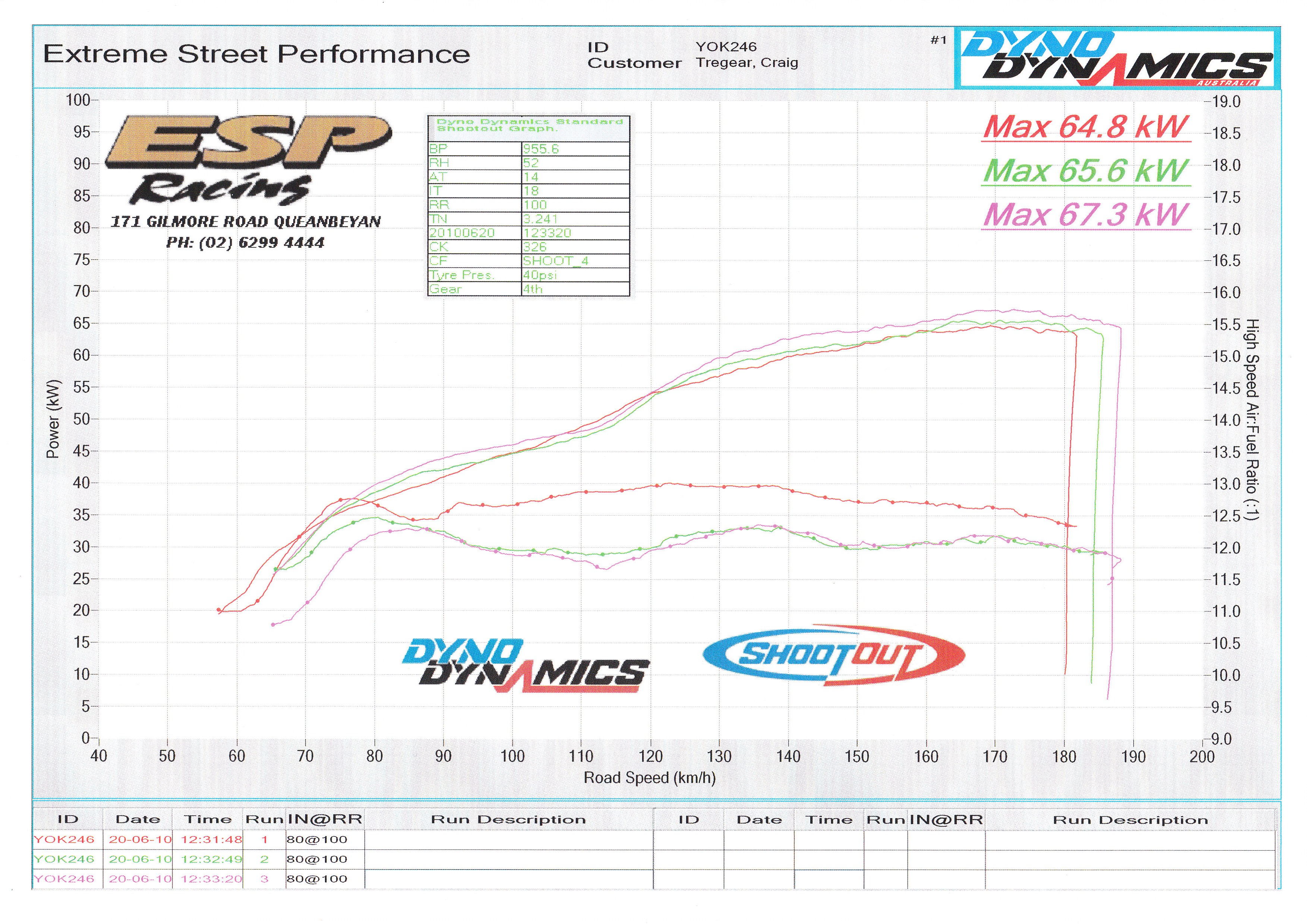

As I said, ran it on two different dynos, 67.8 on the first 67.3 on the second.

There is definitely something not quite right with mine.
Chart from first dyno run
Air/Fuel chart
Second dyno run
Have you ever double checked the cam timing? Trying to find some other dyno plots with torque of a 20V to compare yours too. Out of interest, have you ever done a compression test? Has to be a reason its not making as much top end as it should, and thats 2 different dyno's right? A tooth out on the cam timing or spinning the VVTI cam backwards when doing a timing belt could get the cams out of whack.
