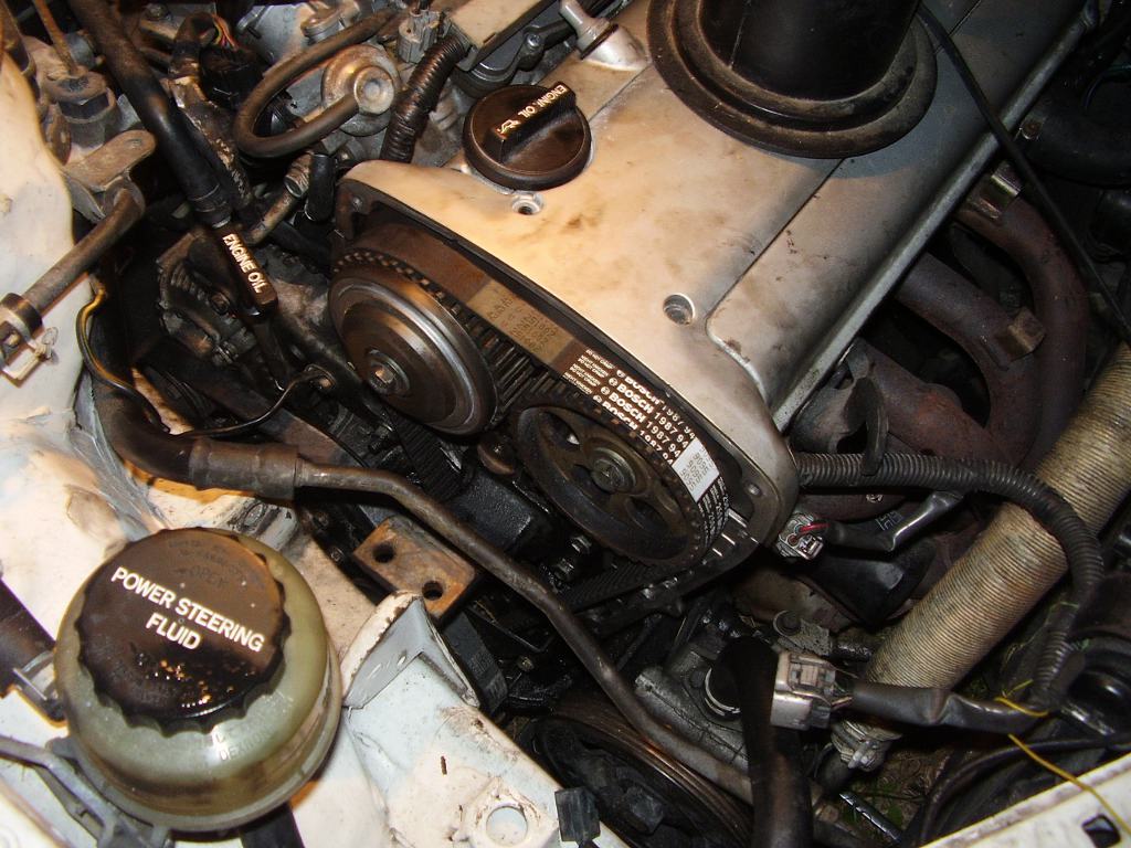

Replaced timing cog which was mangled by previous owner
New Bosch timing belt
New seals

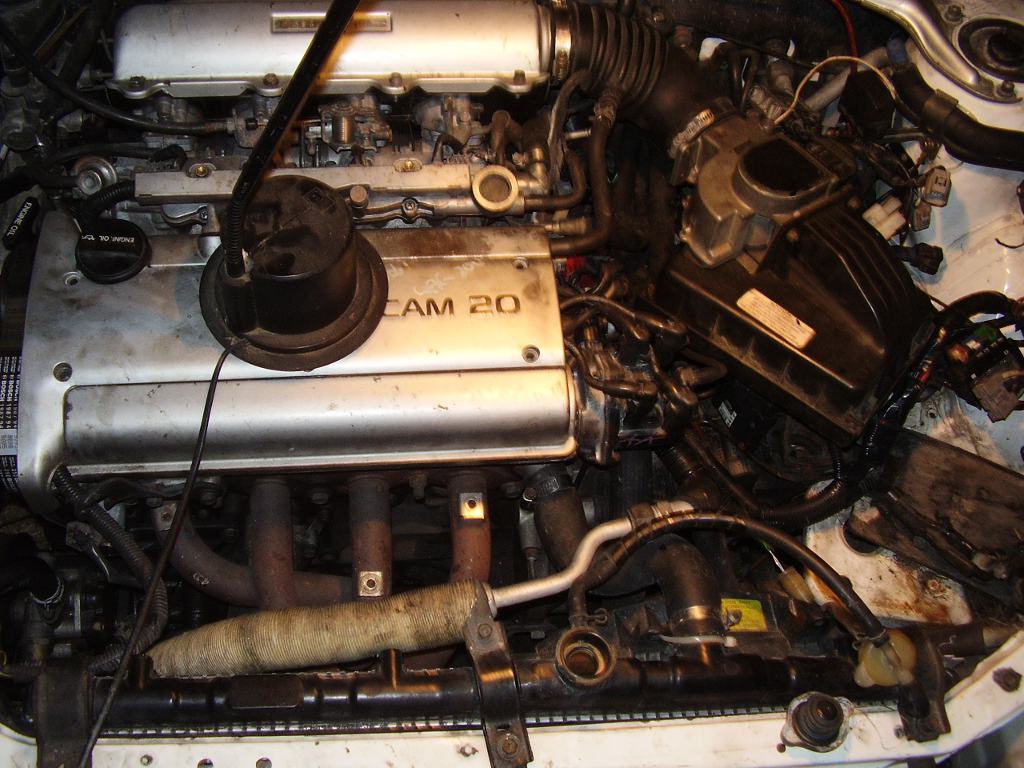

Did the standard clean the gunk from the the ICV and sealed all the air leaks on the airbox. I cleaned and recalibrated an SV21 camry afm, as the 20V are a bit rare, works flawlessly with some patience.

Finally drove it today down the long driveway with no hatch, windscreen or interior - dam it had some get up and go with 150+kg of the car still in the shed - and that's only hitting 1/4 throttle. Ran the motor for a good 40 minutes today without any dramas.

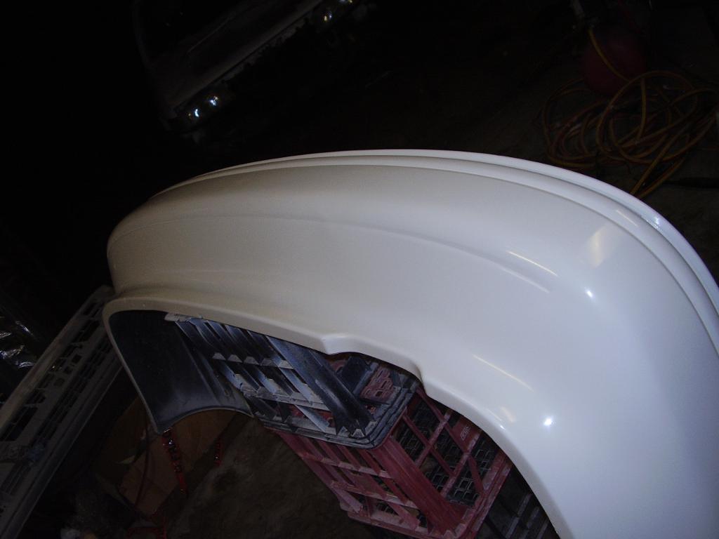

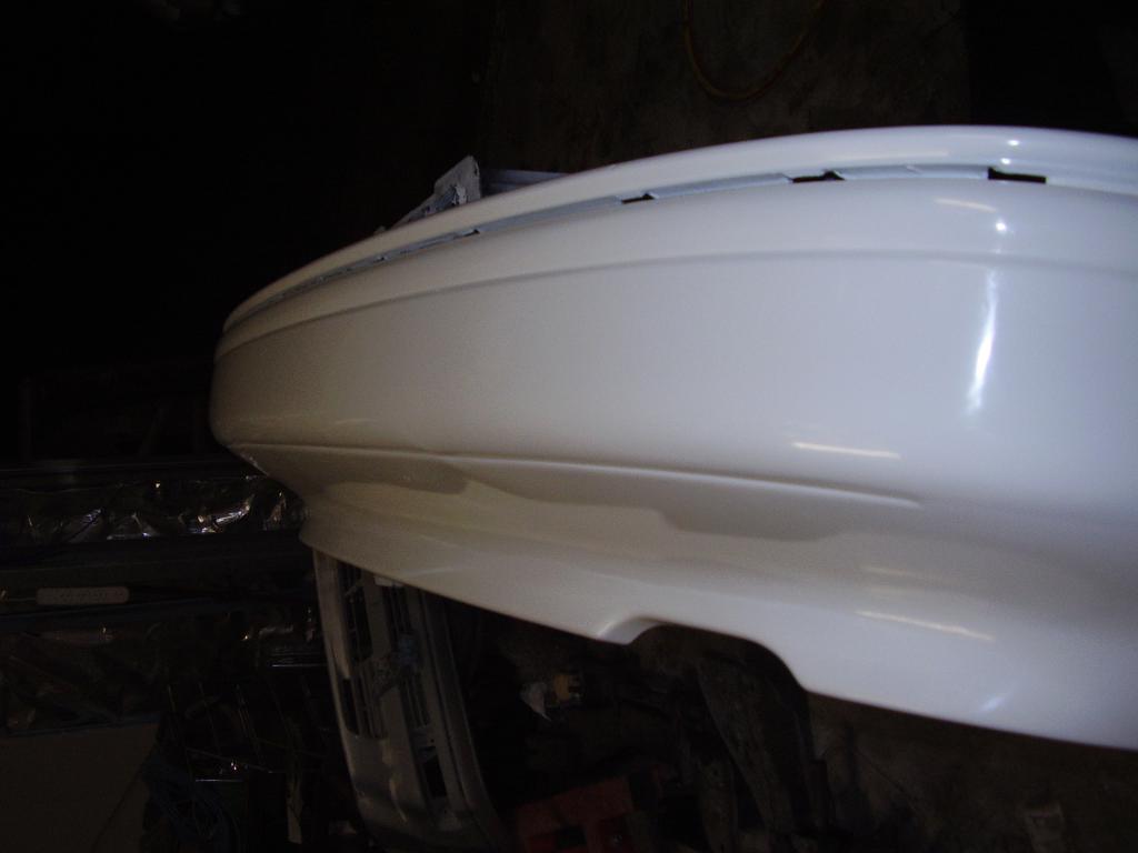

Tidied up and resprayed the rear bumper, got bored and decided it was time to rub it back after a week in the sun. I didn't get too carried away with the prep too much (2 hours) - but for bumpers they came out quite well. Still need a proper cut and polish.
