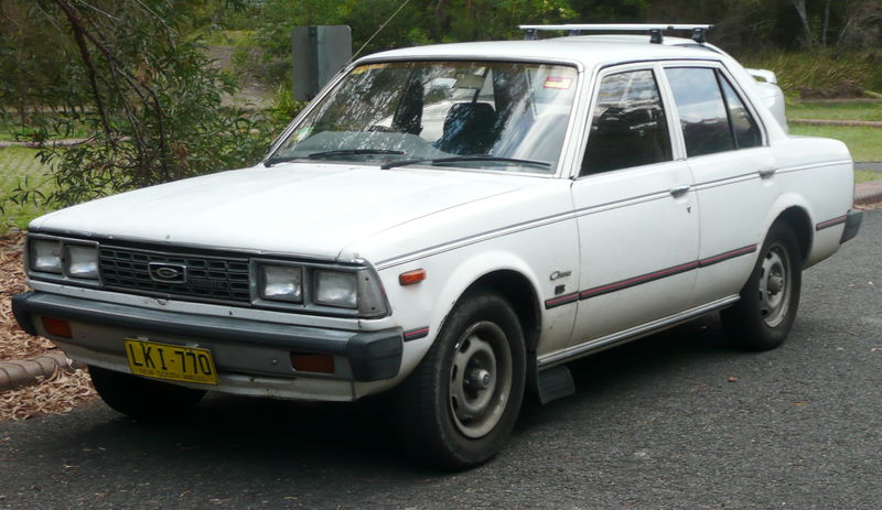

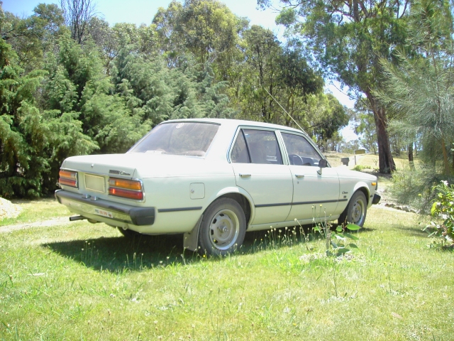

prosbo Posted October 23, 2010 Report Share Posted October 23, 2010 i just did this other weekend i got corona front bar and a ke55 rear bar $200 for both. rear bar sits nice just need to make a L bracket and use the welded in nuts on the rear. front bar had to cut like... err 1 inch or so off each side also cut that black strip down aswell it has bolts on the rear so u can take it off and make another L bracket and use the original bolt holes both sit really nice and super strong used like 5mm thick plate and welded it on. ill get some pictures of the bars if u wanna see. Cheers T Quote Link to comment Share on other sites More sharing options...

prosbo Posted October 24, 2010 Report Share Posted October 24, 2010 here ya go.. i wanna make a plate that bolts to the bottom rad support like the normal bumper so its abit stronger FRONT REAR unless fact- 1 inch of weld holds like.. 1 tonne cheers T Quote Link to comment Share on other sites More sharing options...
Spencer[RL] Posted October 24, 2010 Author Report Share Posted October 24, 2010 That looks really good! Quote Link to comment Share on other sites More sharing options...
