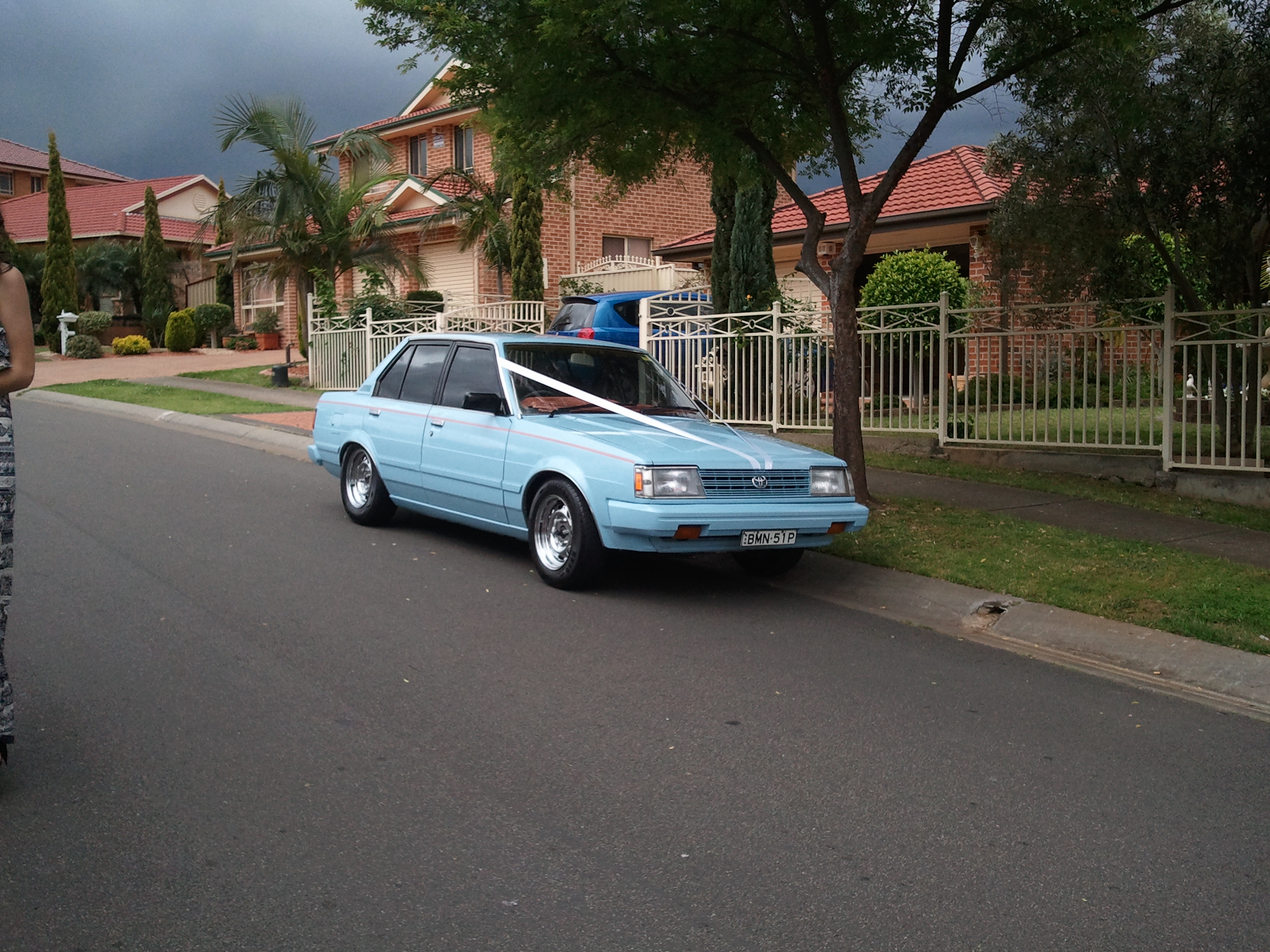

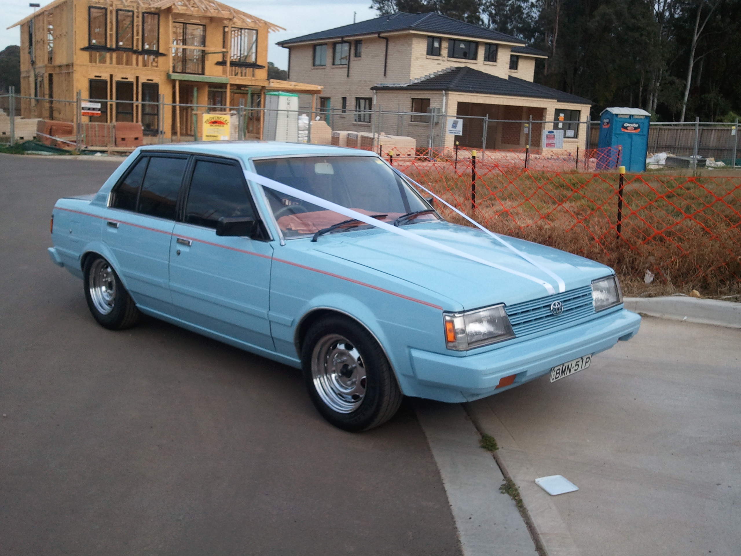

Started off as a stocka and ended up to this, any opinions how how to make this thing look better just throw them up
BODY: nice and stock fresh coat of paint with an orange pin strip to break it up
SUSPENSION:all stock except for a few ajps and-ons like camber tops,strut brace,and a nice fat front stabaliser!
RUNNING GEAR :drove it around for about a year with the standard 4k than had it removed to make way for the new 5k
the 5k was fully striped down after sitting in the shed for 5 years and had a full overhaul ,was ment to be a quik overhaul with a mild cam but blew out
to be fully worked
runs a knife edged crank, 4AGE pistons, 3k bigport head wich was heavily modified (enlarged valves heavier valve spings ported etc etc)changed to solid lifter set up, big cam
twin 40mm side draughts with extracors and a 2 1/2 inch exaust with a dumpy on the ass
runs a stock k50 with new clutch with standard diff

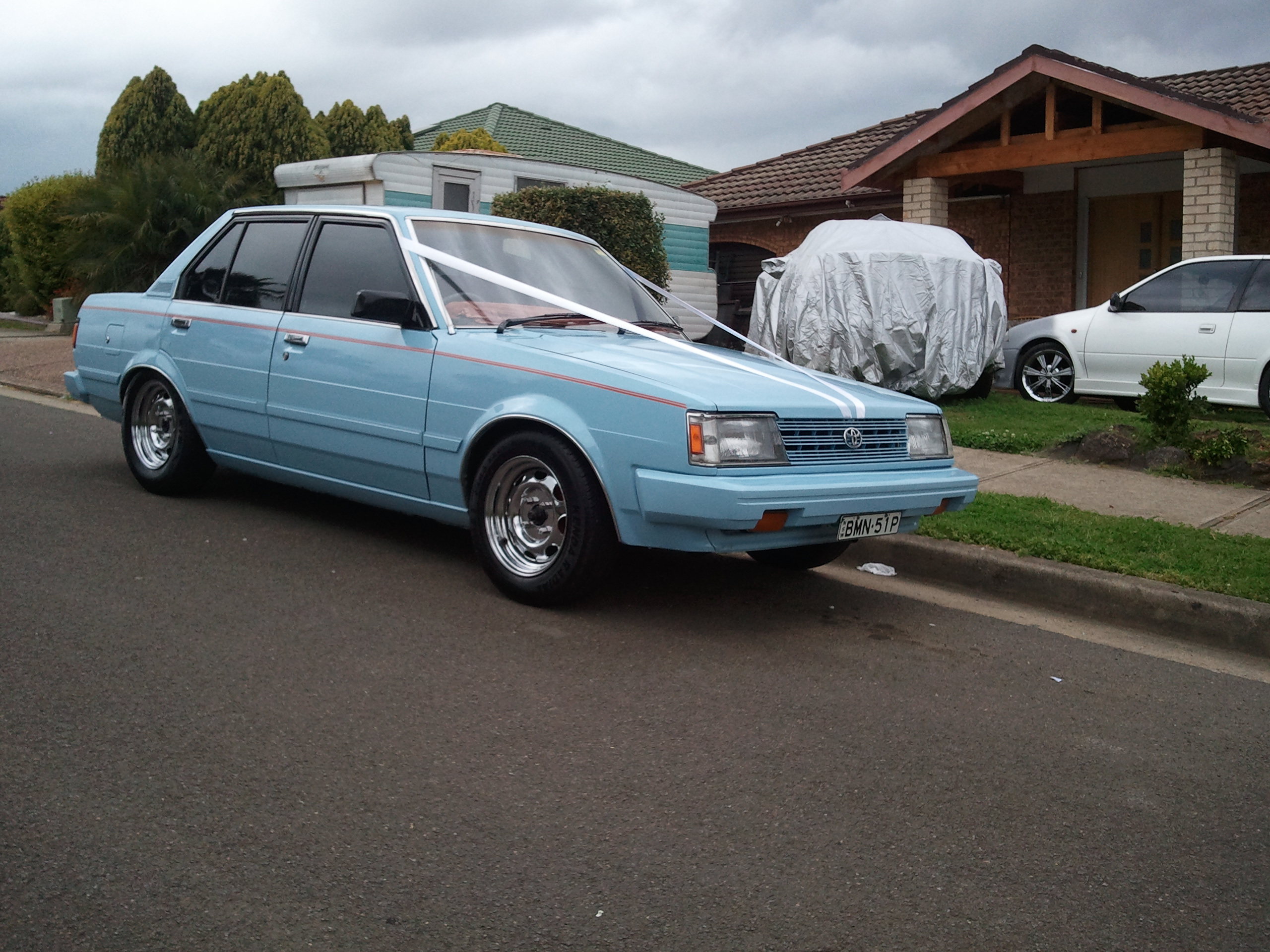

ROLLING ON:14" steelies wich i had widend and chromed to siut a ke30 i had a few years back but looks tuff on the 70!
(IF ANYONE KNOWS WHAT CAR THESE ARE OFF OR WHERE I CAN GET ANOTHER SET FROM GIVE ME A YELL!)

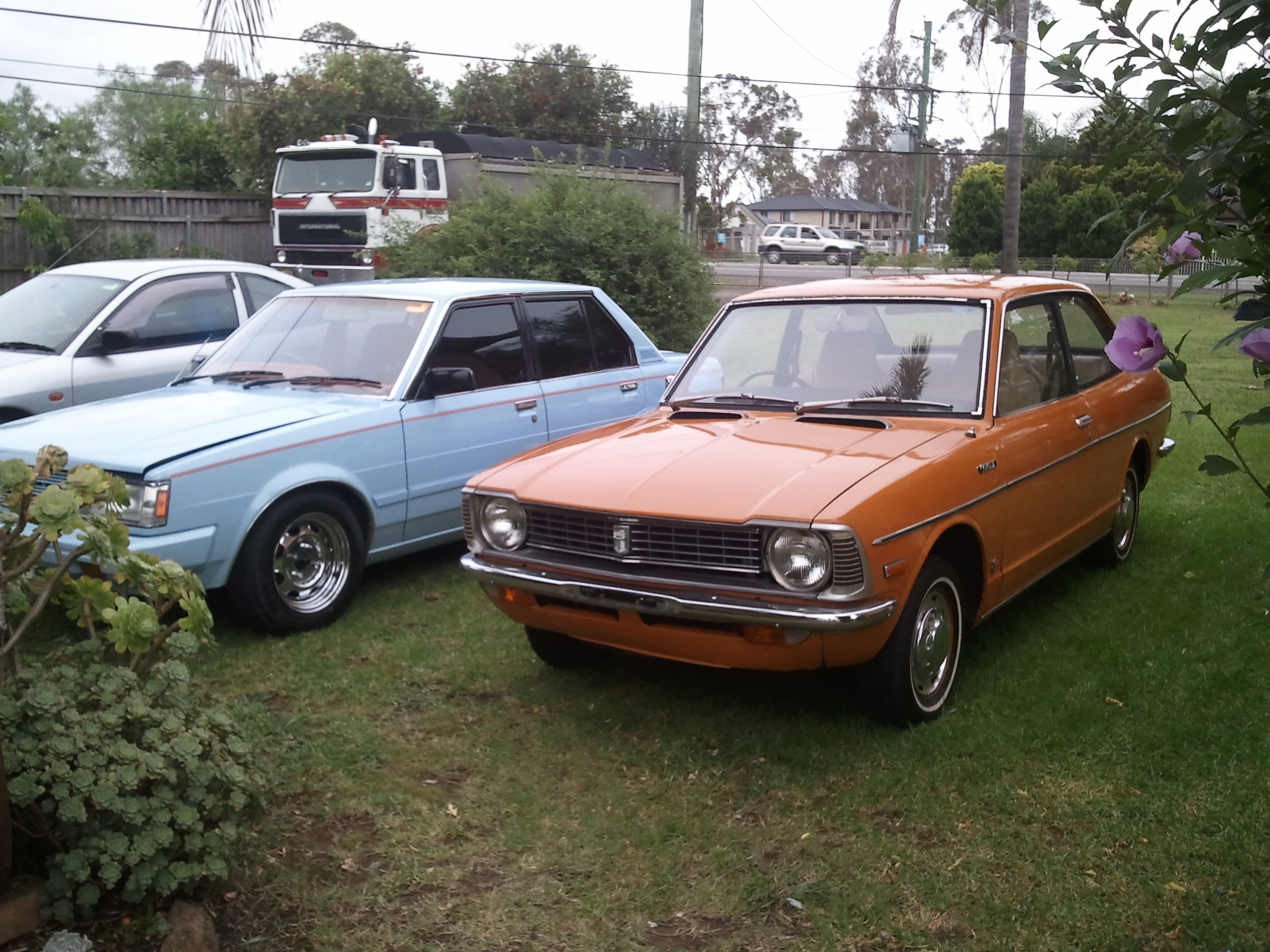

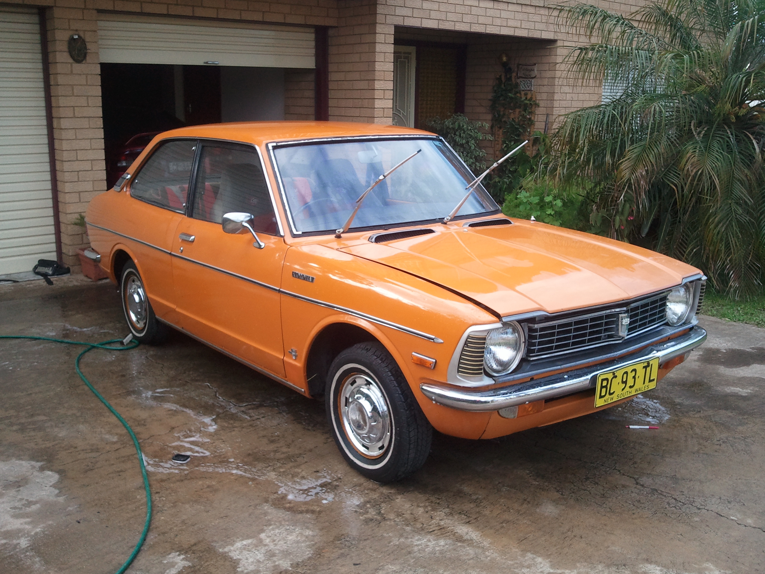

thought ill hit yous with a pick of the 20 soon to be biult
after i finish my 25 wich i will throw pics up soon enough

Like the ke70 a lot Brendan, looks very 80's in the pale blue with everything colour coded, good job well done! And that 20 looks very nice as well.
You say those chromed steelies are 14", they definetley have the Corolla ventilation holes :hmm: I will have a uess and say they might have come off a T-18 but in 14" diameter.
love the rims!
not sure about the colour coded bumpers and grill? :hmm: :hmm:
Cheers overrated had to try and make the original colour the best as I could , glad you like it!
yeah evan ive had quit a few people say the bars and grill look too much ive got a standard set, might give them a go and see what it looks like!
You can get 14" steel bands which are stepped down to take a center from a 13" wheel.
You know what maybe your right because they are steped
I had bought them from a garage sale they were painted gmh black I just got them widened and chromed
Trying to find centre caps is the hardest thing to find atm there either to big or to small in diametre!

My 20 front and rear seats are stuffed does any one know what they charge to re trim them back to original?
The 20 is up for sale or swaps
