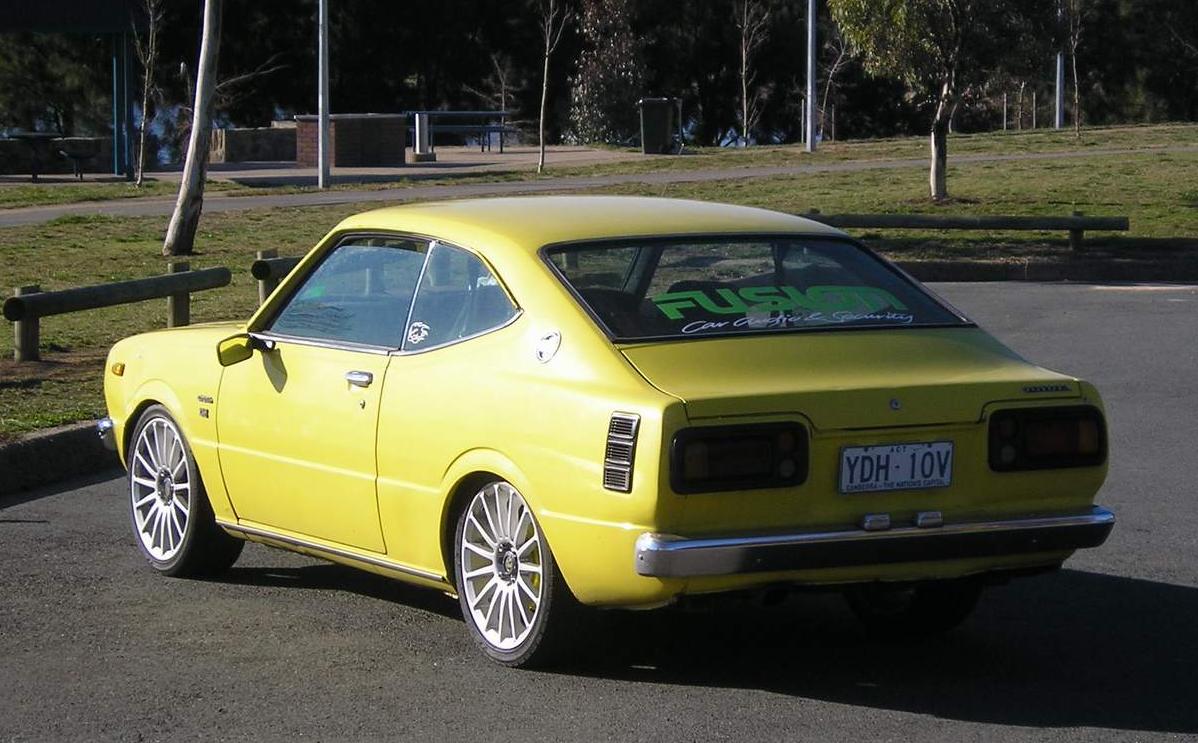

Miller's Finished Ke35
Agreed...blocks are bad
The tail lights are painted to original spec though, that is how they come.
VERY nice KE35 dude. Love the colour, stands out like crazy!
