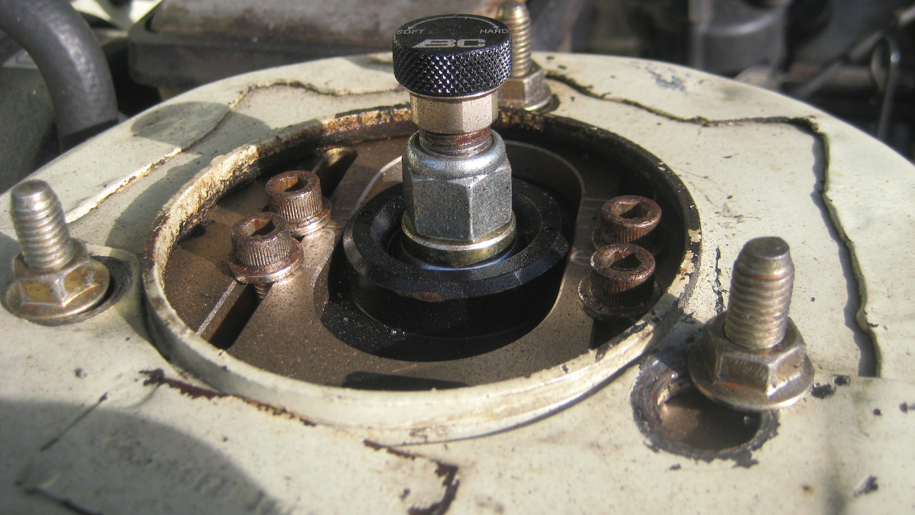

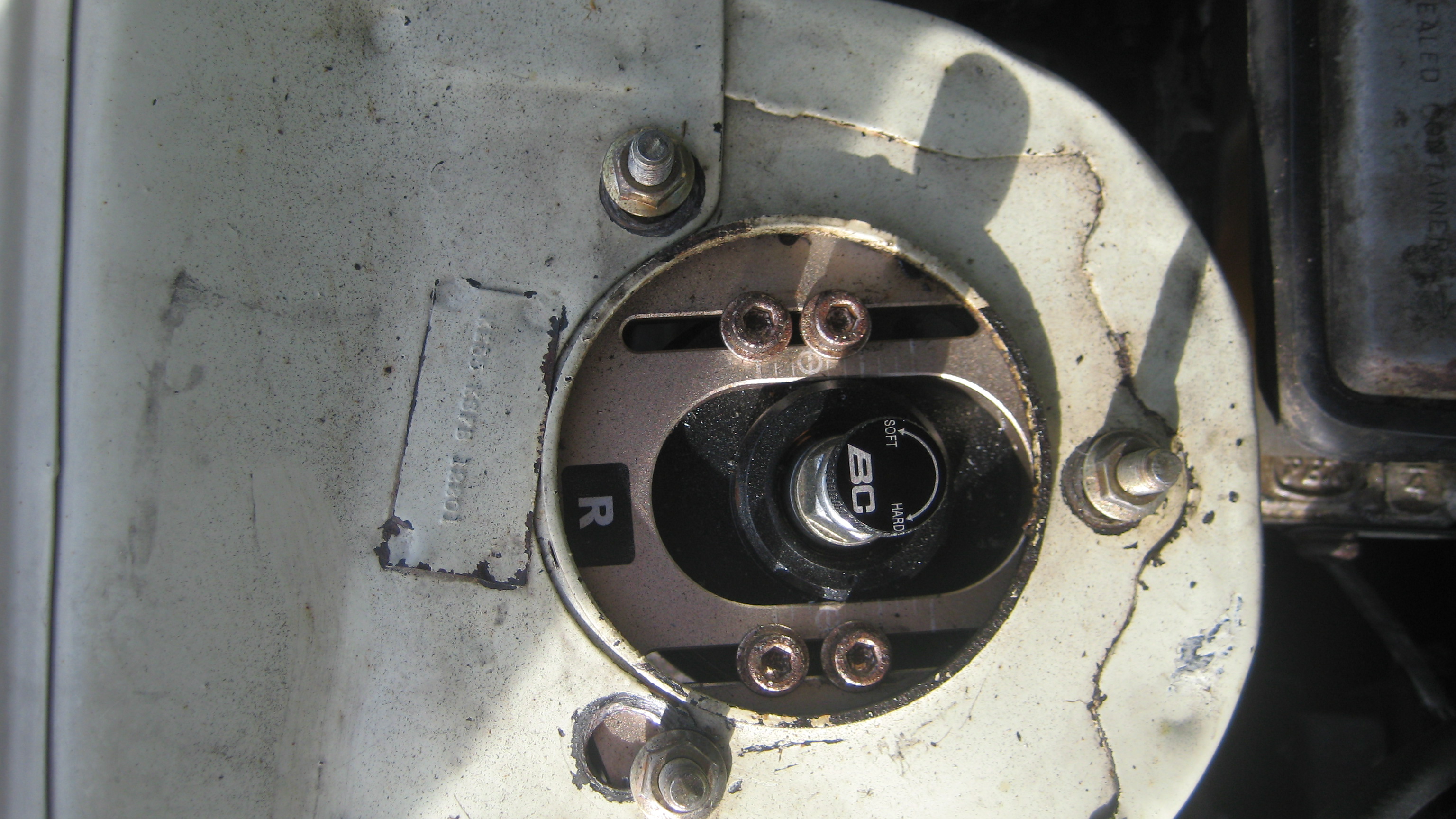

The coil overs bolted straight in with some minor fabrication. the strut tower top needed to be re-drilled for the new paturn, this consisted of a 10mm hole to be drilled directly to the center of the car on the most forward hole (5mm over). not the perfect fix but it is working well and can be aided with a strut tower brace. No master cylinder upgrade was needed.

Well i have the camber tops approximatively 2/3 of the way to full negative camber and I'm running 2.3 degrees at the front wheels. More than enough if your after that 'look' without compromising with uneven tire wear.

Exactly! they bolt straight into your original components apart from the re-drill of the one hole in the strut tower. Large washers Would be advisable as the bolts are not as thick as the 55's on the camber top. Alternatively a strut brace would sure everything up.

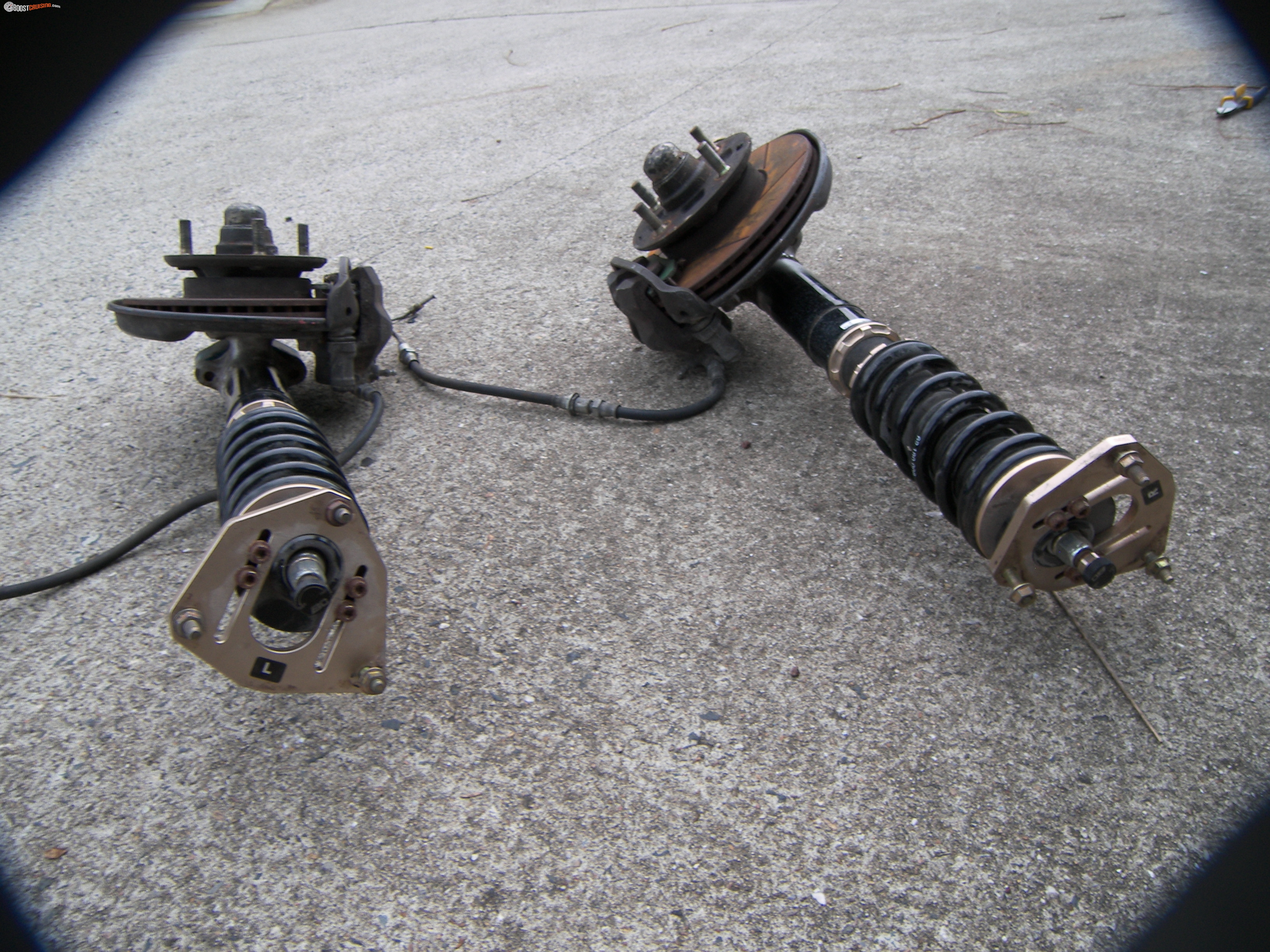

Ill Get some photo's now and chuck them up for you as reference.
