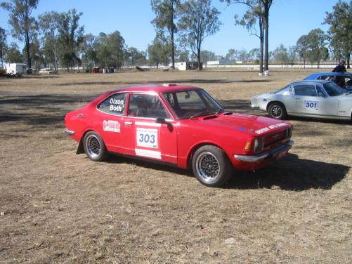

Got a question that I hope might get a response before I head back to the suspension place tomorrow. Got my leafs reset yesterday, was in a mad rush when I picked it up and just jumped in the car and left. After the mess around that caused my rush I inspected the job that was done. The reason I got my leafs reset was because they were flat. I had specified to have the leafs reset, extra leaf for stiffness and a half rebound leaf to deal with tramp. I asked for the height to match the front, and figured that would be pretty self explanatory. My question is why would you ever have the front height higher than the rear? is this a better set up or is it normal/better to always have the ride height the same at the front and at the rear?
edit: after staring at the image for a while now i'm wondering if the wheel arches are actually different front to back, never noticed it before and not sure if i'm just seeing things.
post-91-0-34301900-1309385433_thumb.jpg old pic from a few years ago
post-91-0-52459800-1309385442_thumb.jpg pic taken today

My tarmac setup was about 20mm lower at the back than the front. No real reason, that's just how it ended up. Drove like a gokart.
I'm fiding it really hard to see in that picture what is wrong. It's sitting Maybe (maybe....) 10 mm lower at the rear. I think it looks fine.

though measure from the jacking sil to the ground at both ends, maybe the front guards are bigger so it just appears to be higher...
Yup. Measure the sills. It actually looks pretty flat to me, but it might be the picture. Don't go by the wheel arch height, as the front is always bigger than the rear as Dave said.
Looking at the sill... it looks pretty flat....
front guard opening is definitely bigger than the rear.
yep re-measured and it looks to be spot on. Made the mistake of looking at it as individuals as opposed to as a whole. Reminds me that i shouldnt make judgements at 4:30am before I go to work. What threw me was looking at pics of a mates ke25 which is obviously higher than mine as he has a gap between the tyre wall and the wheel arch on the front and back while i only have a gap between the front wheel arch and the tyre.
