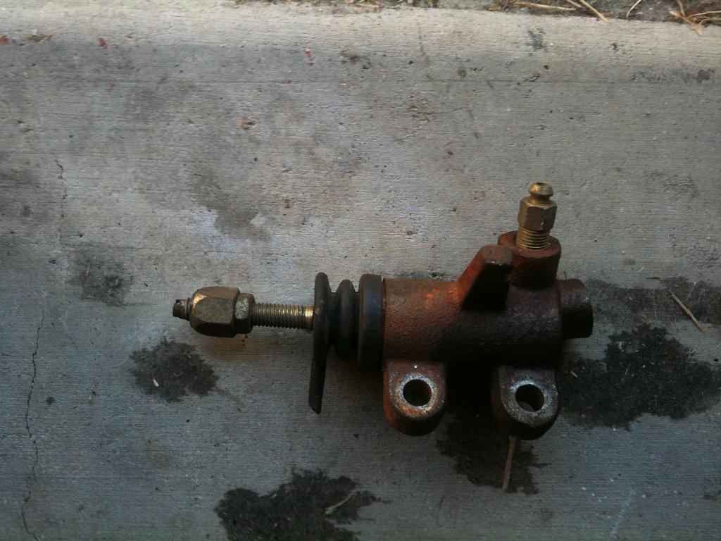

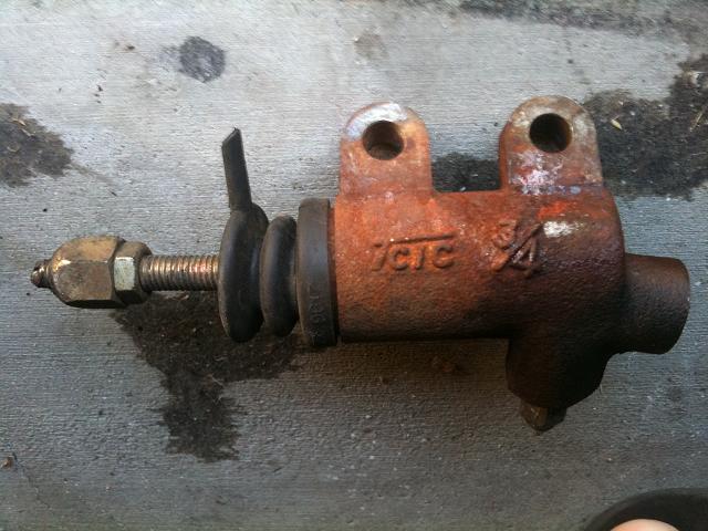

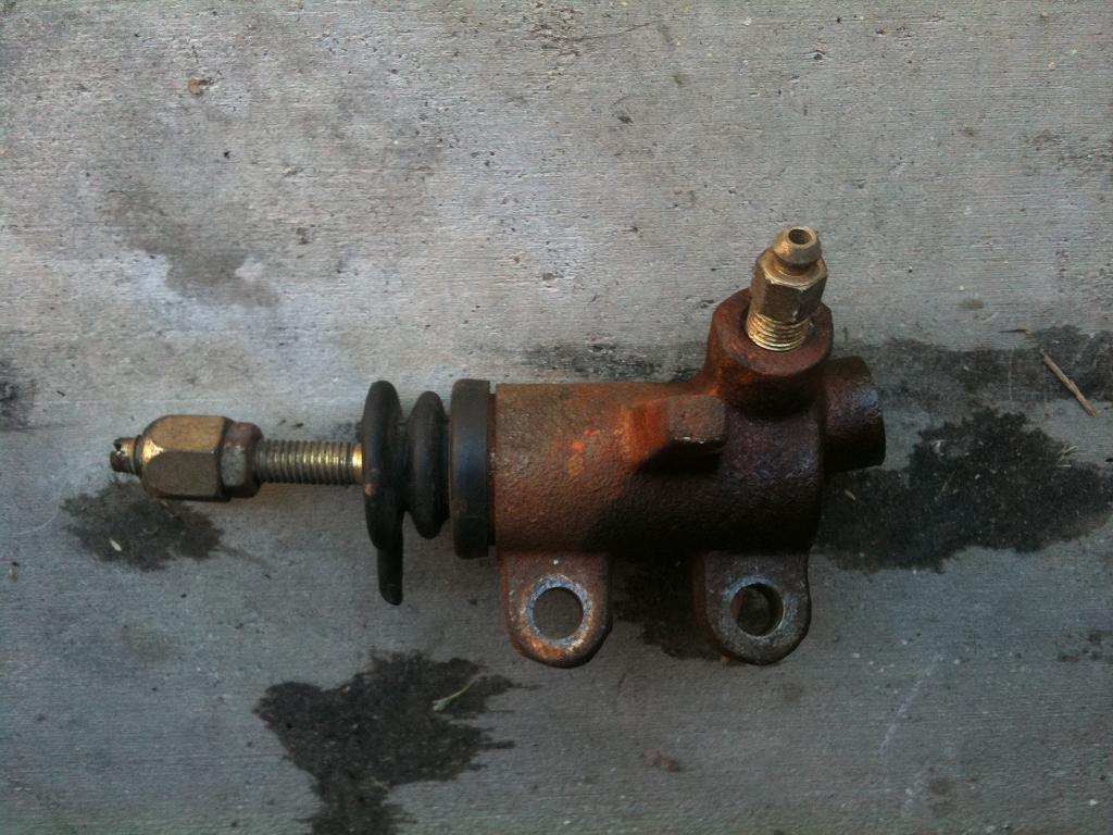

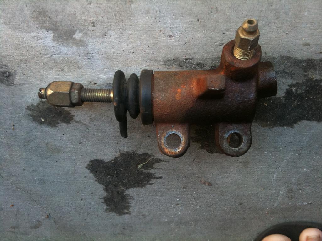

  1. Found it, it's a JB4058 19.05mm Bore Anyone happen to know of a direct replacement that has a larger bore size? doubtful but worth a shot.
  2. Hi All, Wondering if anyone can confirm if the picture below contains a ae86 clutch slave cylinder. It's for my ke25 which has a w57 gearbox with a t50 to w5x bellhousing. I know its not a w57 slave cylinder as the one i bought is apparently for a MA61 and it doesnt fit. So if someone could confirm or deny or identify what clutch slave cylinder this actually is that would be great. The only identifying marks on it are....tcic 3/4 9617. Cheers
