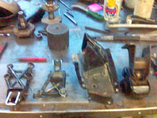

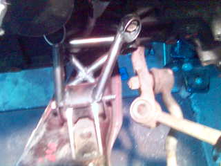

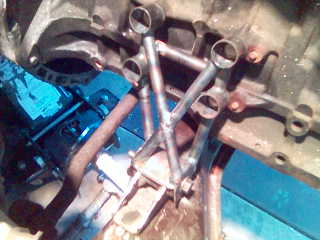

Attached are some pics (low quality phone pics) of the new engine mounts i have just made for it and a pic of the car in action (at winton with my old 13T pushrod engine).

Ok guys now that i have a bit more time ill go into a bit more detail of the project, as you allready now I'm converting a 3SGE to rwd, the engine is a gen2 engine that i got from central vic auto parts a few years back (i worked for andrew for 6 1/2 years!), the criteria that i am working to is that everything has to be light yet strong enough to perform without failure, and to be the best possible package for a circuit aplication at a realistic cost!
So far youve seen the pics of the engine mounts, there weight is very impressive weighing in at just under 1kg total per side, now if anyone has ever weighed the standard toyota engine brackets/mount/cross member brackets in a corolla or most toyotas will realise that they are quiet heavy, after weighing the standard units you would normally use in this conversion (ST141 brakets & mounts) i have saves a total weight of about 2.5 kgs per side, thats 5kgs overall . and are still rubber mounted!
Ive also leaned the engine to the passenger side slightly to try to improve some weight distribution (& also gives a little more clearance for the intake from the clutch cyl) and the engine is mounted as low and far back as possible (this meant modifying the back of the cyl head) which we will get to at a later date.

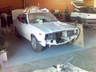

1- current state of corolla
2- engine mount comparison to standard assemblies.
