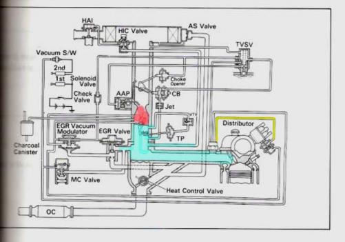

tannerdanger Posted September 19, 2011 Author Report Posted September 19, 2011 OK, so it may not be filling the bowl with fuel and flooding it. There might be a vacuum control of the idle via some vac solenoid you've blocked, or a leak in one of the vac lines that is leaning it out. Is there a vac diaphram on the throttle arm or idle screw pivot?? Hopefully someone on here will be a 4AC expert. well I watched a few videos by 84hachi on youtube who explained that the only vacuum line you need is to the distributor. I think the diaphragm is on the other side of the carb from the throttle arm and idle screw pivot. http://www.toymods.org.au/forums/tech-conversions/52512-4a-c-engine-manual-need-tappet-clearance-specs.html#post1075357 here is a post that shows the stock vacuum lines. we have everything either removed or plugged except for one going to the distributor from the TVSV. Quote
altezzaclub Posted September 19, 2011 Report Posted September 19, 2011 (edited) So the TVSV is the temperature vacuum switching valve that runs the EGR system. It might be varying the vacuum with temperature, depending on which port you used, or it might not be working at all if the other lines are blocked. I think you should use the one shown in yellow, straight from the manifold for manifold vac. Those that are shown in blue are all under the same vac, so any line into there would do. It doesn't seem to have a ported vac, the throttle plate doesn't shut off any line at idle. The red area is in a venturi so it has vac that is proportional to air velocity, not what you want for vac advance. It would be interesting if you connected up the other line on the dizzy vac while you had a timing light on it and found out if it gave vac advance or vac retarding... Edited September 19, 2011 by altezzaclub Quote
