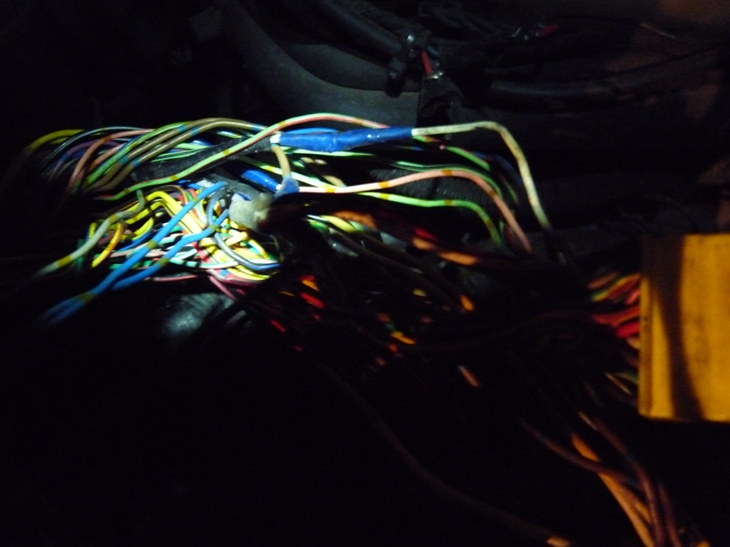

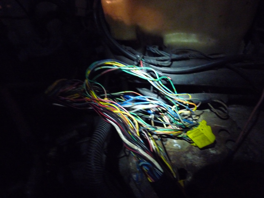

Thinking the problem was just a simple(?) engine loom swap, I pulled the loom out of the parts car and I was going to plug it upto my engine, connect the ECU and job done.
However! my engine has a lot more stuff connected then the parts car did, and when I was sitting in my engine bay tonight, it didn't feel right pulling the loom out.
After closer inspection of the loom that's in the GP, it looks like the #&*@ stupid &@$!% mechanic did splice it, but I have no idea what he did, however I do have a 4EFTE and 3ETE loom diagram so I could work it out.
Would you:
a), Attempt to splice the current loom yourself to accommodate the 4EFTE ECU, or
b), Unplug the current spliced 3ETE loom and replug the 4EFTE loom.

That's a real noodle scratcher...if it were me, I'd have a crack at splicing the 4efte ecu into your 3ete loom. If you can identify which wire goes to what & there's enough pinouts for the essentials plus the extra stuff your current engine has (a/c, p/s etc?) you should not only be able to get it in & running, but possibly even correct some of the previous electrical work while your're at it. :)
At first I thought to just put the 4efte loom in, as the ecu will work with it. Then I wondered how complicated it would be to integrate the extras you have into the loom. Not being an electrical guru, I'd say possibly very!
Good luck with whichever path you take!

man take everything out of the parts car body loom aswell and put it in urs ditch the crappy wiring job start with a working setup that way u wont be scratching ur head if something doesnt work
that is if the parts car started and ran no dramas.
Parts car had some dodgy wiring, but I think that was more the iginition, I'll do a test fit tonight of the parts car loom - click here for progress :(
+1 for changing the whole loom, at least then you know what you have and not going to be chasing problems around the engine harness.
