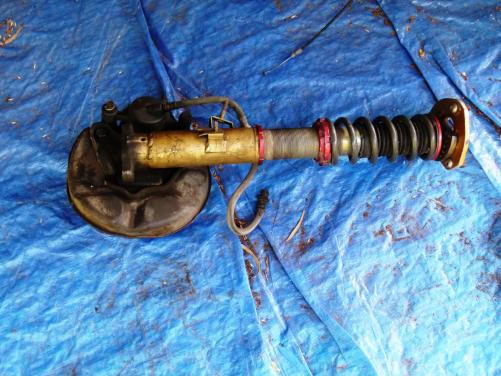

Man, I wouldn't be using anything other than ae86 gear for the front end, I mean, for a relatively stock BT 20v, a wilwood big brake kit for ae86 would be more than enough stopping power. I should think anyway. And should be an easy fit.
S13 etc gear will fit with some modifications but will never end up being as effective as ae86 gear.

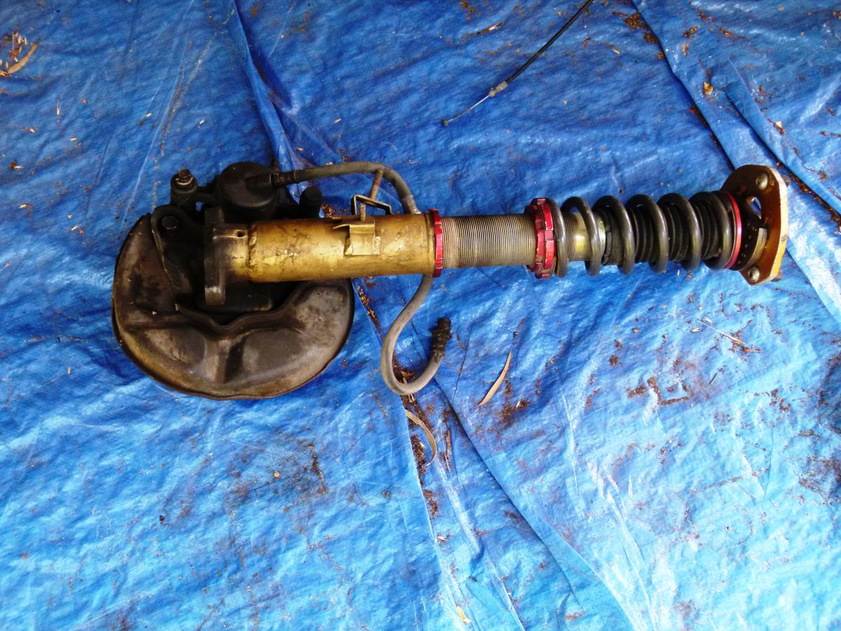

Yeah, just buy brand new AE86 coilovers. BC make them, HSD make them. Heaps of other brands out there too, all making them brand new. But if they're for an S13 or FC, there's no way I would be buying them.
Your car though, if that's what you want to do, go for it. :)
Yeah your right...ae86 coilovers all the way.....i'll check willwoods big brake kits specs as well....just gotta find the coins to make it happen...bizzness is slowww these days man...
AE86 just works well. Wilwood aren't the only people that make brake kits...There are others out there. I'm only throwing suggestions out there, man.

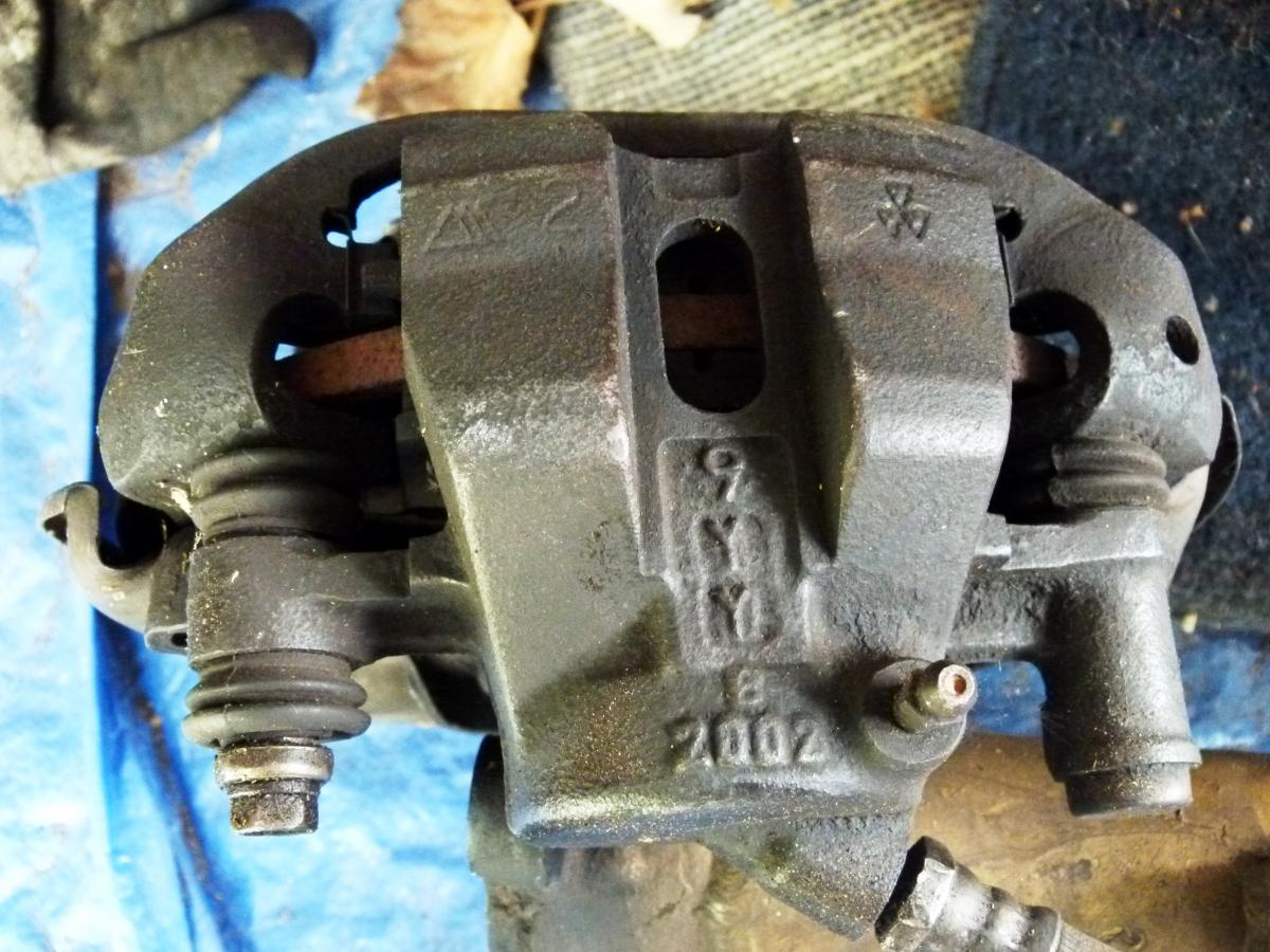

I might work on removing the calipers tomorrow and do bit of an overhaul.
Hey guys what do you of my front coilovers and calipers, i probaly just use them instead of getting new ones, and save some coin.

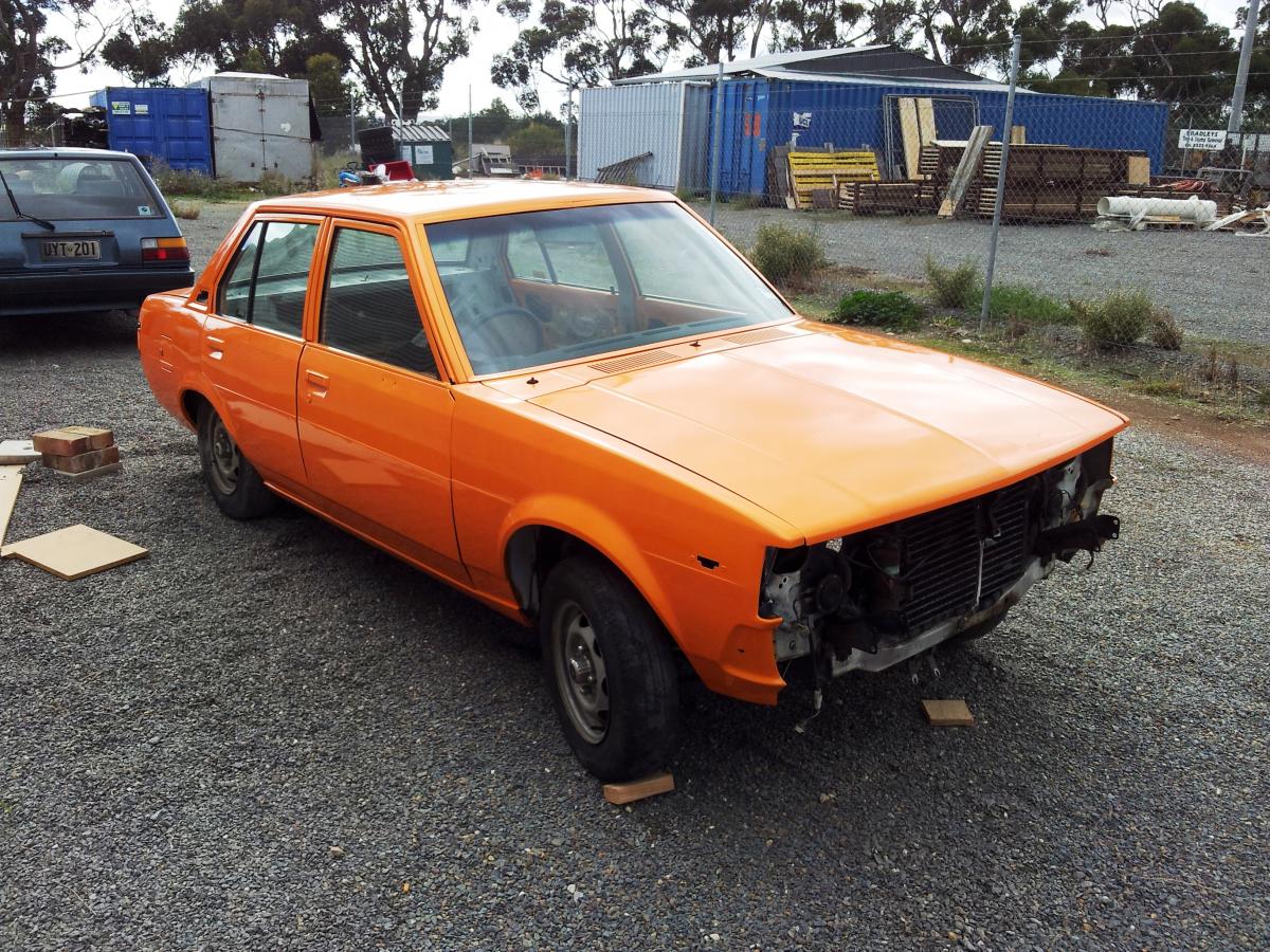

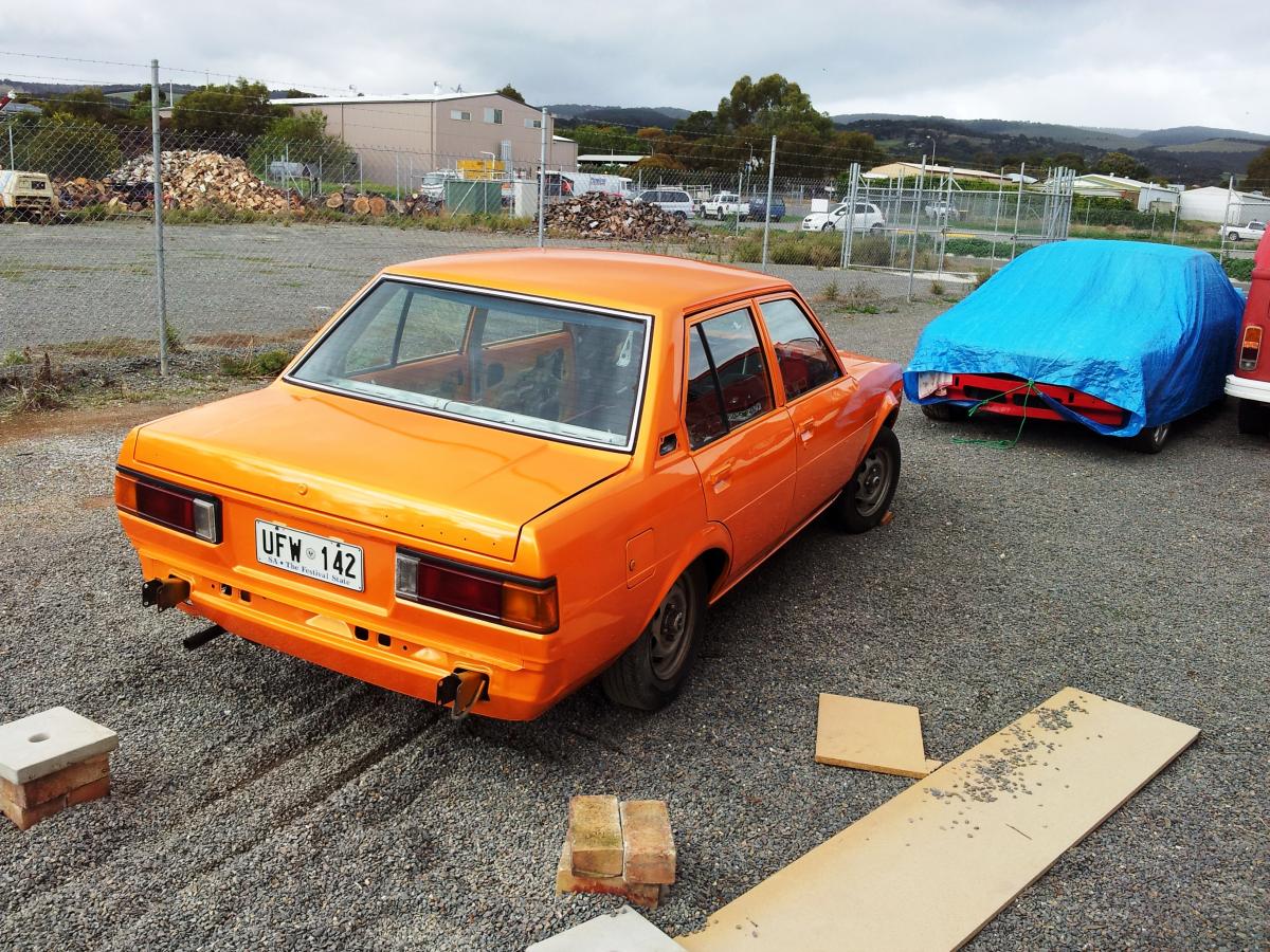

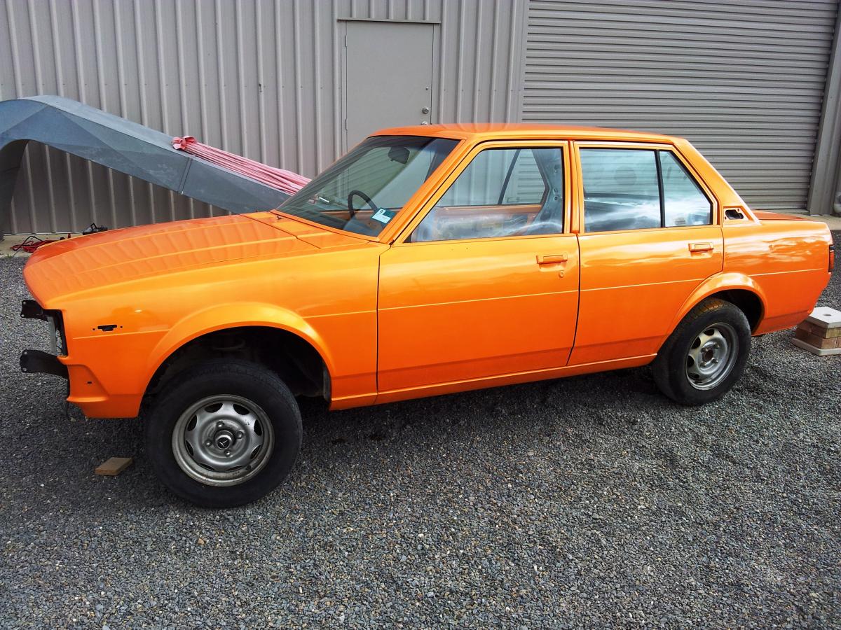

I'm picking the car up from the bodyshop..........paint and body is doooonnnnneeeee
Time to work on the rest of the car....
Just waiting for my parts still........like the coils, dizzy blanking plate, coil adaptor plate, all coming from SQ-Engineering, then braided hoses, ...and a bunch of other things
I'll post some pic when the car is at my place

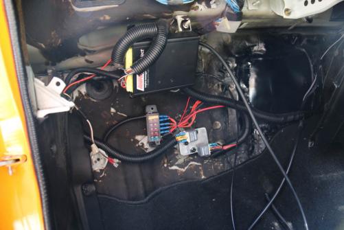

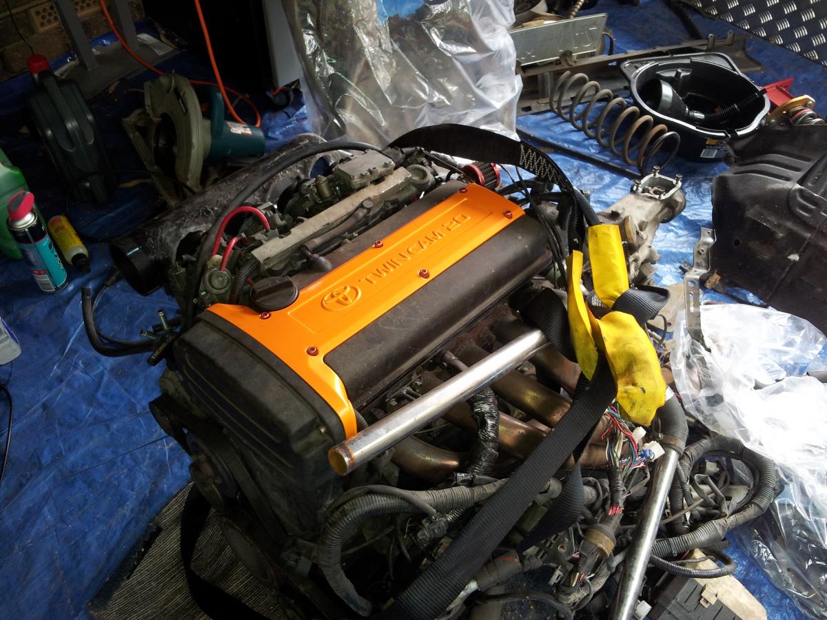

Here are some pics
This is the engine without the stacks installed and other bits, but since I will be doing a COP setup, that valve cover won't be used, it will be replaced by something else,

It costs around $3000....considering they also painted the interior trims...which used to be blue
Plus we still have other stuff to be painted...like the trumpets, lips of the wheels...

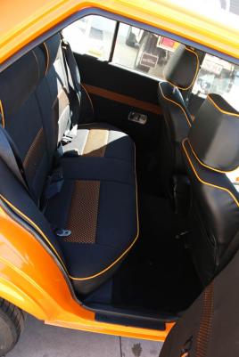

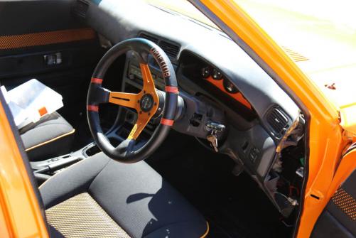

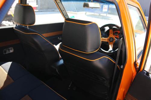

And my seats are done today....I will lay some pics later.......so you guys check out my design...hehe
