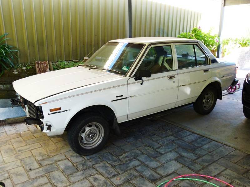

Just acquired this ke70 from a co-worker, he sold it to at a pretty cheap price.

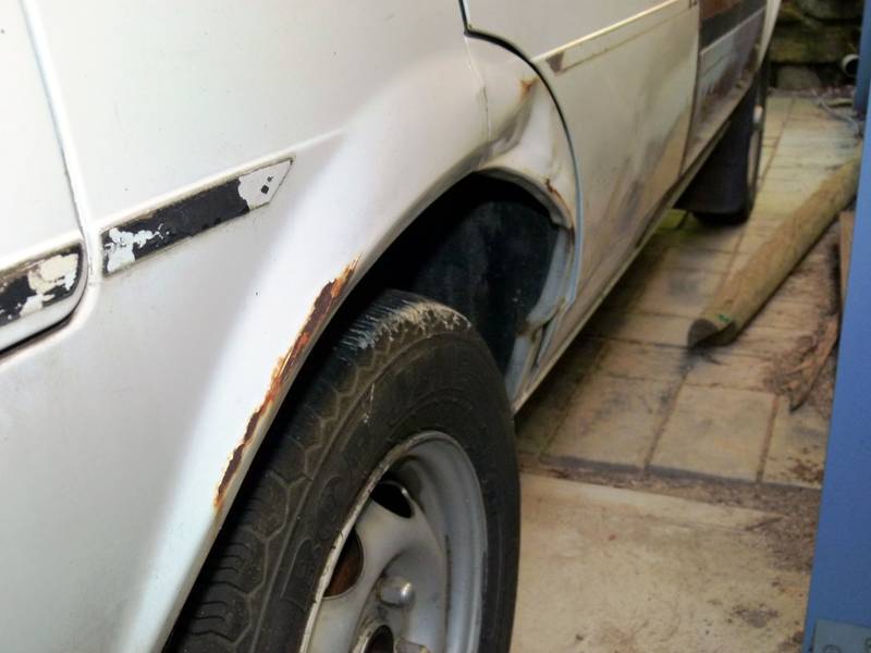

It does need shitloads of work, some body work needs doing, it's got a fawkin transplanted driver's door with different color.
Smells like a sewer inside, but the engine runs good.

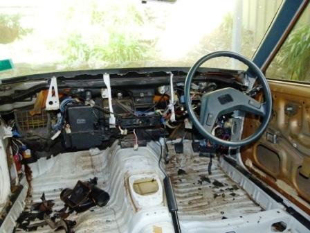

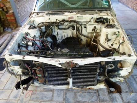

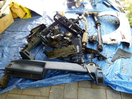

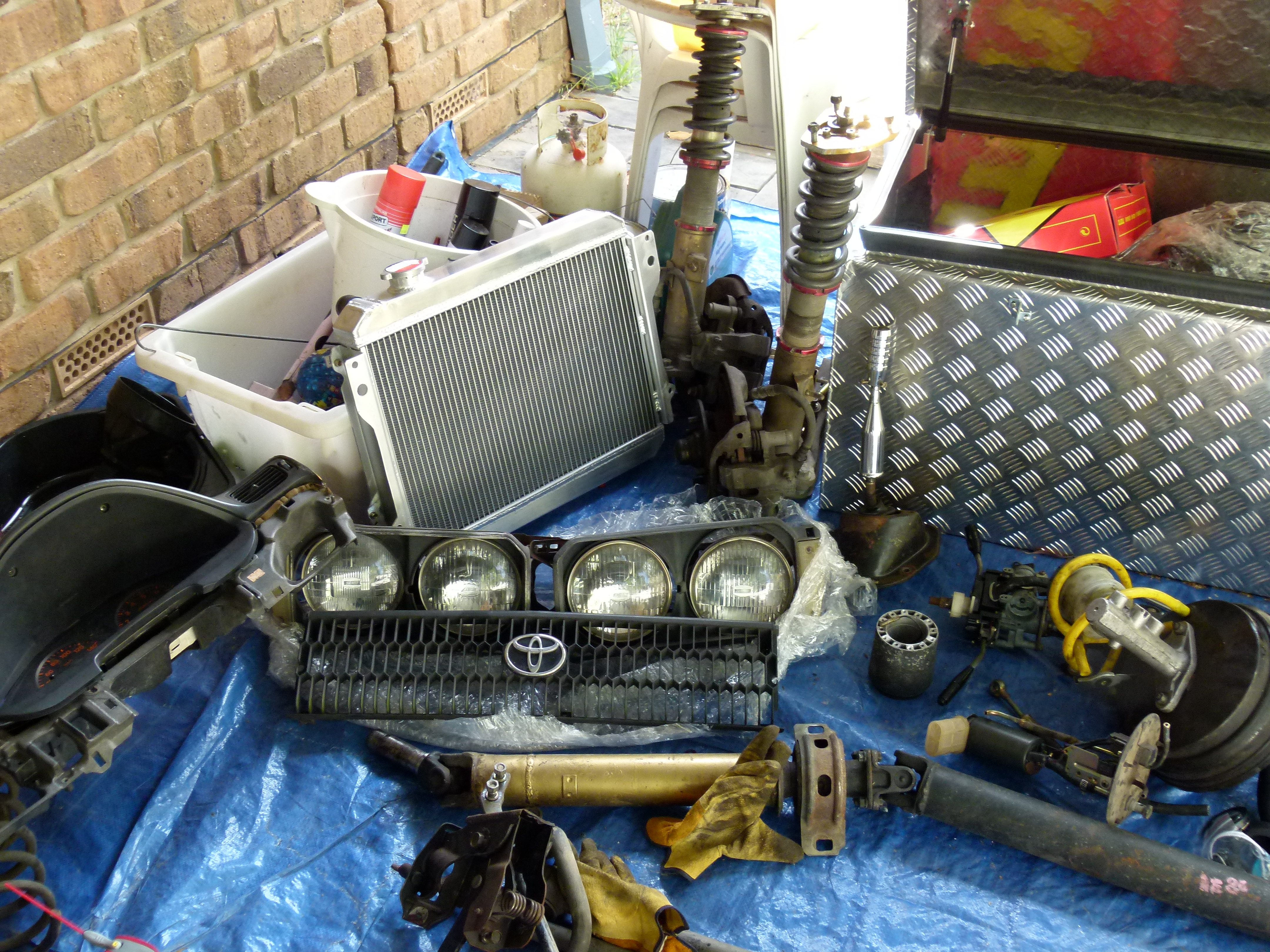

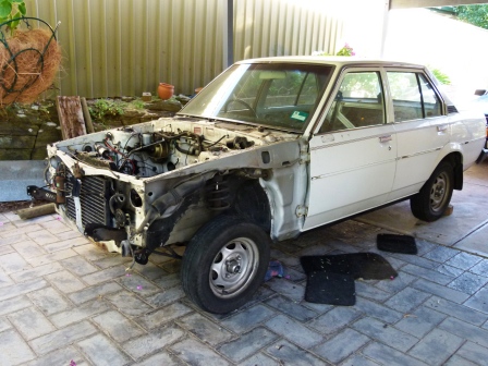

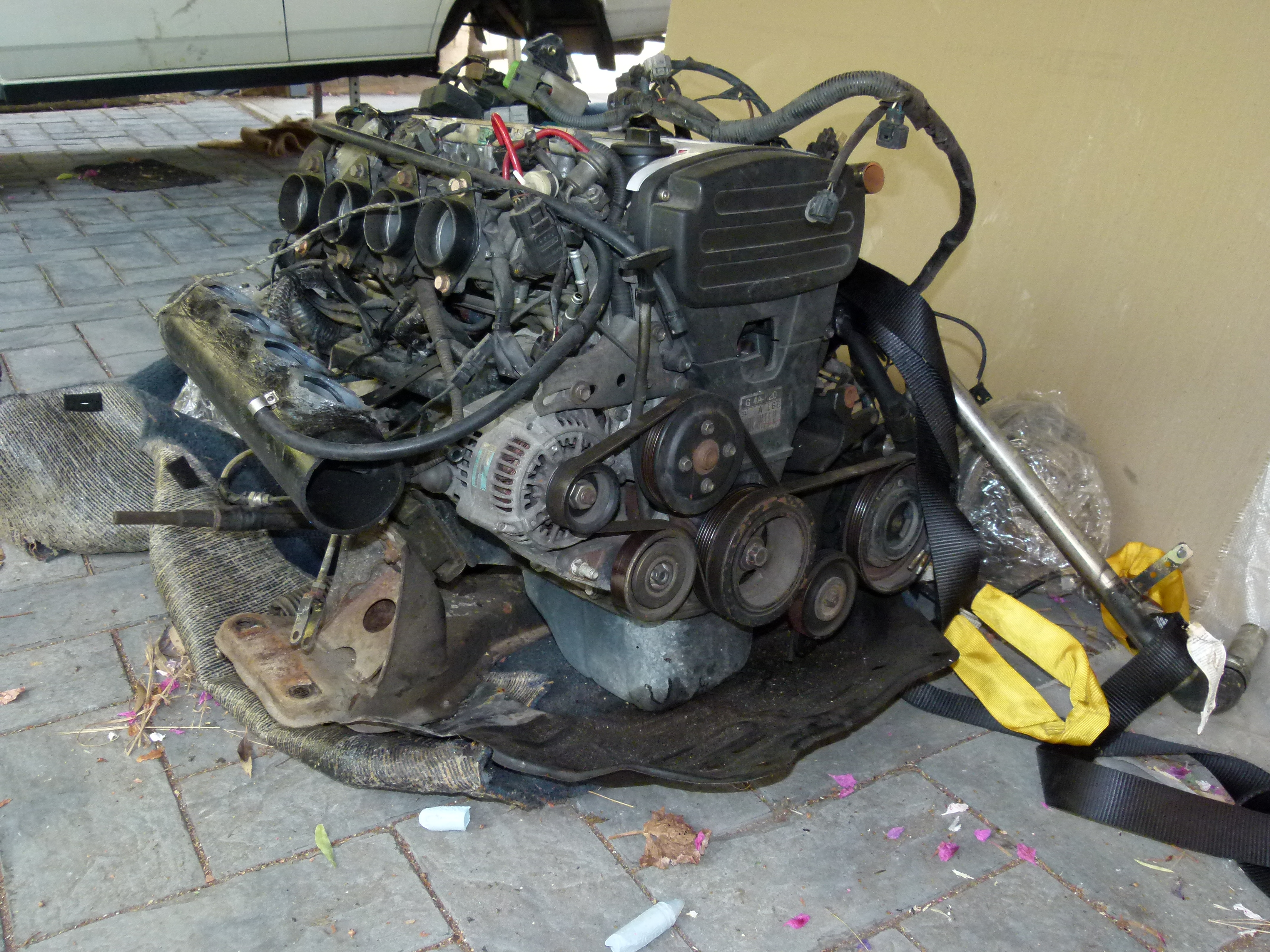

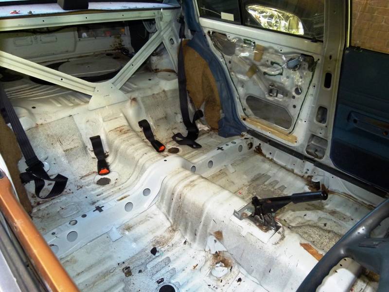

Below are the pics of the car, its practically stipped down already, and sold most of the parts like engine, trana..etc

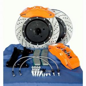

Brake kit with orange 4pot calipers, with 289mm rotors, ....my main prob is the rotor shield I have...too small

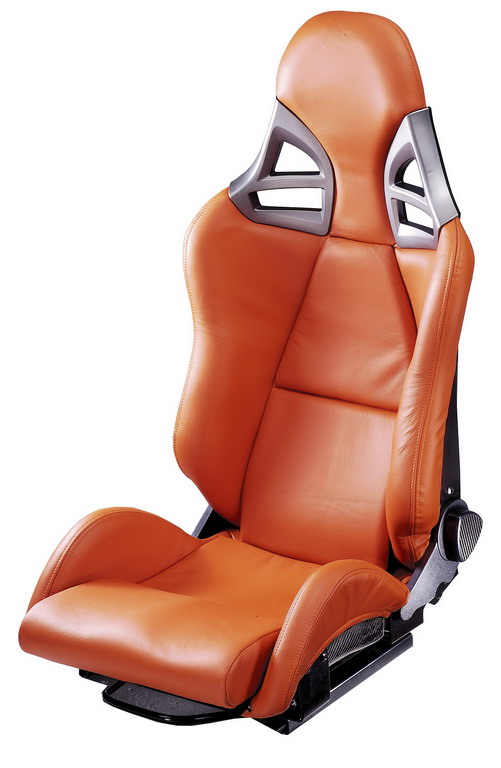

Seats....just gonna make it fit with some minor fabrications

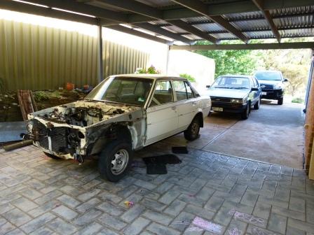

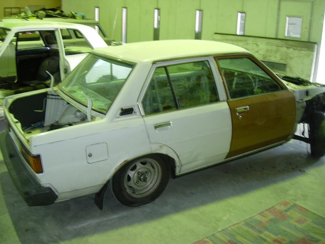

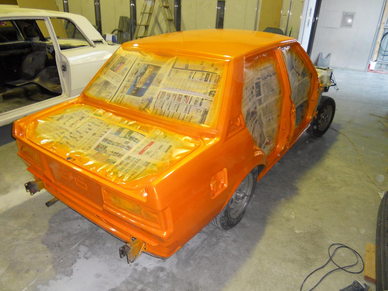

I have some pics from the body shop, the panel beater takes forever to finish the car.
The car is at Aldinga, getting the body work and paint done, then it goes back to my place for me to put it together with a help of some people.

How long has it been there?
Dude a long fawking time......the guy doing the bodywork and paintjob takes his time, I should hope to get the car by next week....i hope

Plus the seats i an ordering from China is giving me issues....not wide enough for the rails, means I have to drill a couple of holes, I guess that's what you get when you want custom stuff
