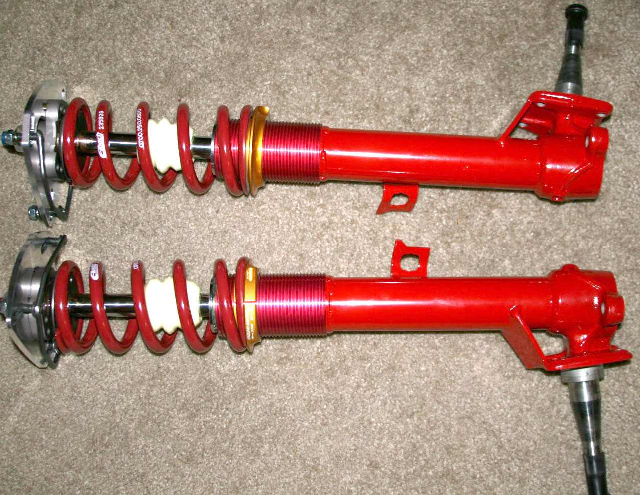

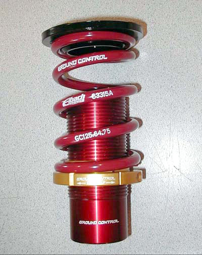

altezzaclub Posted November 10, 2011 Report Share Posted November 10, 2011 OK, you can buy the whole strut with adjustable height and adjustable camber tops, or you can buy the sleeve that you weld onto the outside of the strut to give you adjustable ride height & get the camber tops separately. This is what they look like- Quote Link to comment Share on other sites More sharing options...

snot35 Posted November 10, 2011 Report Share Posted November 10, 2011 Where is that strut photo from Altezza? They look like TE72 struts. I'm curious about brake options for that strut type... :) Quote Link to comment Share on other sites More sharing options...
ke70dave Posted November 10, 2011 Report Share Posted November 10, 2011 (edited) hey dude, yeah pretty much the ae86 front end is exactly the same as ke70 front end, just with a few (but important) variations in dimensions. yeah the strut (that the shock sits in) has the stub axel attached at the bottom, and your hub sits on this. also the caliper brackets bolt to this. that ebay link looks a little dodgy, looks like he is just offering his services to build coilvoers for any of those cars, those coilvoers in the pic look like ae92 possibly, def not ae86. that photo of the red shock/spring coilover thing that altezza posted, thats what you want to achieve. that has an extra bit on it, that bracket that goes from the tube to the stub axel, dunno how much good that would do, but hey might as well weld it on if you got spare steel. ae86 coilovers looks pretty much like a standard strut, with the spring seat cut off, and the thread thing welded on the outside...cuase that is what they generally are! sleeves are the way to go (if you feel you absoluately need height adjustment), if you can weld, or just find someone who is selling a pair of them, with say stuffed shocks (i got mine like this for $250!) bought some new shocks, and were good as new. any more Q's don't hesitate to ask! Edited November 10, 2011 by ke70dave Quote Link to comment Share on other sites More sharing options...
altezzaclub Posted November 10, 2011 Report Share Posted November 10, 2011 Where is that strut photo from Altezza? err... Google images- probably never see it again! Quote Link to comment Share on other sites More sharing options...
altezzaclub Posted November 10, 2011 Report Share Posted November 10, 2011 Consider your engineering options with coil-overs and sleeves. Find out if you need to have adjustable-height suspension engineered, then what it will cost to heve that done. Nearly everyone buys flash coilovers to get the adjustable height, then sets them and never moves them. The option is a shorter spring on the XT Corona or AE86 strut. The adjustable camber at the top is a great option to chase too. Quote Link to comment Share on other sites More sharing options...
