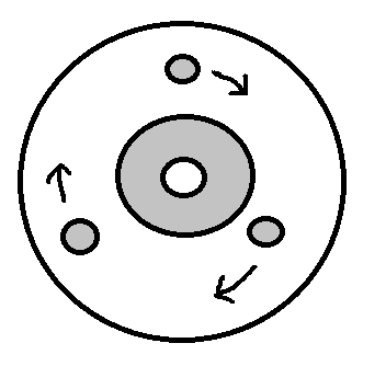

EDIT: Do your strut top bolt up the same way as a 70/86? Hole position that is?

Sorry bro yeah, just making sure the strut top bolt orientation is the same as a 70/86 if you get what I mean. They could be the same distance apart but if the bolt holes are rotated by even 5mm it probably wont work.
If ya get what mean
ohhh now i get it. Should be sweet as it runs through the old 55 holes with the inner most bolt bored out to suit.
