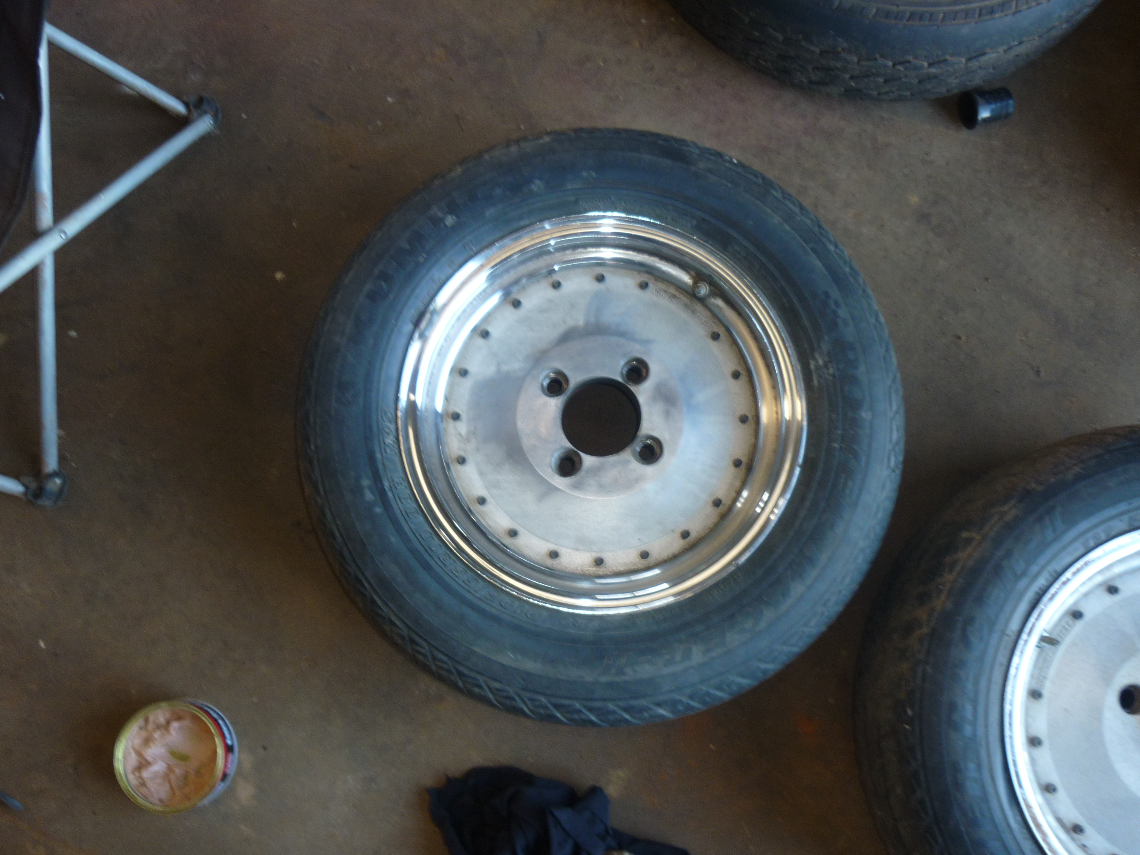

try starting around 500. if the rust is so bad that that doesn't help, sandblast then try again.
If theyre alloy, youll want to start off with an alloy cleaner, and scrub hard with some dishwasher brushes. then try 1200+.

I painted my wheels in a plain silver from supercheap auto. I used 240, then 600 grit sand paper to rough up the wheels, then lightly with 800 to get it all smooth. Then applied 3 coats of paint, lightly ;). Clear coat them will be alot better!

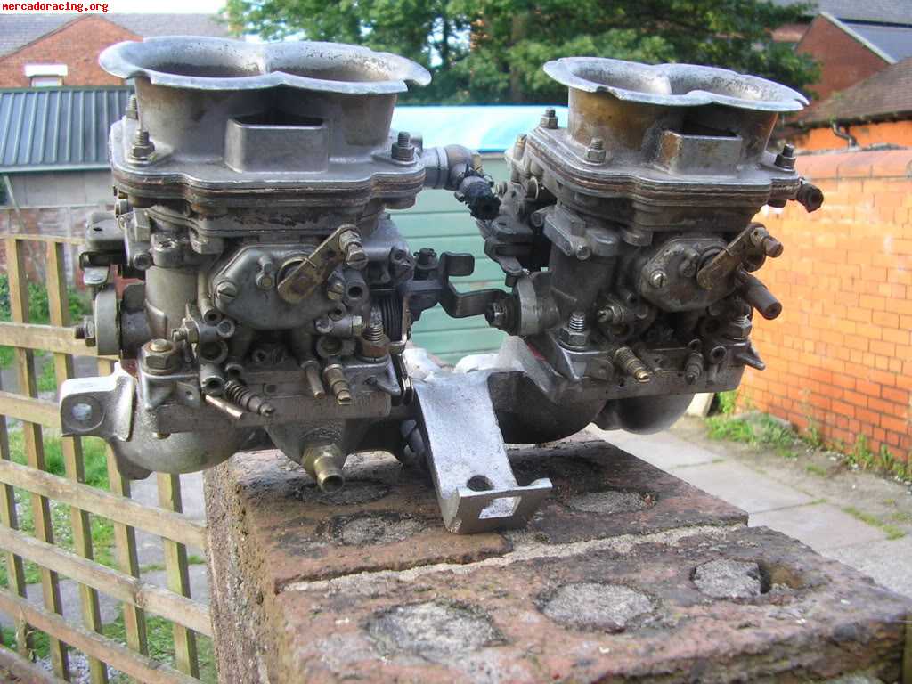

was ment to work on it this w/e but went out instead, looking at buying a brand new Weber and he only wants 120 for it, it is a Weber 36DCNVA?/ has anyone used this type before I'm guessing i can use it because people run them on there dattos and escort etc?!?!!??!!?!?!?!?
one of the main differences between them, is the choke setup from memory?
plus the venturi size on the dcnva were both 36 and opened at the same time, unlike the others, that have a smaller primary, and a slightly larger secondary circuit.
meaning, that you are opening both throats at the same time with the dcnva.
correct me if I'm wrong guys?
i personally don't like them and would suggest you wait for a 32/36 to pop up for sale, with an adapter plate, for about the same price, on here mate.
i'd honestly say it wont be brand new either, at best re manufactured, or reconditioned
edit if you must stay with this one, http://www.matraclub...res/dcnva16.htm is a nice setup/tune up guide
hope this helps, mate
36 dcnva, generally run as pairs
32/36 dgva weber, common for parts, easy to tune, reasonably cheap

allright to easy thanks for that, he did say it was new old stock? bought it a few years ago and has never used it. guess i should be looking for a 32/3 weber:)

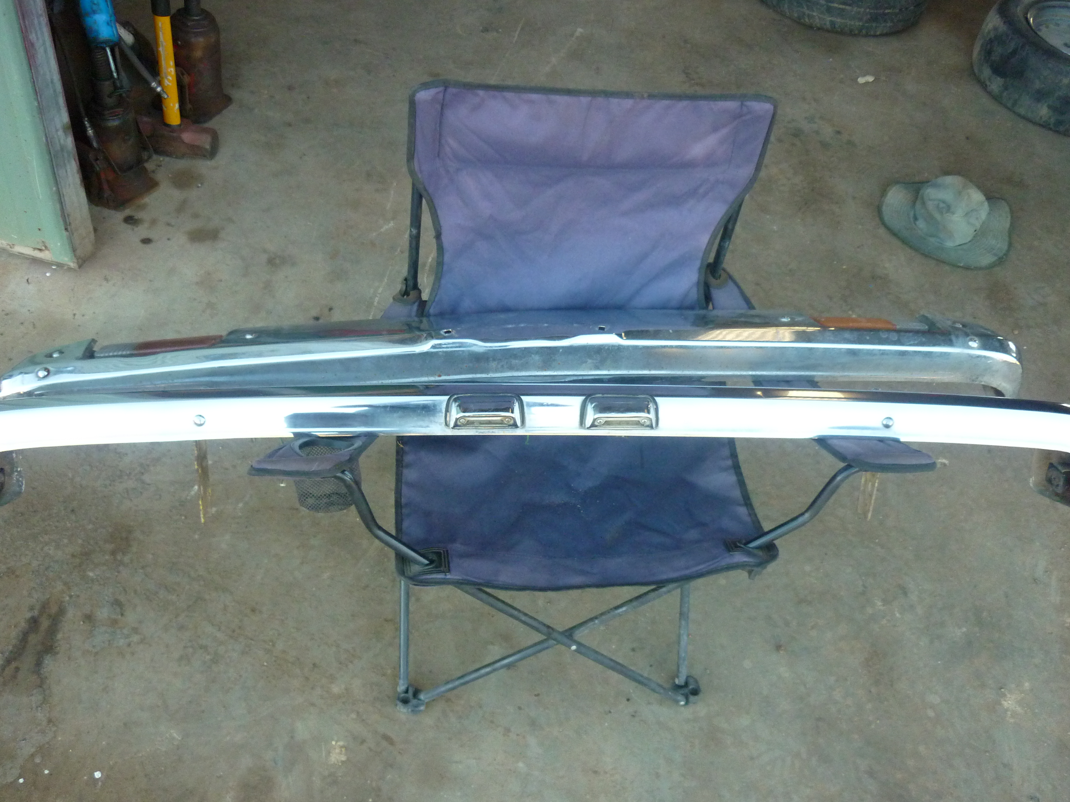

they are the rims i will be using i gave them ring a quick polish but the middle is alloy is wasnt as easy :/
also some ke30 bumpers
Edited by xr8racer
they come up a treat, mate..!

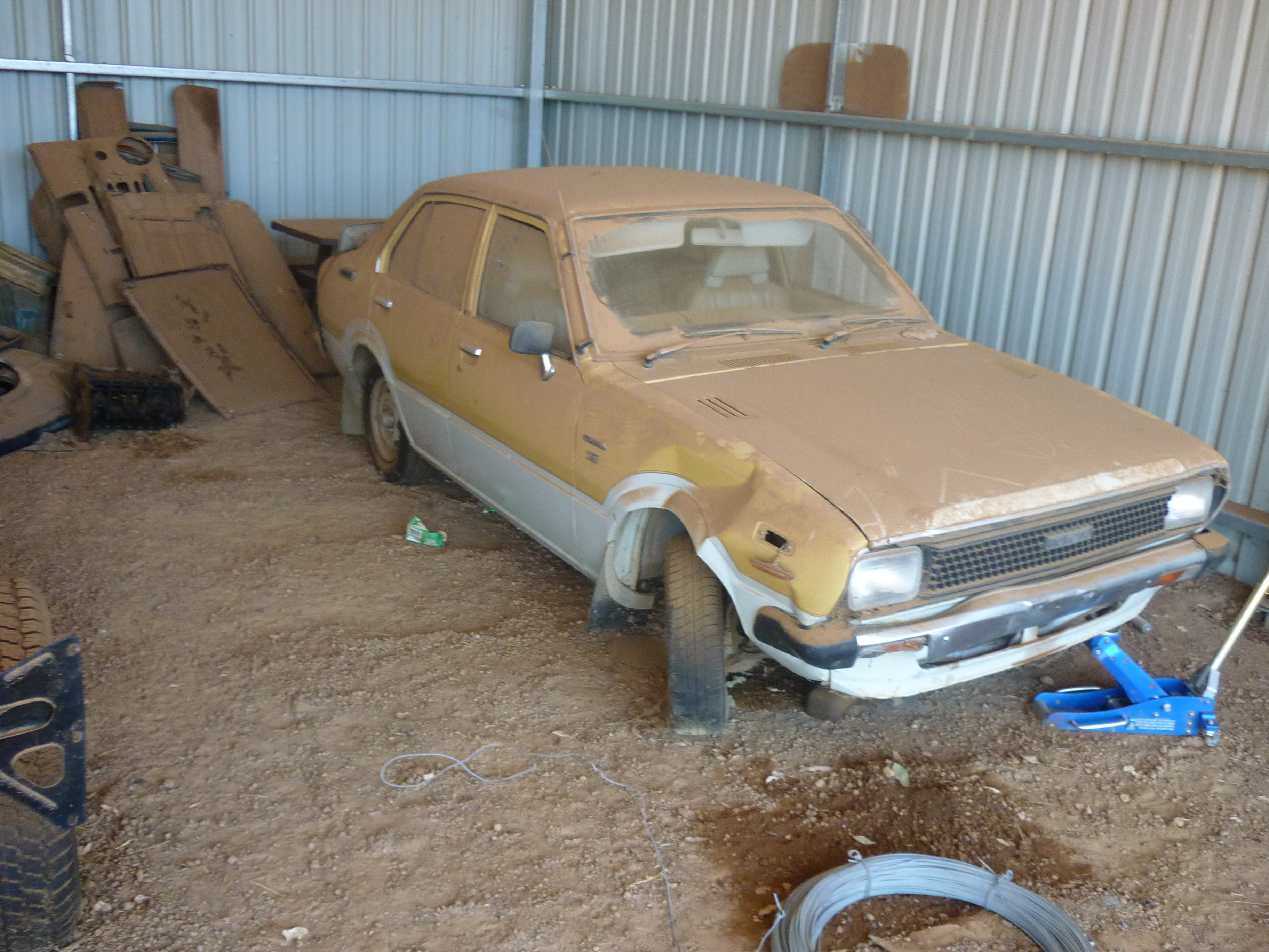

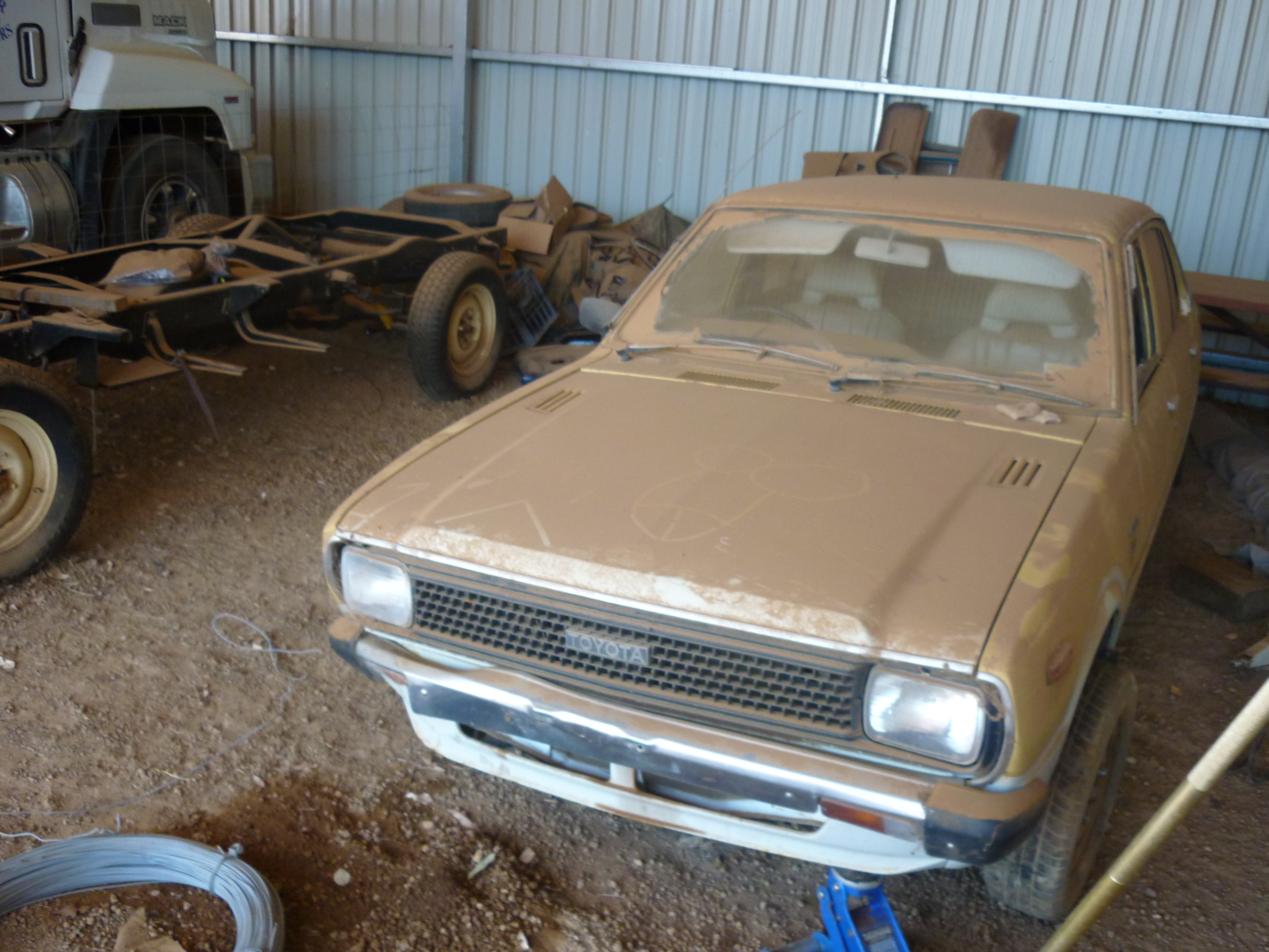

post-13373-0-56855500-1330940350_thumb.jpg my 55:) doesnt look to flash here but I'm glad i stored it in the shedpost-13373-0-33386800-1330940521_thumb.jpg
