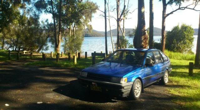

azza91 Posted July 8, 2012 Author Report Posted July 8, 2012 went and visited a spot i havnt been to in a few years today Quote
