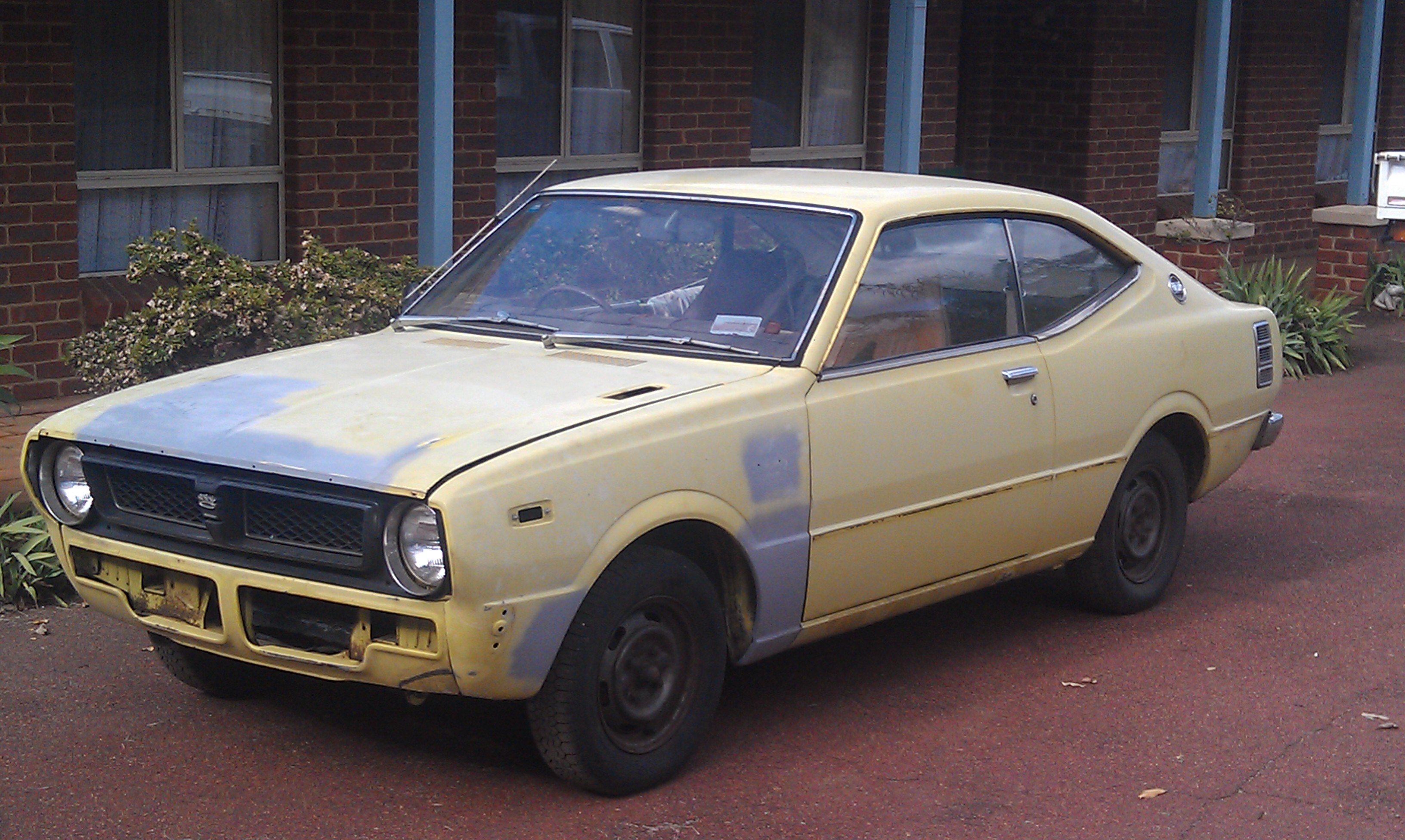

Hey, Alright i have finally come across a desicion of that i am going to put the map sensored 4agze that i have into my ke35. It has 122xxx kms and has upgraded cams and some other stuff. I have done the body work, just need to pull the 3k out and get the bay painted.
• I have a couple of grand$$.
• It gets done when, when its done.
• I have access to welding and grinding/ fabrication.
• I have access to automotive electrical.
Anything else?
I have searched alot of 4age's into the ke35/55 but if anyone has any hints or things to wathc out for? i would love to know it. :) post-14401-0-59599500-1327318376_thumb.jpg

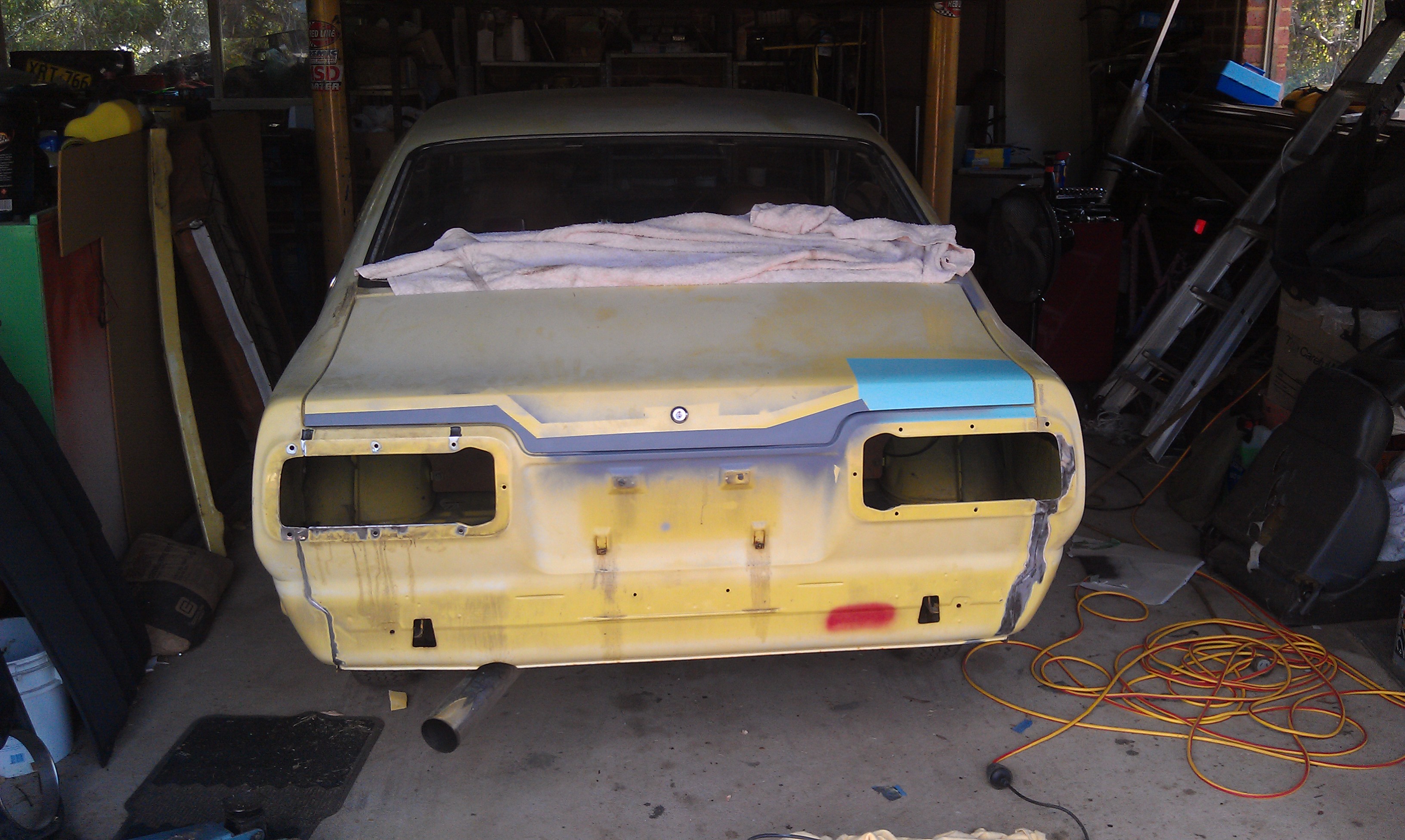

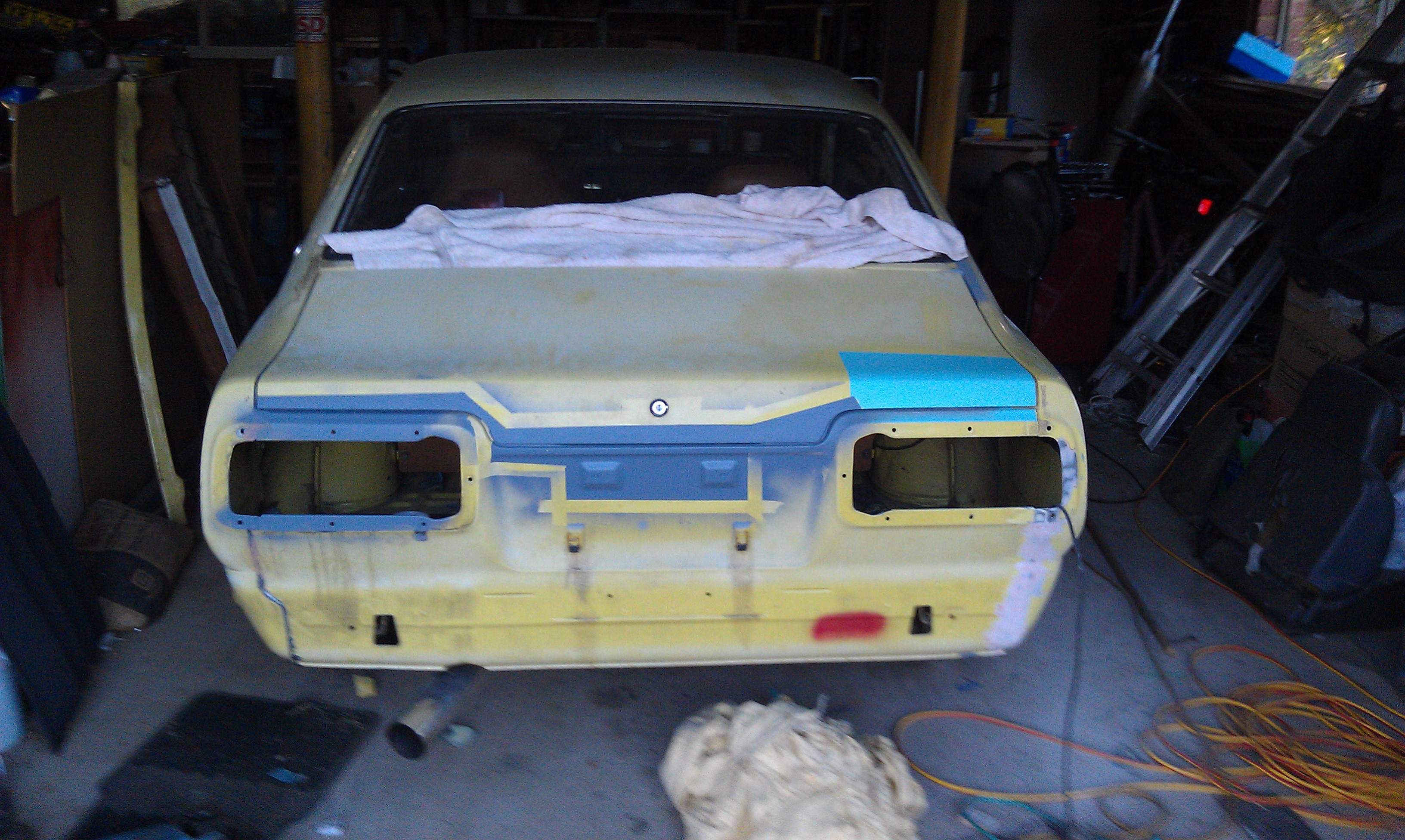

did a heap of body work again over the weekend, as i had it up on the hoist and noticed a bit of damage, as i was sanding, it showed a heap of rust so i have been busy sanding, rustproofing and bogging, sanding etc.
Today, i mainly filled the rust proofed area and sanded it all back...

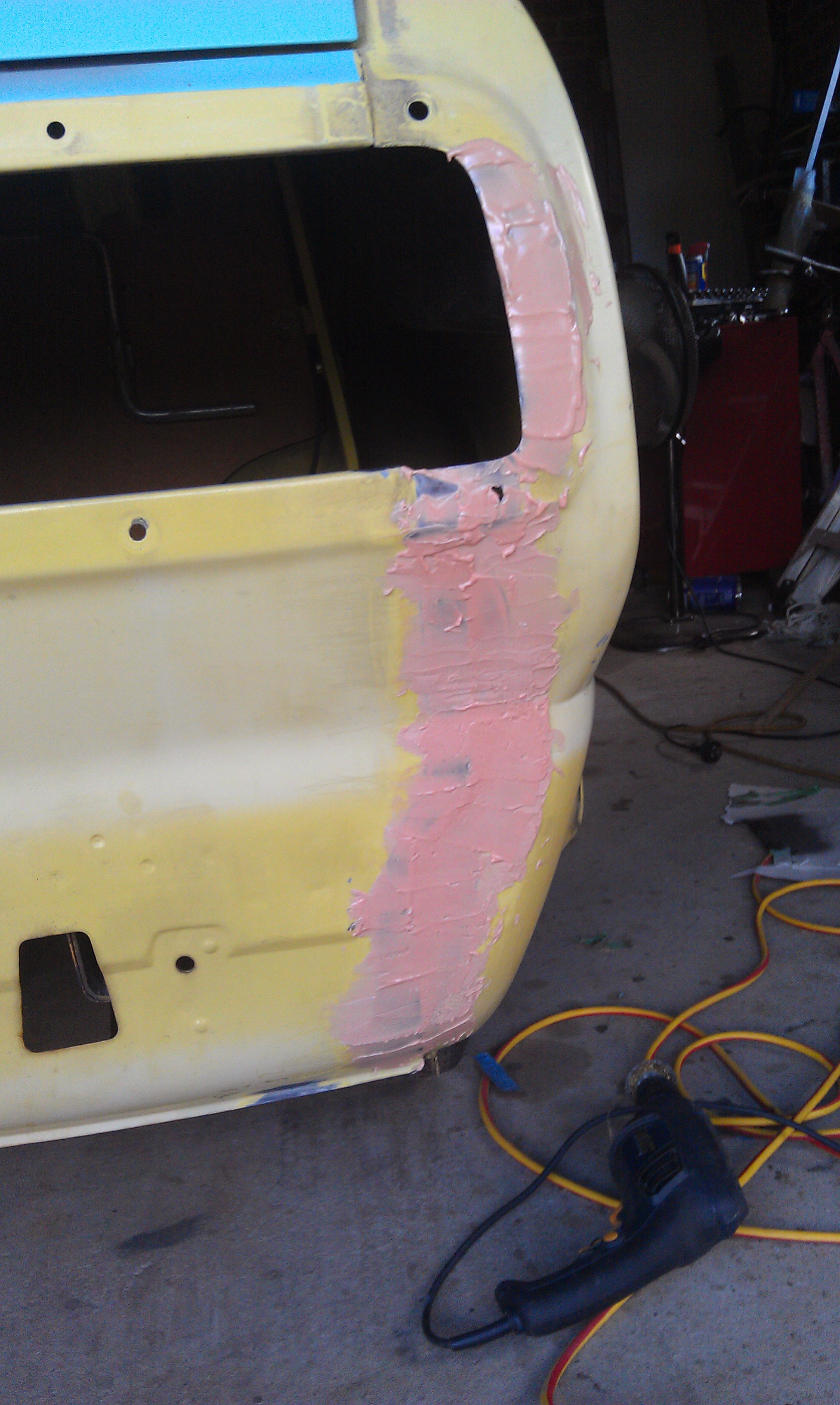

from this, at the start of the weekend ,

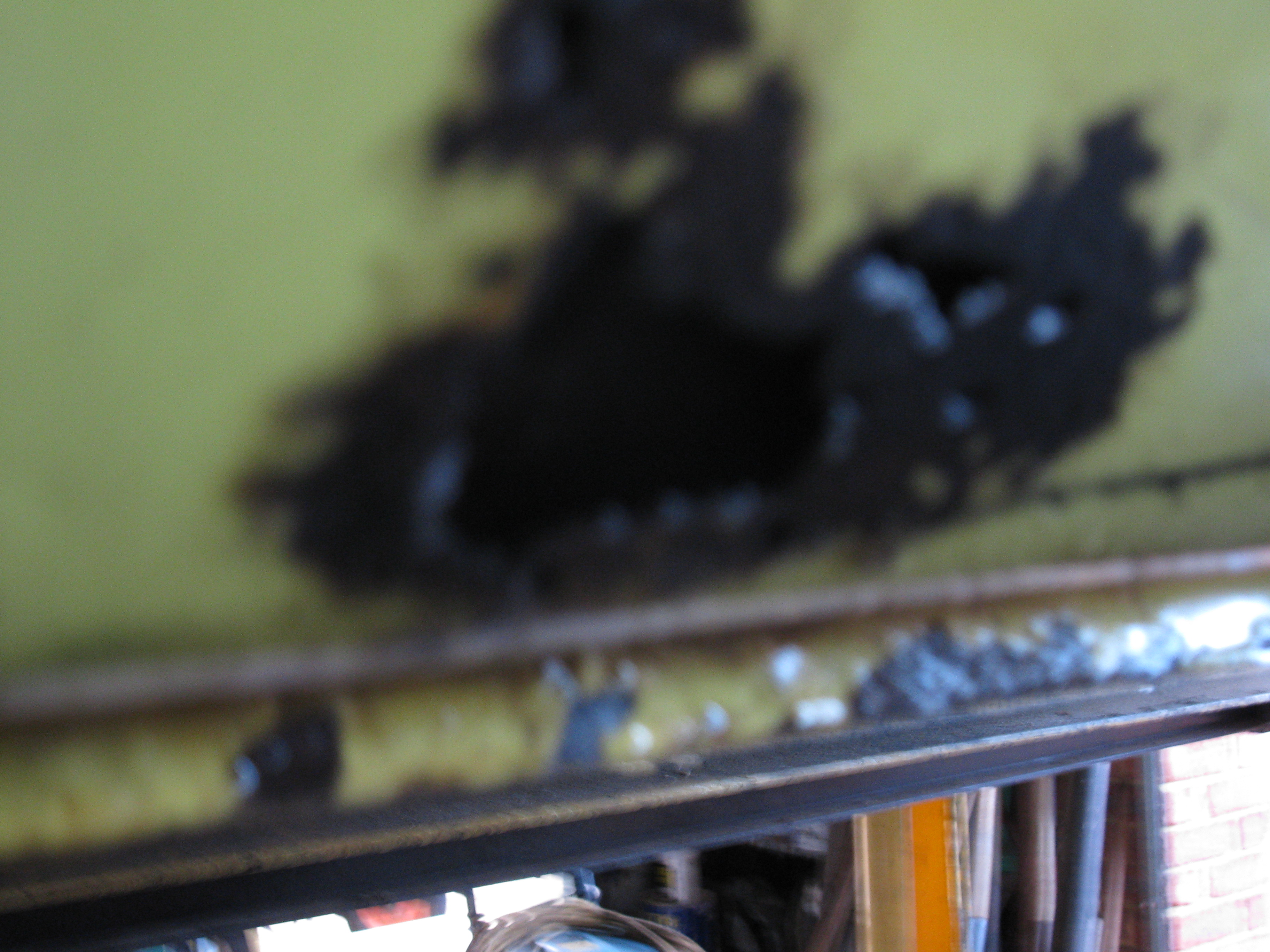

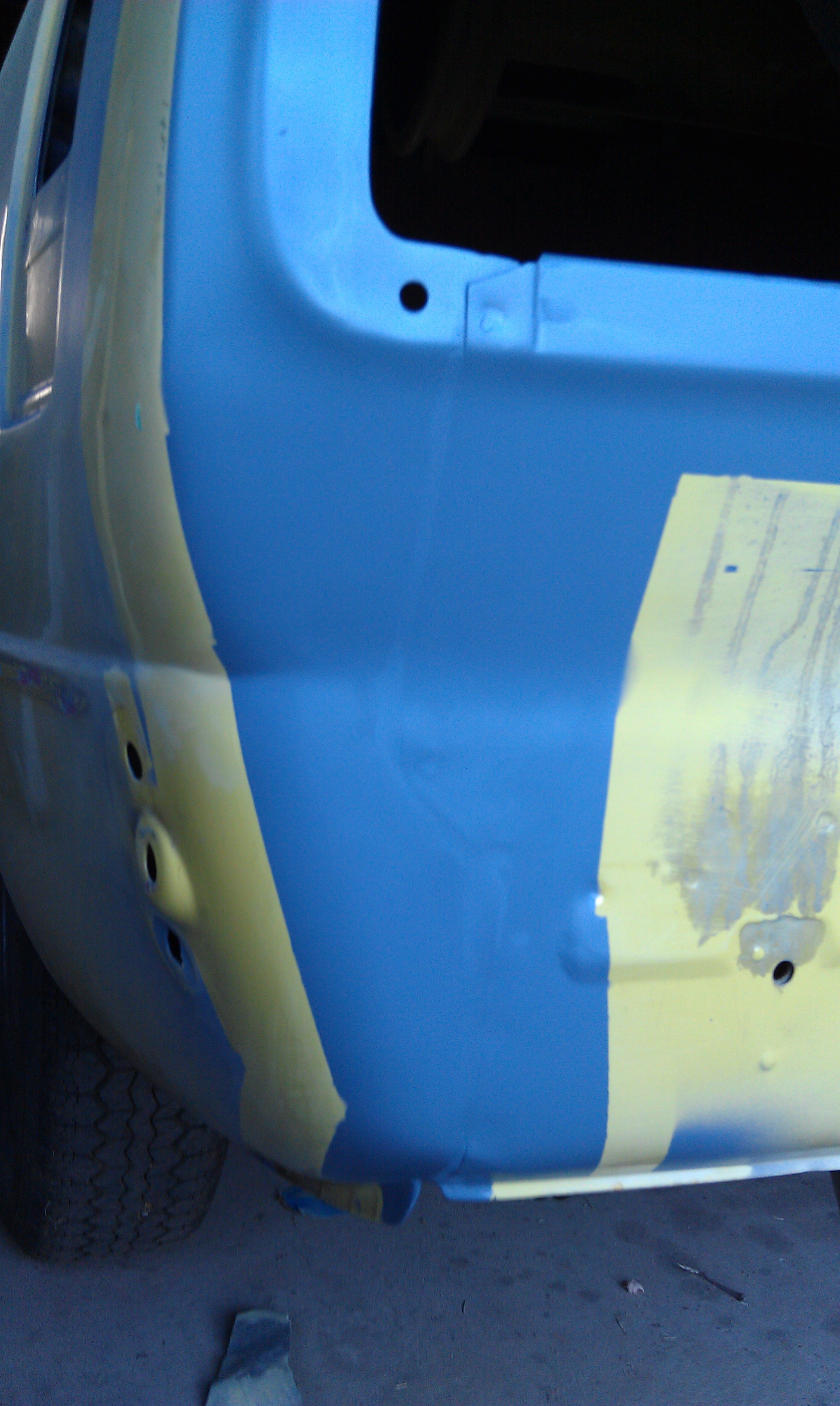

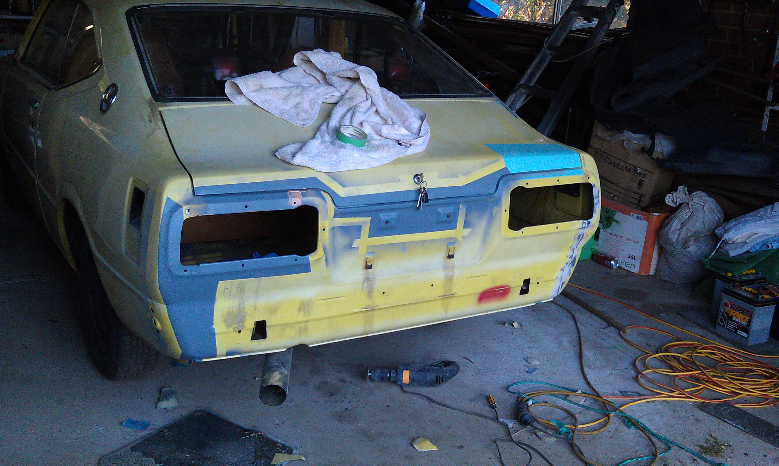

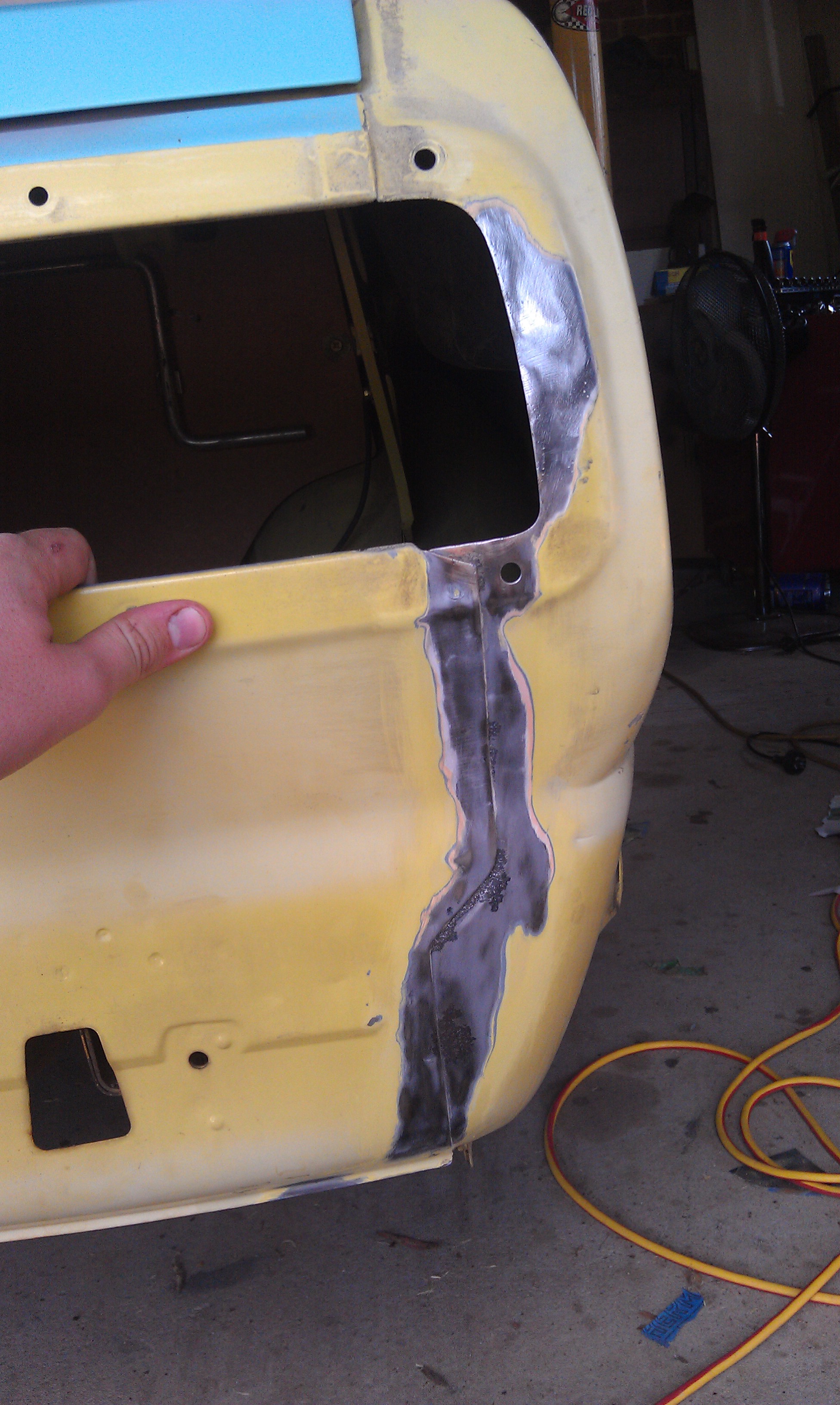

So as you can see, i have been busy with the body work, where i bogged up the crack, sanded, bogged, sanded, etc. Finally preped and painted, now looks sweeeet:D just the other side. Then i have one more/ major rust hole (check photos) in the side i have to fix, i believe it is a bit big for bogg, soo, may have to weld up another piece:/ but i will see. I know the image is poorly focused, but it is an idea. Let me know what you think ... James
