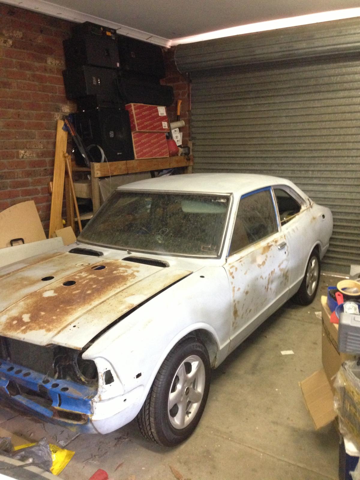

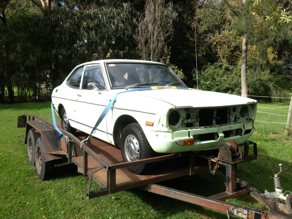

  2. Well its been a while, but the Panel beater is back on the job again. (Nearly all ready for paint) And my now 18 year old son is getting into action on his one. Picked up another compete 74 model KE25. Some rust but nothing we don't have spares for. So here goes this Easter. Really hope to get something accomplished in the next 2 weeks.

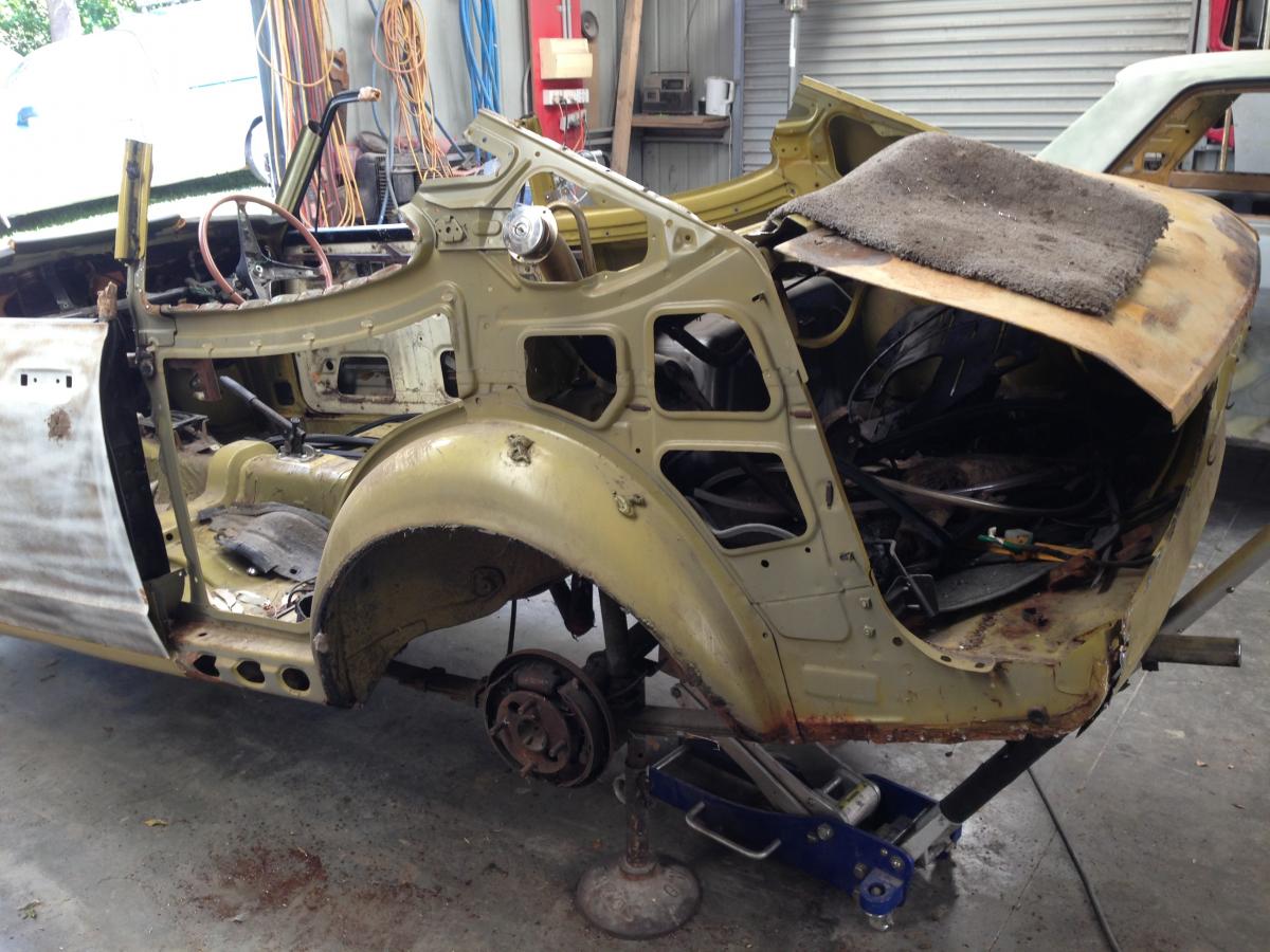

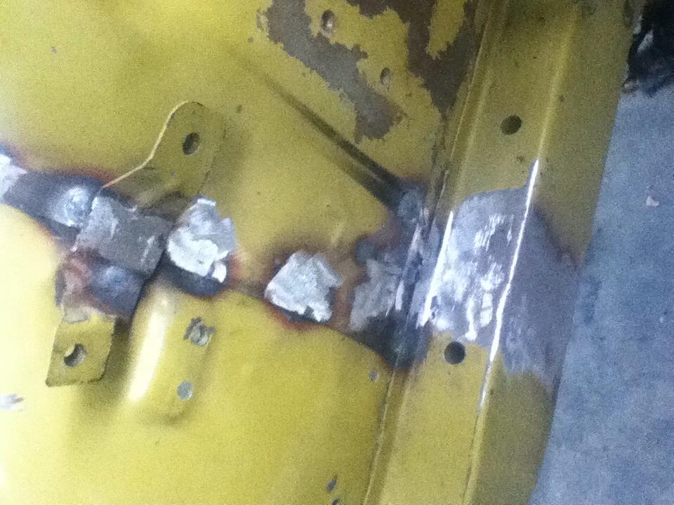

  3. In answer to how the chassis rail was fixed, the inner fender was unstitched next to the strut tower and he rail cut just below on the outer section ad the inner further up. then the new section put in. Did similar on the rear qtr. While he was at it pumped the rear guards out an inch by putting and extra inch of metal in the rear tub then attaching the qtr over the new wider tubs. now has the same roundness as the front guards have. Now able to cover 215's on 6 inch rims fitted to a wider K30 rear end. Wouldn't know it was done unless you put it next to another one. Well the garage needs to be a bit bigger now, my son brought hi own and I picked up another one. so that brings the total to 4 KE25's, 3x74s and one 73. Just a little repair work and a couple of resprays. Guess I'm on the parts hunt once again. For the life of me can't get the pictures in the right order or spots

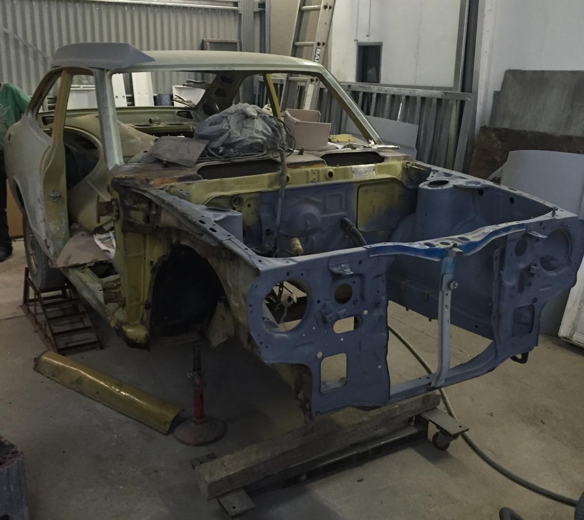

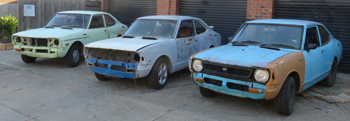

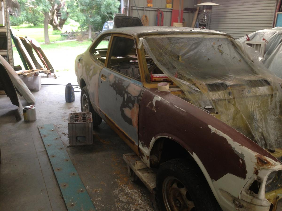

  4. Getting the panel better to do it. He's taken the front out of one and doing a full replacement of the chassis rail and inner fender. That way no more rust. Doing the same for the rest of the rust sections. Lucky for me I have 3 cars and between them they are all have major rust in different places. So I can cut up one to fix the other 2.
  5. Here are a couple of pics So at last it is progressing

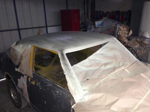

  6. Well the cars are at a panel shop so the project is once again under way. Best bit I my son is doing work experience there and I too can drop in and work on the car any time I like. So far fully stripped the roof and started on the rest of the car. Mostly going bare metal on it now. Everywhere that was repaired last time. The roof is now in epoxy primer. Also what was the blue one turned out to be in the best shape of all 3 even though the roof was totaled. So the newest of the 3 has lost it's roof and front end so far. Rear qtrs and door frames are next. I'll be getting updates from my son each week as he will be put to work on it when there are no other jobs in. And he is now getting the second one. He is already putting ideas of how it will be built.

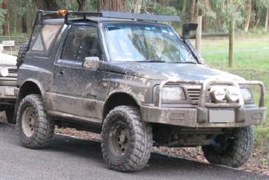

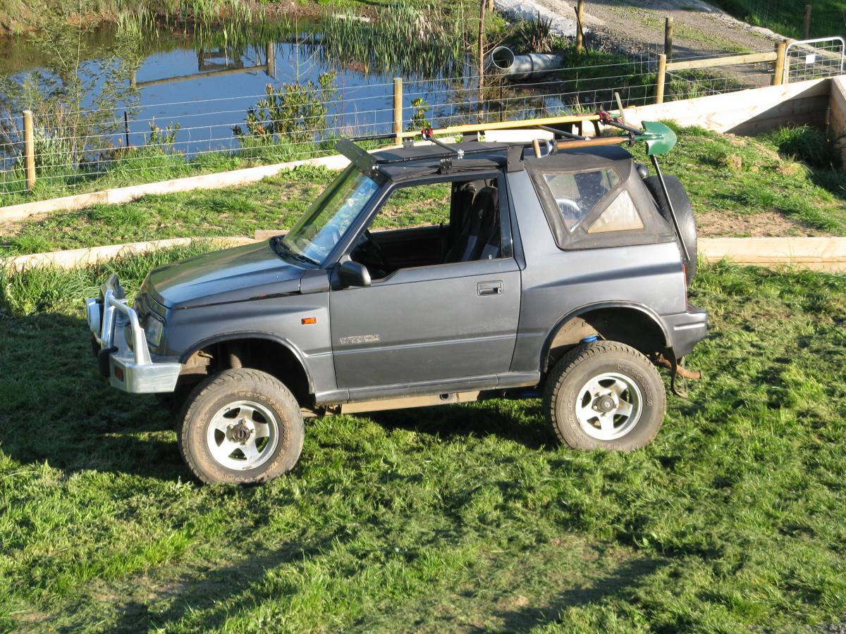

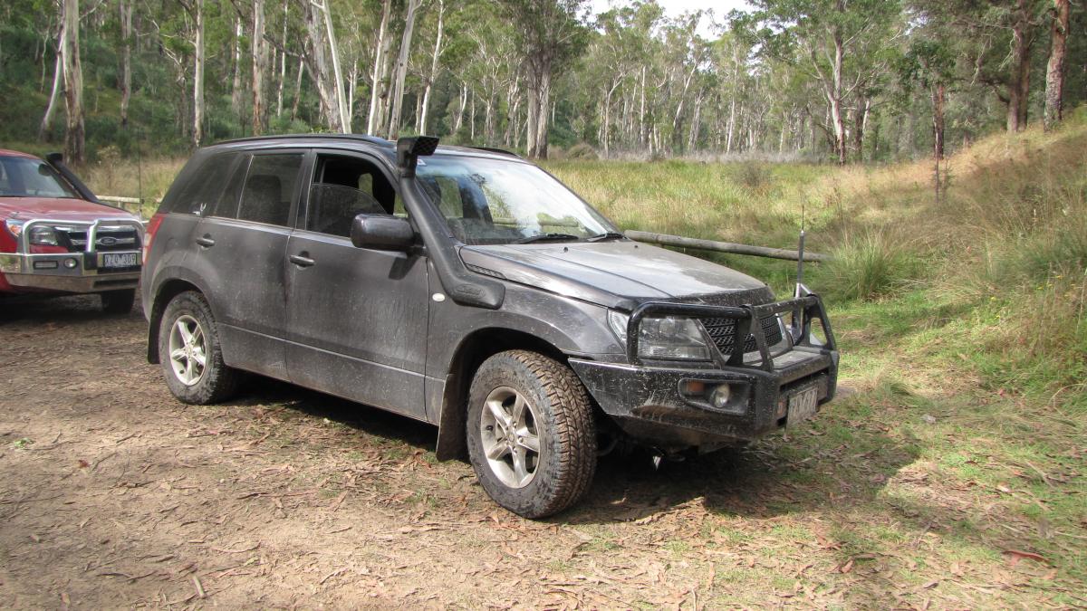

  13. Here is the other project and was my daily till I got a new work car. (below) Both are Suzuki Vitara's, Standard stuff like Bullbars,Towbars and Snorkles. The Shorty is liffted with a 3" body lift of my Design to pass Engineering. Calmini 3" Suspension lift, Calmini Rear Swingaway bar, Camini Stearing Stabilizer. Calmini Skid Plates ARB Rear Locker. Custom Roof Rack made from a Hills Swing Set. Custom Rear Draws. 235/75/15 ATR's for the road and 31/10.5.15 Muddys for fun. Here's a shot with the Muddys fitted More details http://auszookers.co...591&hilit=gizzy And it all started with 1

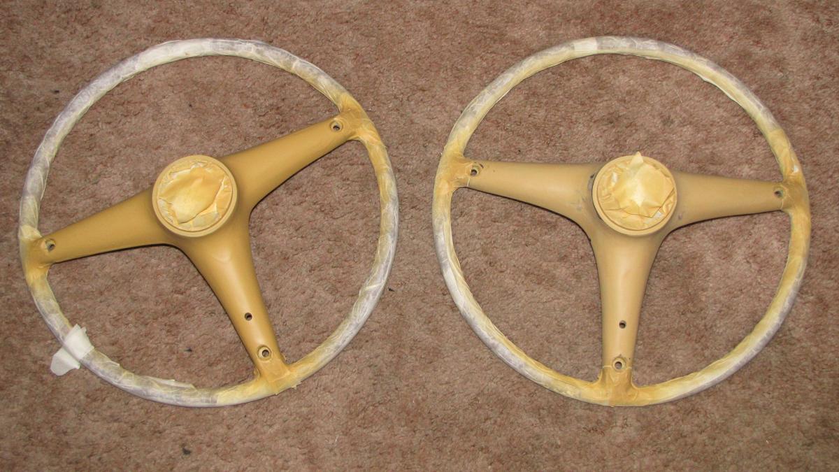

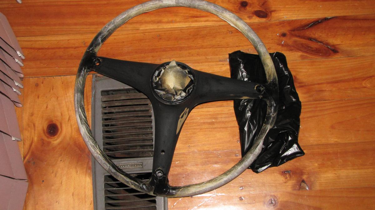

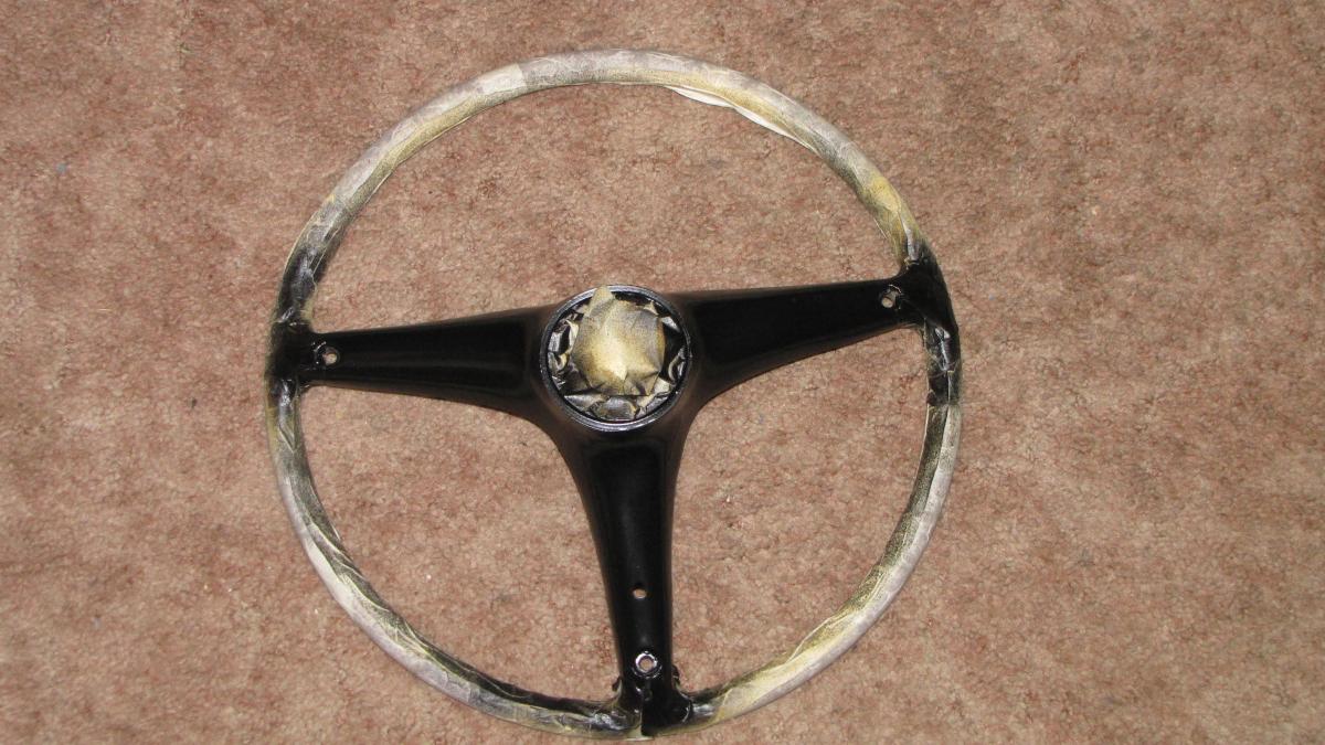

  18. Ok, started on the stearing wheels, the split one from Raven was actually pretty good compared to the one i had. Some how forgot to take a pic of the inbetween stage showing all the filler and gluing i did to fix the splits. But started with this and onothwer a lot worse. Then filled and sanded, primed, sanded again Sprayed black the first one, first coat. And got this. The Second one needs a bit more sanding before it is painted. Now to the change of plans. The first plan was to chuck an engine with an auto and AC together and enjoy it and let my son when he turns 18 have full use of it till he gets his own car in reward for good grades. The Second car work with my 15 year old and build a fun machine, 4AGE, T50, Coilovers etc. Well the grades haven't proven worthy. He's getting the spare parts car and everything he needs to build it up. I'll assist but he needs to do the work. My orginal one, now, 4AGE, T50, AC all the good bits and use the blue one for rust repair sections for both cars. Good news is the 15 year old wants the same car as I do. Plus it give me more time to get it working. Watch this space to see what happens.

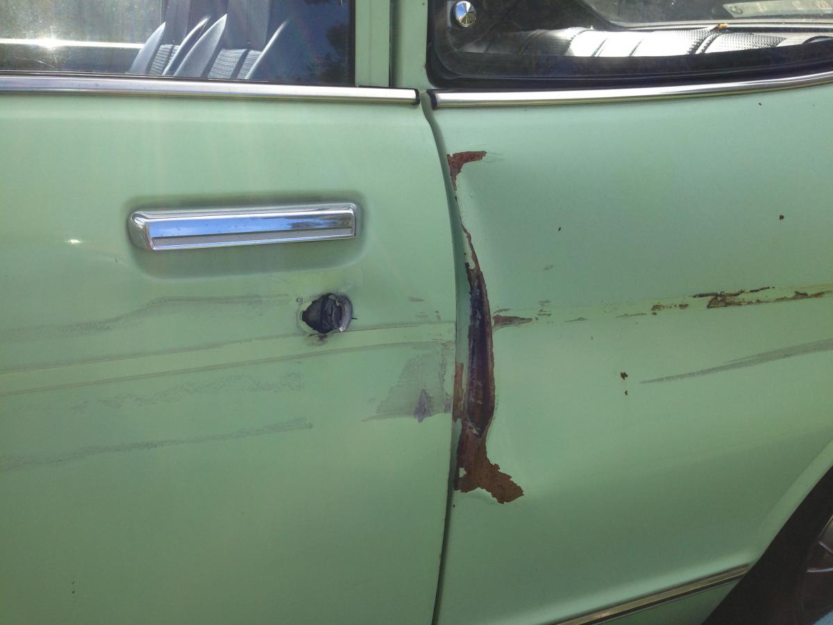

  22. Panel beater came over, went over the 3 cars, said it was a shame to cut up even one of them. If i could get a chasis rail from another car all 3 are repairable. The toughest to fix will be the blue one's roof, but doable. The big rust holes on the yellow ones are easier to deal with. don't think I have the parts to build 3.
