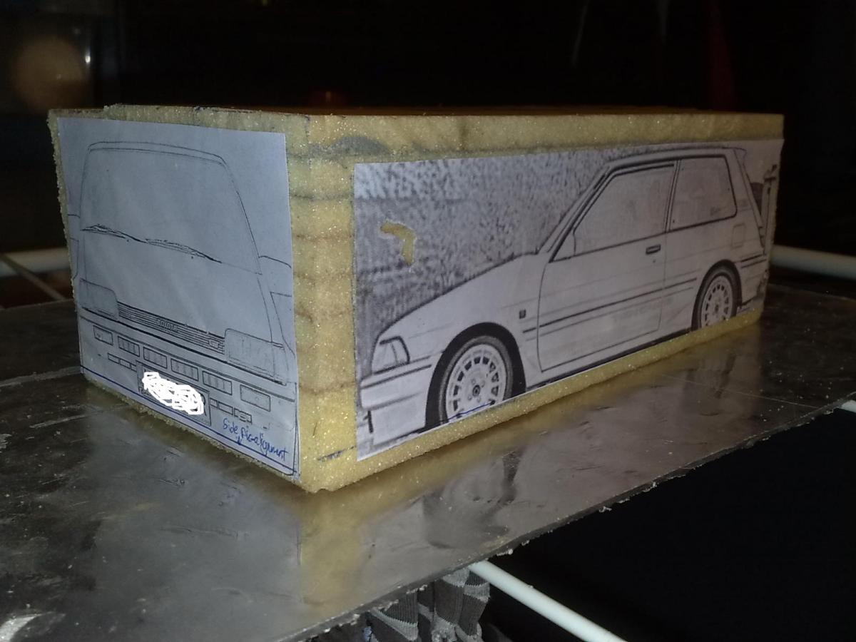

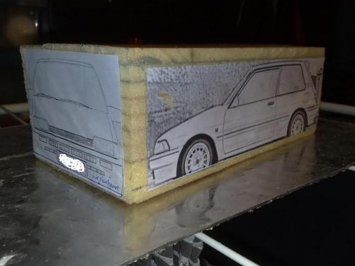

Using leftover pieces of high-density foam & liquid nails, I made a block roughly the size/scale I needed.

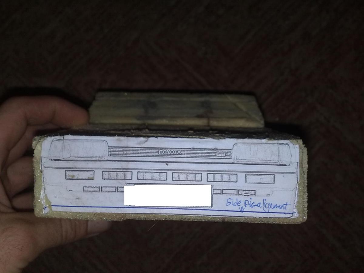

Using a photo editing program, adapted a few photos to suit. Printed, cut out & stuck on with contact adhesive.

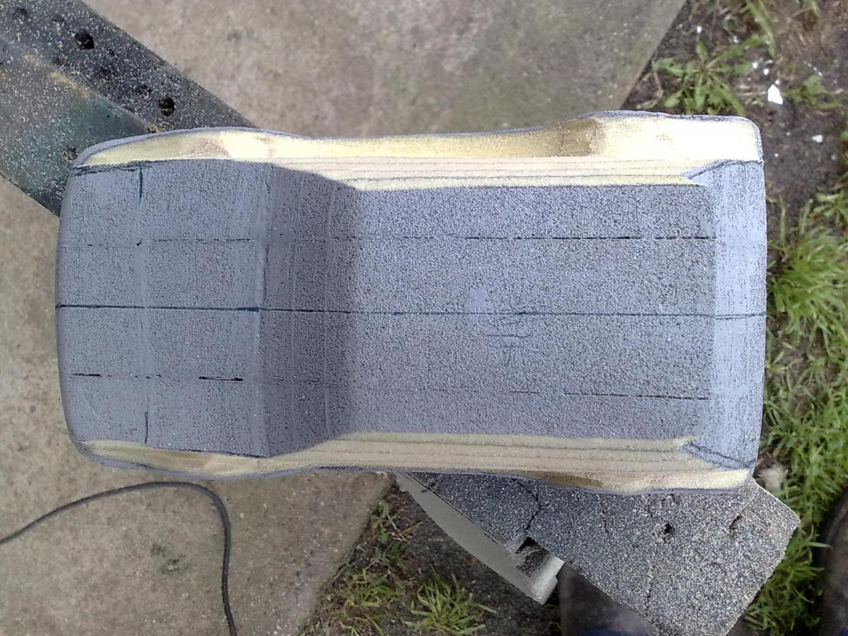

Hacked into shape using a hand saw.
Touched up with a grinder (probably my favourite power tool, ever!).
Gave it a rough sand/shape by hand, helps a lot when you've got a full sized one sitting in the driveway for reference. Then a finer grit sand to finish off & a coat of primer. Next up is a final shaping sand (some bits need some love) then bog! :D

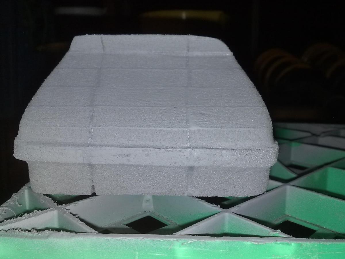

I didn't measure twice, cut once. :bash: Made the plug too wide so I had the task of narrowing down, did look kinda cool as an ultra-widebody. :lol:
It was so not symetrical it's not funny. :(
Squared up the sides & reshaped the bumpers/wheelarches (sorry, no pics). Then bogged the hell out of it. :laff:
