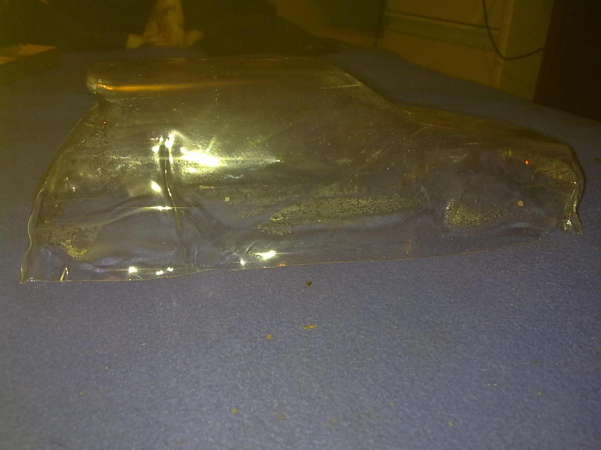

Plastics lesson #8 for me - Polycarbonate can be expensive...like $65 for a 900mm x 600mm sheet of 3mm expensive. Fortunately I don't need it that thick & managed to find some 1.5mm stuff for $20 a square metre, much better!
First attempt was a fail, it only shaped over the roof so I reheated it & went again. Got the position wrong & stuffed it. Second attempt I didn't pay attention to the plastic as it was heating & made a mess on the BBQ hotplate.
Third attempt (with some 'massaging' with a heatgun) came out alright. Difficult not to get the creases in the corners but the hatch spoiler & front bumper shaped up quite nicely. Tough enough to not crumple when you pick it up too.
You never get this sort of stuff on the first go, or third.
And the problem might not be heat but unsufficiant vacume. you only get a few seconds before it hardens. or it gets too hot and melts through and you get holes.
Look at maybe adding a second vac to the system to speed up the forming process.
^ This guy speaks the truth! It's why I bought several metres of the stuff, prepared for failure. :lol: I'm thinking a second vacuum will definitely be of assistance, thankyou for the tip man!

The steering servo-motor kept pulling itself and/or its mounting bracket off, so I replaced the screws with bolts & nuts. Nice & solid now. Also have some ballast attached to even out the weight distribution, thanks to the battery it turned left brilliantly, right turns...not so much.
I've built another box for the vacuum forming process, smaller volume so it & the plug can fit inside the bbq with the hood down to be able to vacuum it with even heat.
The plug has had a sand & the bog is currently curing, it needed some attention after the abuse it received from the heatgun. I'll give that a sand then a quick spray of primer, then I need to steal my housemates bbq back again. :lol:
