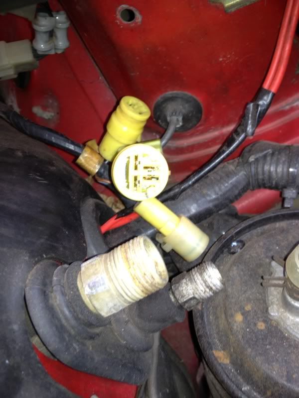

We were helping a new twincam owner today to do his timing. He shorted out the wrong wires on the service plug (see pic below) and now the check engine light does not come on and the engine cranks but wont start. We checked all the fuses but still nothing. Anyone got any ideas? Thanks.

Any spark on a plug if you take it out and crank the motor over??
Can you hear the fuel pump priming??
Either the ECU or dizzy electronics burnt out would be the most likely. You'll have to go right back to the beginning and check everything, fuel, spark, sensors...

will check the spark, but the no light for check engine makes me think its the computer.
Mine was a wire to the positive side. It burned out where it connected and looked fine. I had the same issue, car would crank but not fire.

Thank you to both of you that took the time to help out. We found it. One of the fuses that looked ok on reinspection was actually blown and she is up and running....big relief :bash:
Ok finally sorted it and thought i'd post so as it might help someone else one day. The loom had a broken wire somewhere in the wiring where the looms goes across where the injectors are. Pulled the loom and all the problems went away, let it or move it slightly and problems were back. Got a 2nd hand loom for $90 problems solved.
