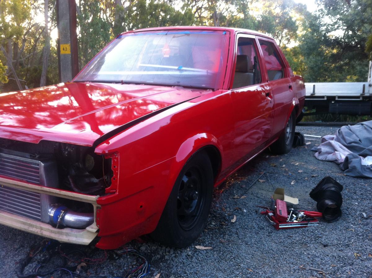

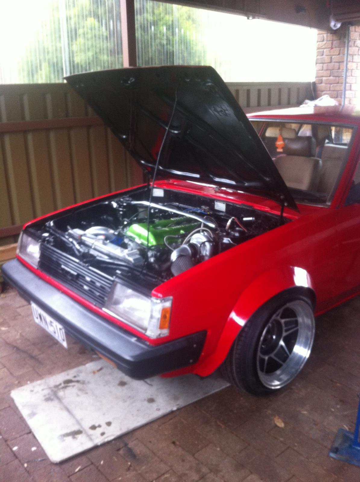

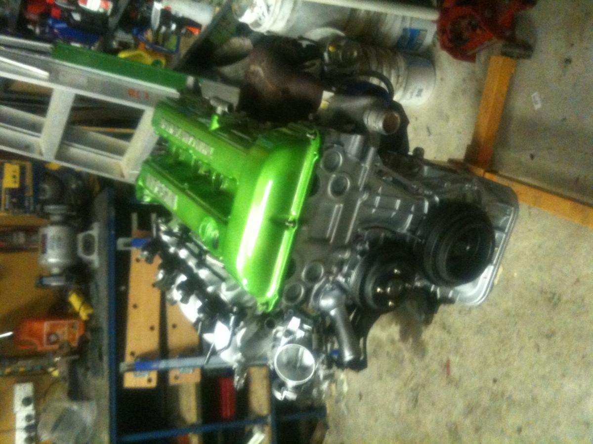

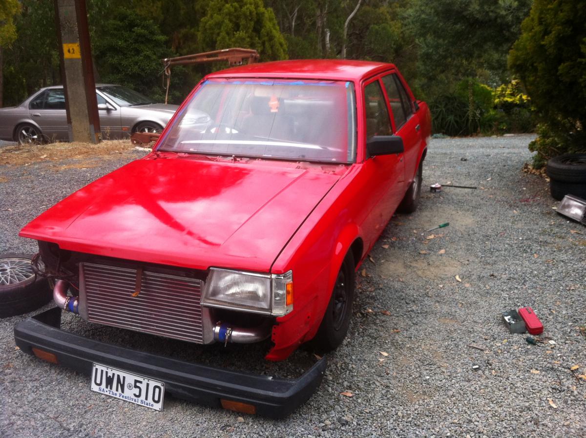

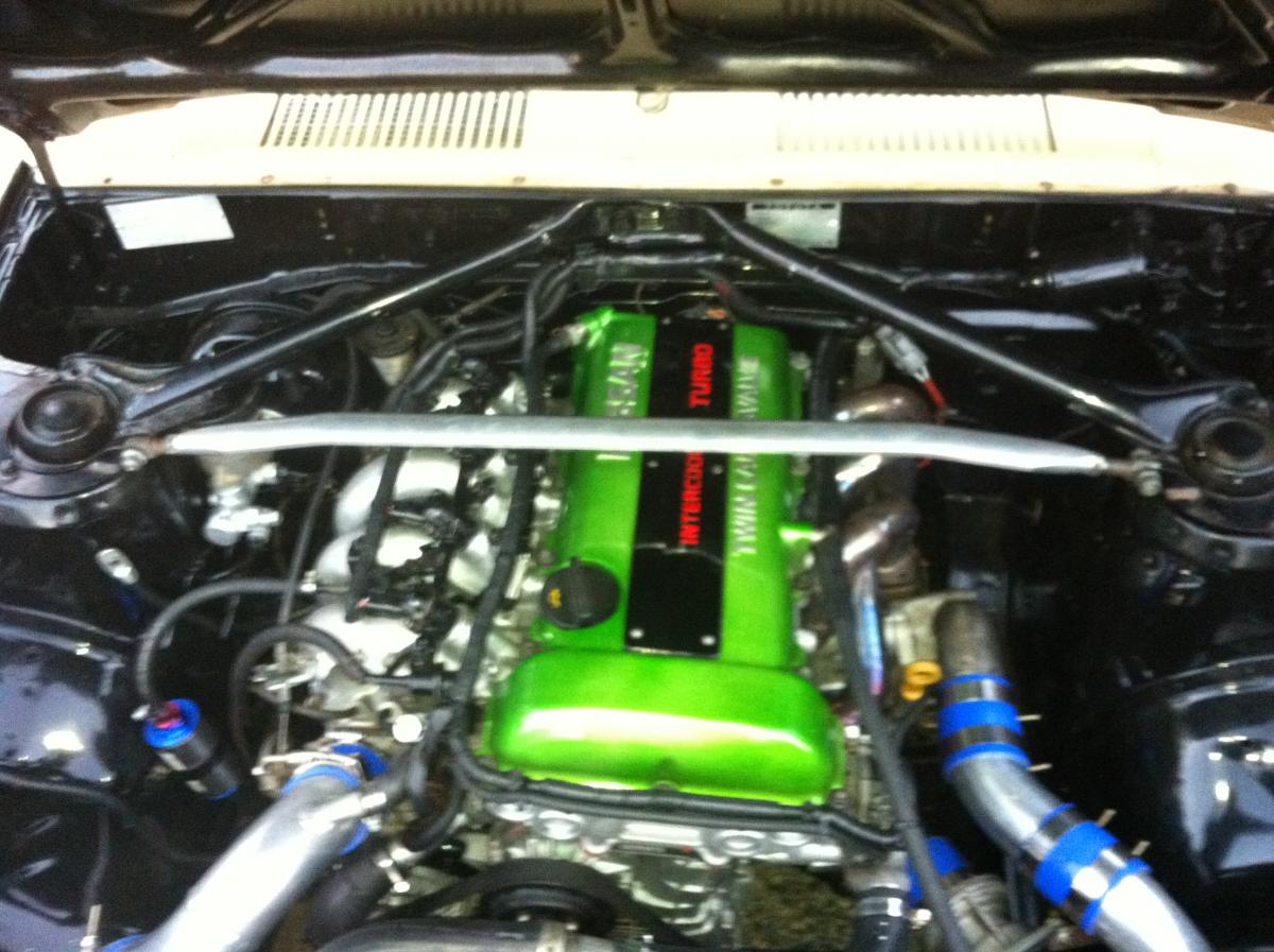

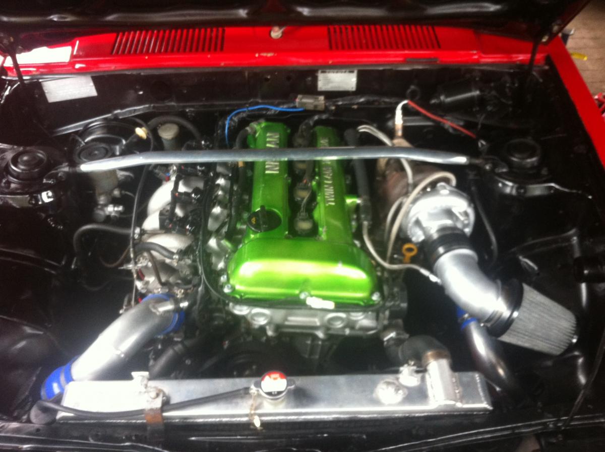

i purchased a ke70 back in march 2011 and found out it blew the head. so i looked in the shed and had a sr20det siting in the corner so i decided to see if it would fit that were to project took off.
so i fitted a forged sr20det in to a ke70 shell
mods done to date
ENGINE
.cp pistons
.eagle rods

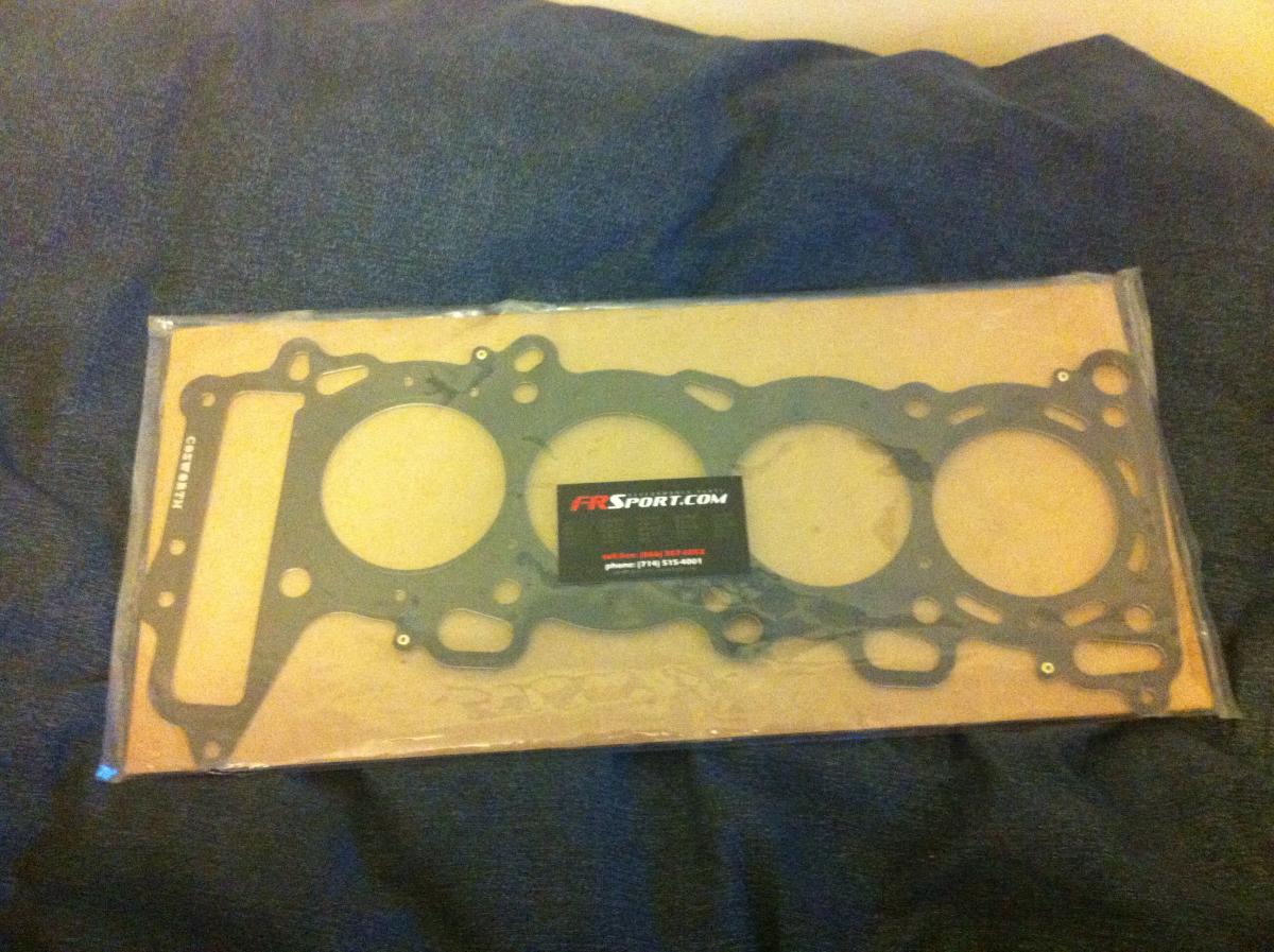

.cosworth head gasket
.arp head studs
.race bearings
.top mount turbo manifold
. garret 2871r
.550cc injectors
.z32 afm
.bigger sump eBay copy
.gktech roker stoppers
DRIVE TRAIN MODS

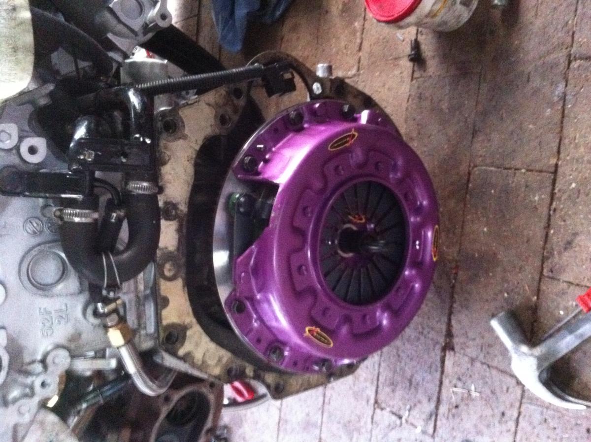

.extreme button clutch
.sr20det 5 speed manual
.moded ke70 tail shaft
.r31 skyline diff
.4.11 gears
.mini spool
BRAKES
.stock fronts :S need upgrade asap
.drum to disk rear vs commodore caliper
.gu patrol master cylinder

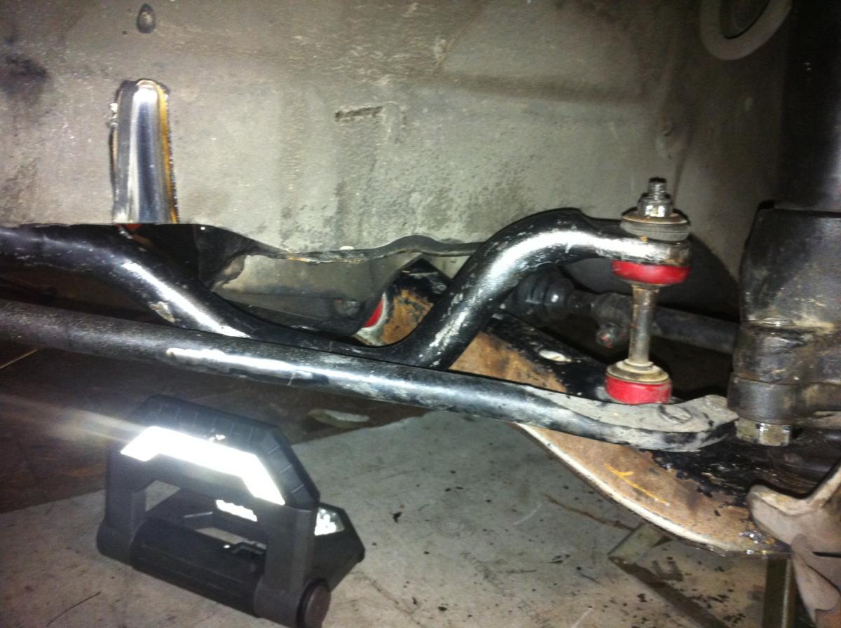

SUSPENSION

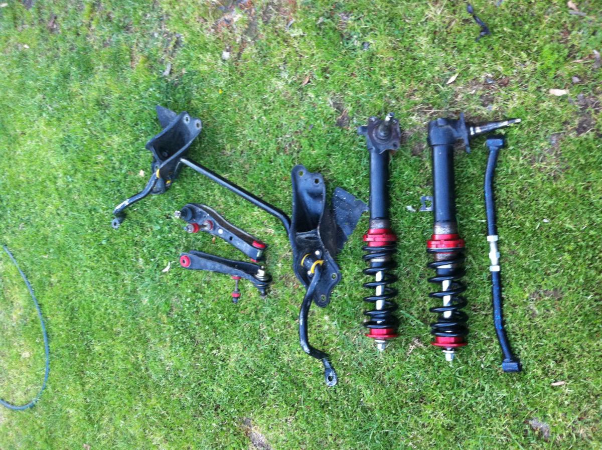

.ae86 coil overs in front with 9kg springs
.9kg rear lowerd springs
.whightline sway bars front and rear
.adjustable panhardbar
.front+rear strut brace
.front rcas
.corona xt130 lca

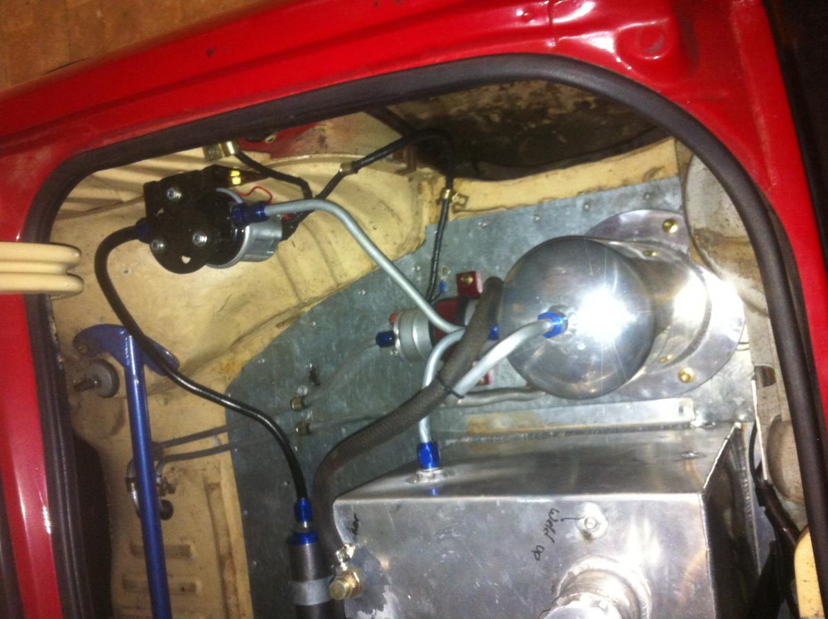

FUEL SYSTEM

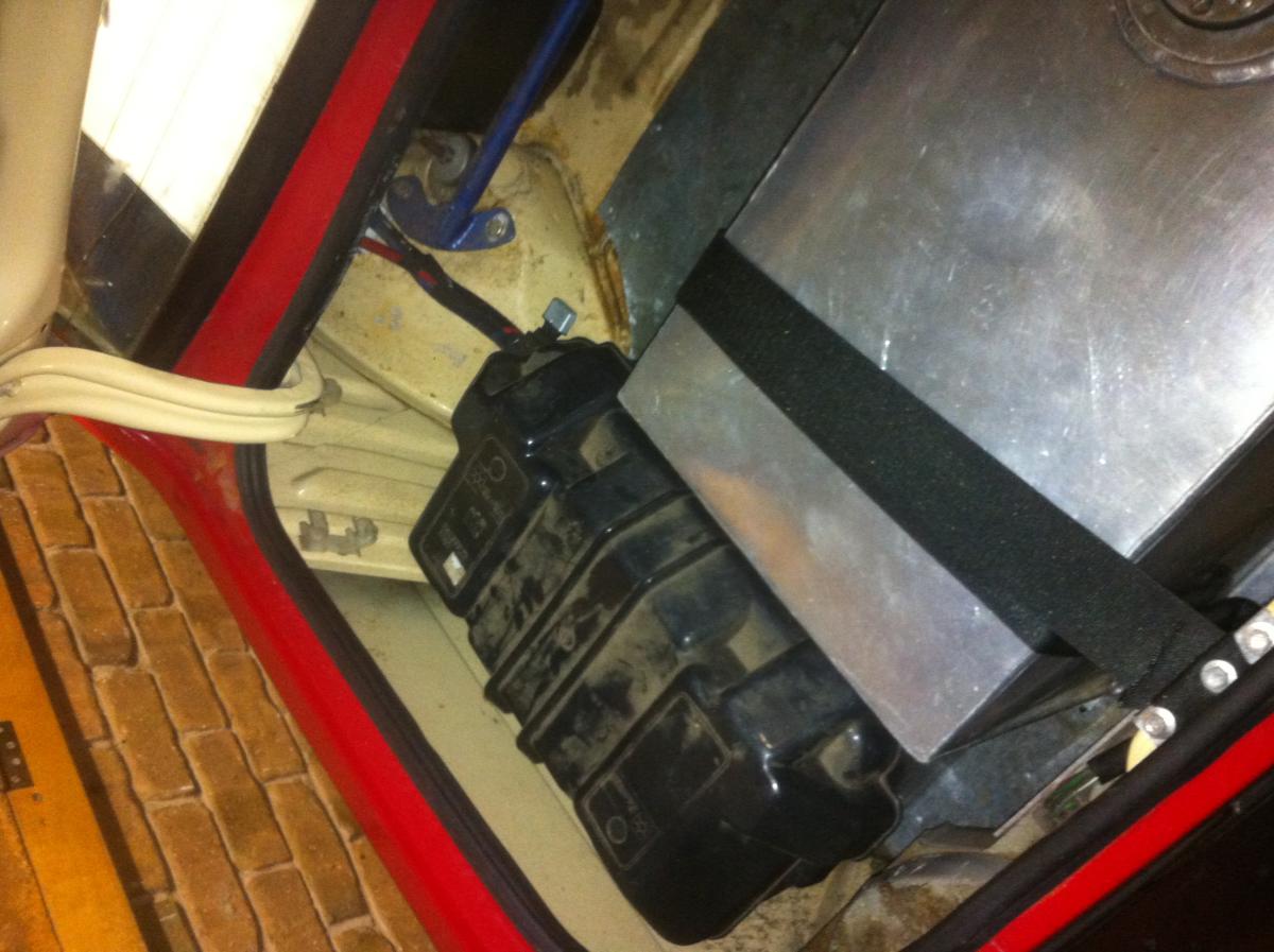

.60l fuel cell
.2.5l surge tank
.bosh 044 pump
.charter lift pump
.ally fuel hose
. all speed flow fittings

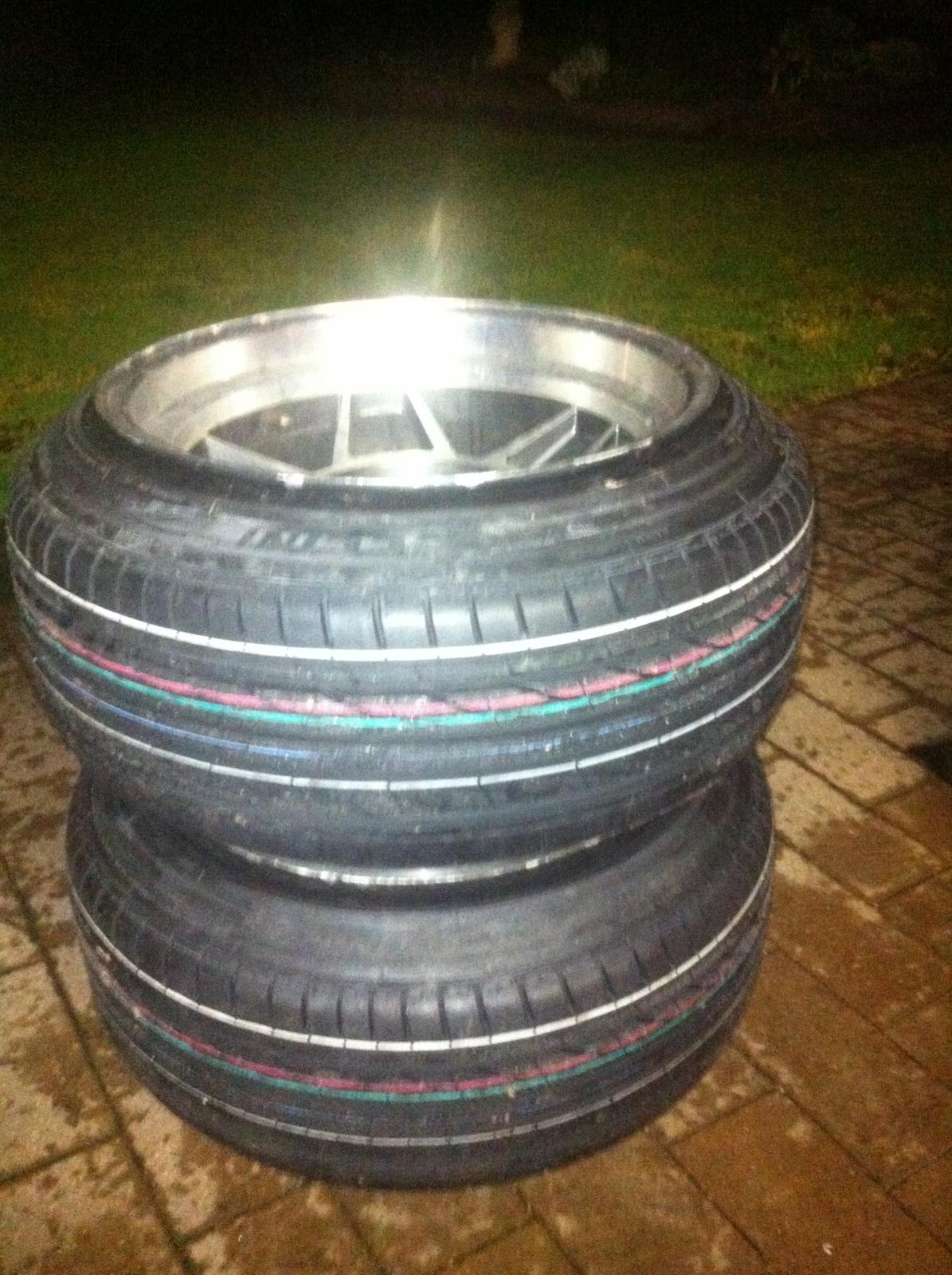

WHEELS
performance challengers
16-10" with -27 offset
Edited by simonjob

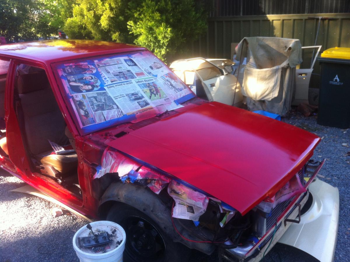

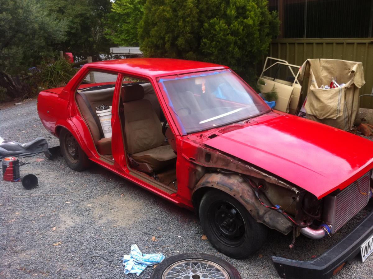

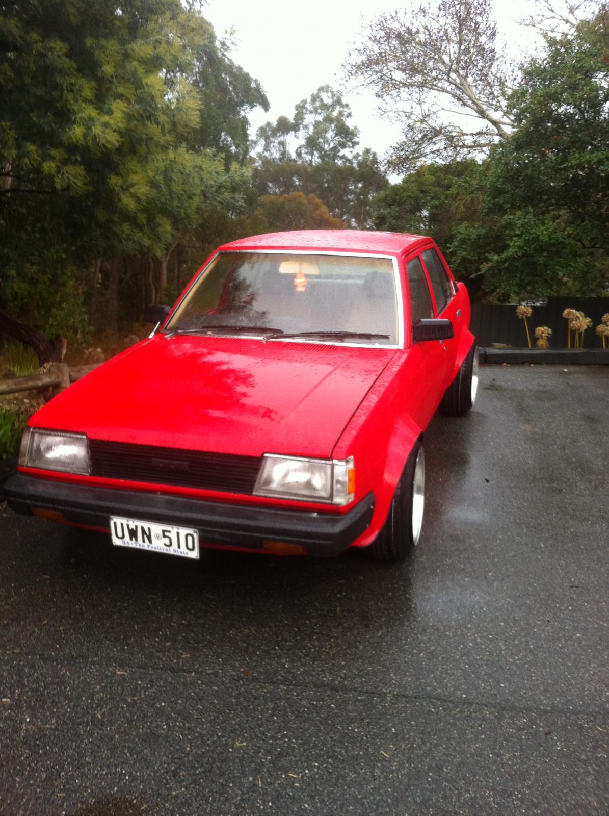

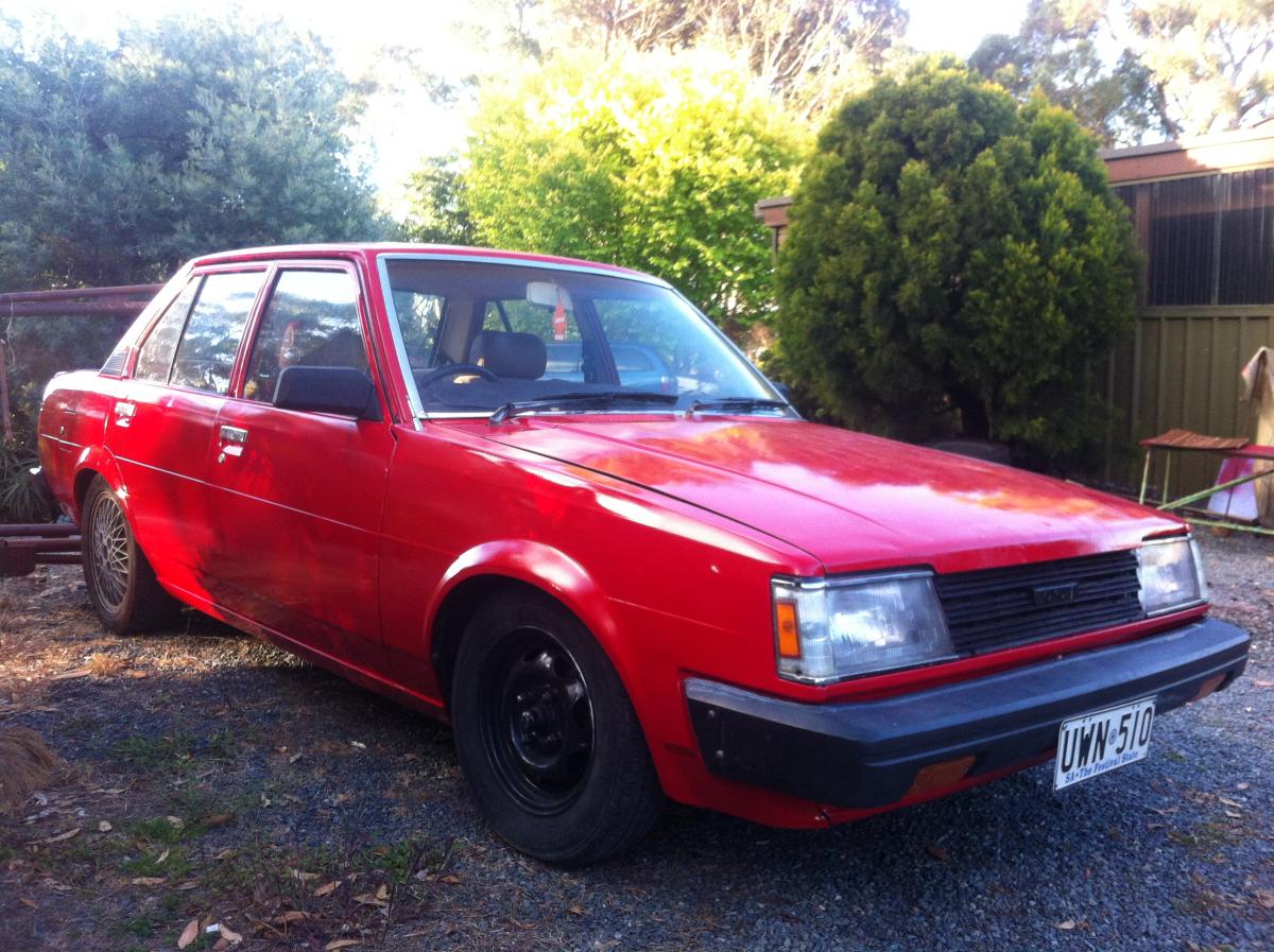

hey mate, such a sick car, i have a gze ae71, i started to paint it red then i just patched it coz i didn't have time to spray the whole thing, i can't wait to paint it, you are running the wheels i want haha :P but i like these things without a front bumper :D nice
yeah i got it cos it will show the cooler and cops don't like them and i will get done faster in it
I reckon you'll done get for the wheels first..
9kg springs seems very excessive, especially in the rear?
hmmmmmmm i love that green monster..........
yeah i can't remember weatherthey were 9kg or 6kg
yeah true, mines a track only car haha

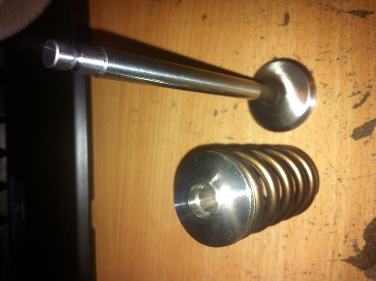

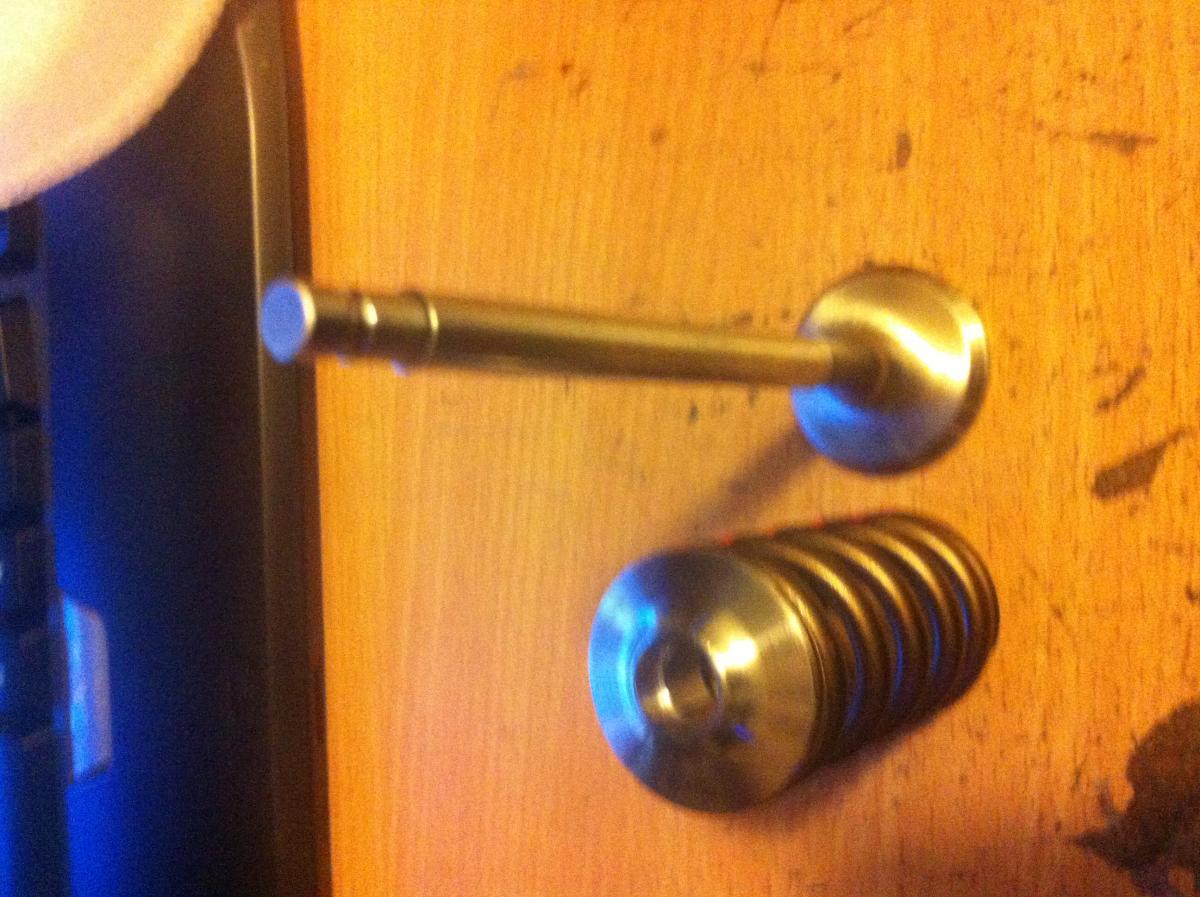

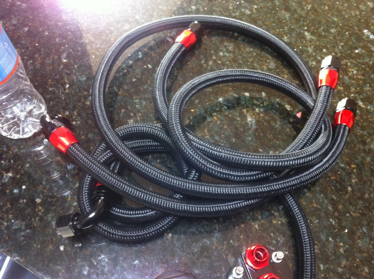

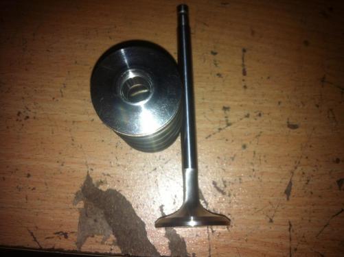

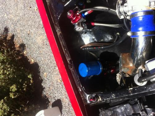

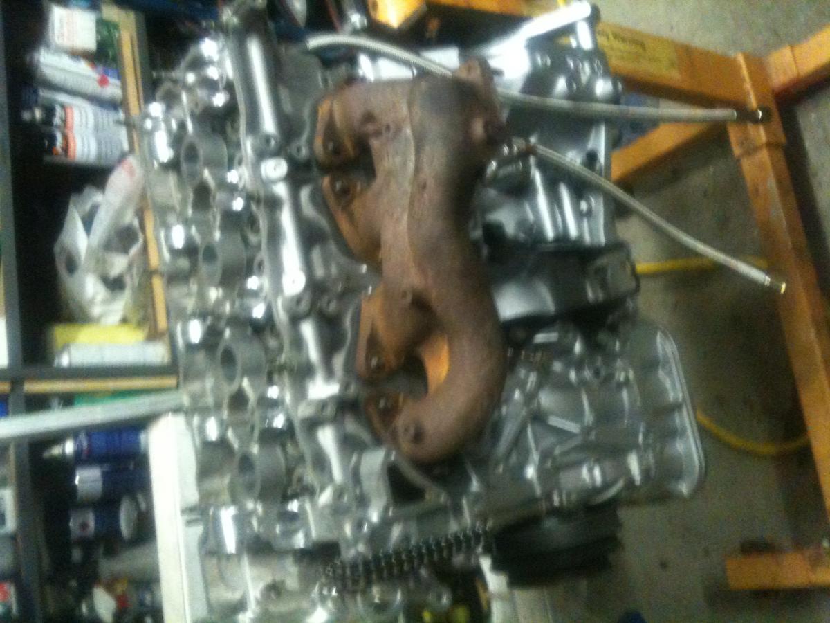

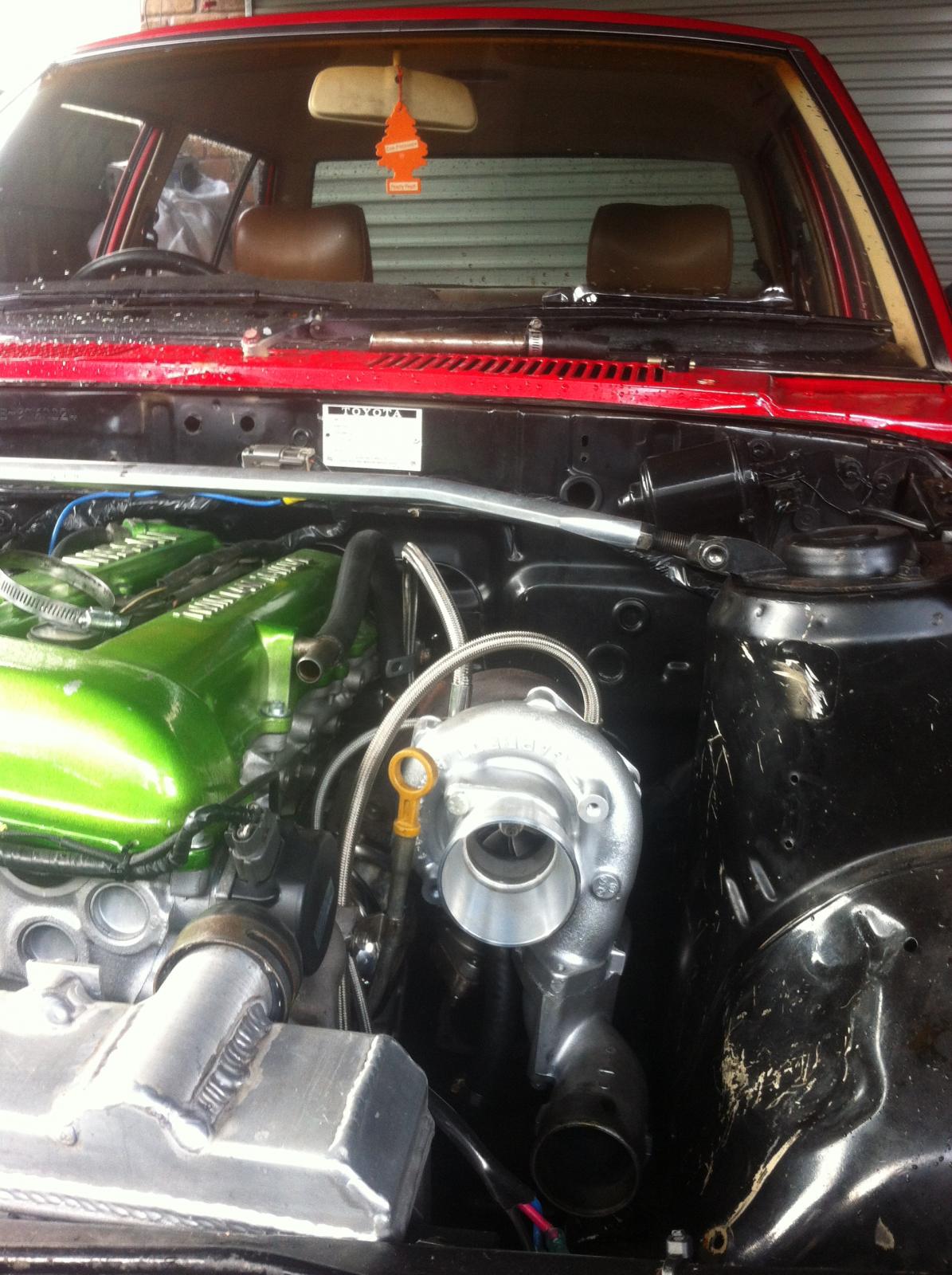

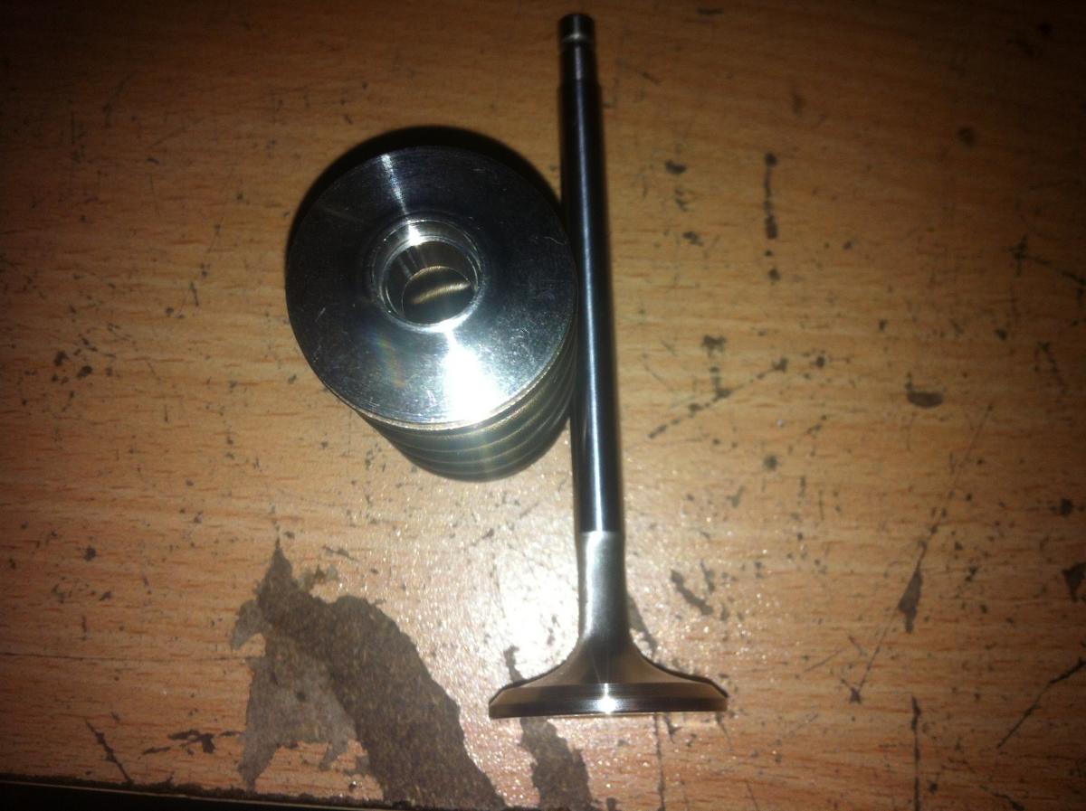

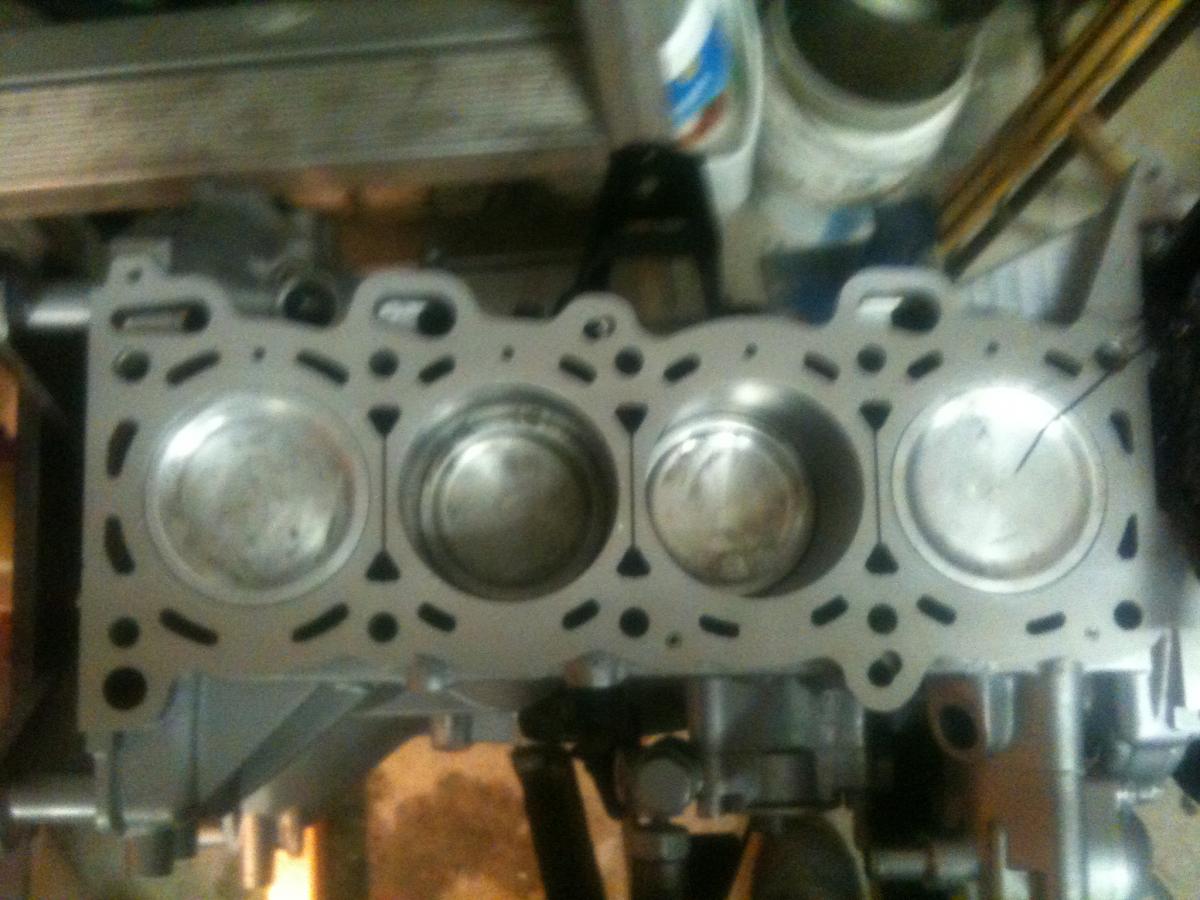

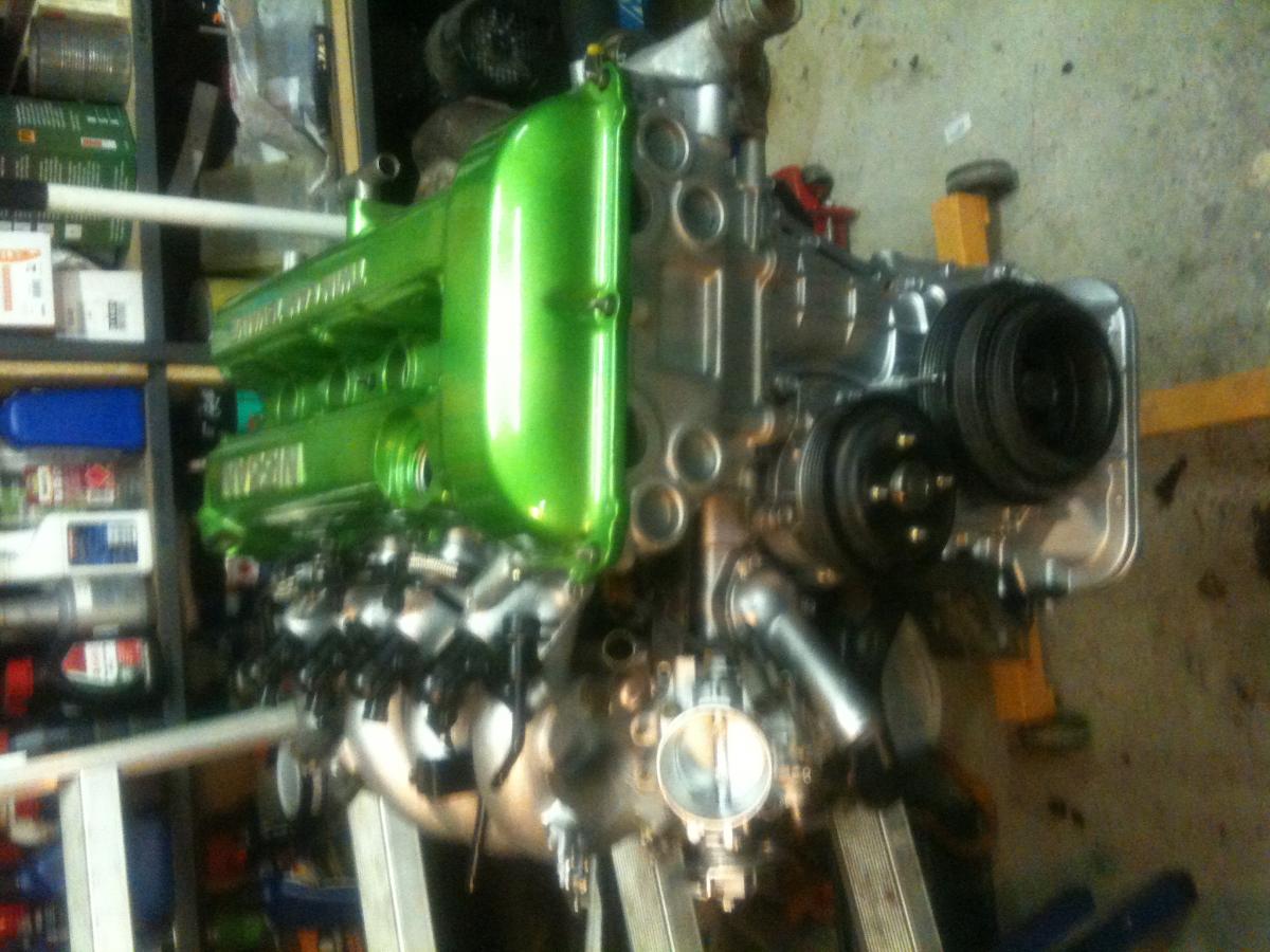

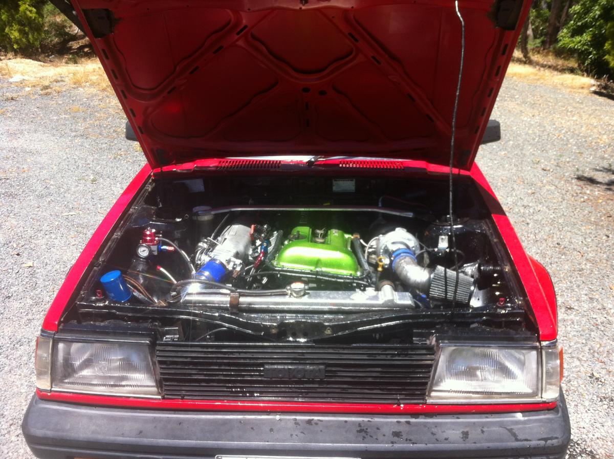

bit of an up date went to the dyno and had a tune done and made 190 kw and then it rand a tad lean and burnt a valve so i striped the head down and had some more head work done fited some new parts at the same time like stainless steel valves, titainiam springs, stage 2 cams and a bigger turbo gt2871r highflow, external oil cooler ready for retune in the new year hoping to make 250rwkw or get close to it
