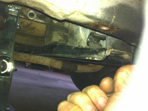

About an inch difference in height of the new gear box I have made up some spacers for the time being and am looking for a solution before massaging the tunnel. Any suggestions? Original cross member can still be used perfectly with the 4k 5 speed conversion.
post-8046-0-60210200-1344771395_thumb.jpgpost-8046-0-68910300-1344771416_thumb.jpgpost-8046-0-58045900-1344771437_thumb.jpg
Cut the hole for the lever, not sure if the bottom of the lever can or should be in the cabin, as this would help with the height problem of the new box.

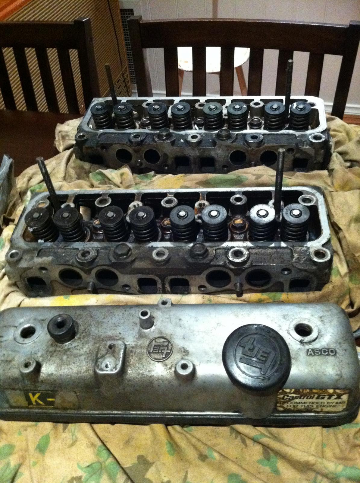

As a (keep the car drivable) option I am using the original Manifolds from the ke10 with a 4k carb. The exhaust pipe is aligned and ready for bolts.
Also spent my hard earned pennies on a set of butchered Twin inlets. Unfortunately the water cooling system has been hacked at to fit extractors. I plan to plug the grinds and re-tap the manifolds.
Next step is working a 3k head and setting it up to run the dual carbs.

Also with the gearbox, i'd look at using a rubber from another corolla, ie ke10/20/30/55/70 gearbox rubber, you might fix that'll make it all nice and fitting
Which one have you got on there?
Cheers, Jono.Your 10 looks sweet.
I don't much like the cats eyes either but since they cost $12 and are going nice and rusty so I left em on. hahaha
The box is from a Ke70 I think not 100% on that though. I will look at swapping the rubbers but am pretty sure they are totally diferent. cheers bud :drinks:
For your reference Glen, the crossmember I'm using is the bottom one in that picture.
