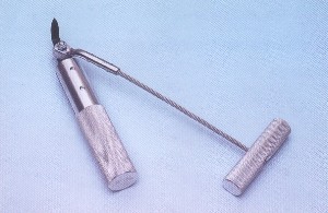

Or get one of these bad boys.
Form a loop and push it through the seal (at a corner is usually easier) and pull one end through.
Get someone else to hold one end, and work the string around the seal whilst putting some pressure on from the inside.
