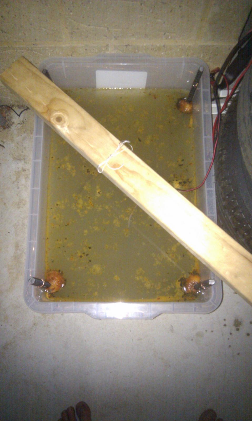

Waiting for funds to buy the rebuild kit and a few tools I need to start rebuilding the 4k. In the meantime I have been experimenting with some rust removal techniques. Obviously alot of this is new to me so don't judge!
I've started an electrolysis machine that's going to run overnight, will update u more tomorrow (if anyone is interested in how I did it just ask, there is alot of info on it out there but alot of it is misleading or wrong and even dangerous). Ok so basically all my bolts, brackets, covers and anything else thats even got a bit of rust, will go through the bath, everything else will be wire brushed, grinded or rust convertered, depending on what it is.
Minus the head of course, being aluminum it can't be bathed.

Two things I'm not sure on at the moment, is the time frame (probably varies with the strength of the sodium carbonate mix), and how well it go with alot of the old paint still on the item.
Will soon see!!

Sorry I forgot to take some photo's when they came out of the bath, basically they came out with most paint stripped, bare steel with black deposits where the rust was, which brushed off quite easily.
2 pics of the 2 items I bathed, now they arnt perfect and I didn't remove all the paint, but its just basically a protective coat, this item will most likely be replace quite quickly after it has gone over the pits, keeping it all standard looking until then. With all parts that won't be staying, looking not rusty, but also not a great deal of time put into them.
