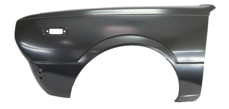

Hi Guys,
Came across these at a ebay store called RRR Auto Parts in Sydney. Their store link is
http://stores.ebay.c...sid=p4340.l2563
Has anyone purchased or used these ? I'd be interested in quality & fit.
Any feedback appreciated.
I note that this store also stocks some KE70 & AE71 panels also.
Cheers Banjo

I deal with After-market panels every day of the week.
Reproduction panels should be treated as a template to be made to fit your vehicle.
I say this because that the moulds/tooling that GENUINE/OEM have are different to after-market panel factory's.
Thus your reproduction panel will be different, it also comes done to material used as well.
After-market panels are normally a lot thinner then GENUINE/OEM, bolt holes do not line up etc:
There is a reason why insurance companys in NSW do not use after-market parts.
At the end of the day you get what you pay for.
In regards to RRR Auto Parts i have dealt with them i have found them helpful and product OK.
I'm not saying the product is crap. What i am saying is that you can't expect a After-market panel to bolt straight onto your vehicle with out alterations.
Just Remember that the dollars you save when purchasing a part/panel. You should keep some in your pocket for fitment and finishing costs.
I hope this helps and all the best.
