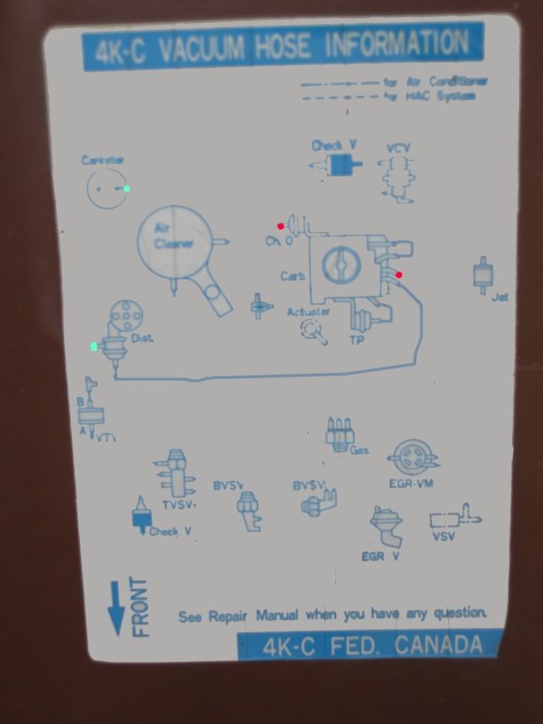

so that leads me to my question. what vaccum lines are required to run the dizzy to get proper ignition while cruising and at low rpm???
thanks in advance, and if any of you can help me, it will be a sigh of relief.
One hose that runs from the carb to the dizzy. It should be here...
Is this the only line that the dizzy needs for ignition timing? it seems insane that i would get a grand worth of work done to my motor and they wouldn't consider connecting that single little piece of tube.

Basically, the distributor has a function known as vacuum advance. It's used to advance the timing of the engine between low to mid range load increasing low speed drive ability.
It uses ported vacuum sourced from just above the throttle butterfly. The effect of the vac advance diminishes as engine speed increases as the low pressure zone in the carb moves from the throttle plate to the main venturi.
This is where the mechanical advance of the distributor takes over.

So, I picked up the car today; and the mechanic said he tried to run the vaccum advance straight from the throttle body and it didn't work. he claims i need an electronic or centrifugal ignition; is that true? what am i missing? i just got a 4k back with 0 miles on a top end rebuild, and the car feels like a wet fart below 3250, and rips hard at 3500-5000.
not to mention after a valve job; i still have tons of lash! is that because of ignition timing?
and pardon my naivete, but i see two vaccum ports sticking out of the side of the dizzy; which one do i use to connect the carb, and which do i block? i heard there's a "secondary" vaccum line that's very important, and the charcoal canister as well?

i found this online on kp61 forum: i hooked it up exactly this way and it seems to improve my low rpm acceleration a bit, but the ignition timing is still off i think....

I reckon close off all the vac ports and get the car running correctly, then start adding them in one by one. None of them are important.
If the points and timing are correct, it will run fine without a vac advance. I hooked up the vac advance and the charcoal canister and blocked everything else, but it was a few years back and I've changed to SUs so I can't check which ports I used.
