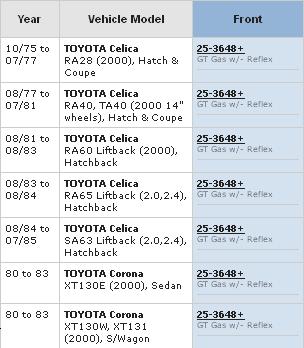

The struts had the original oil filled Toyota shock absorbers in them, when I got them, which had no part numbers on them. The Monroe GT Gas cartridges I bought were model 25-3648.
When I search the Monroe website for 25-3648, it pulls up all the following Toyotas that this model suits.
The MX62 Cressida does not get a mention, so maybe they are Celica struts, as I was advised, & there has been a bit of mix & match with rotors & LCAs by someone previously. The 25-3648 shocks certainly fit perfectly in the struts I have.

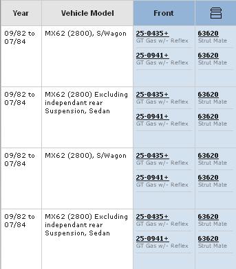

Monroes lists the 25-0435 being suitable for the MX62 Cressida.
