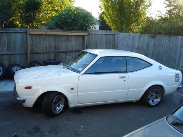

Keep it clean,keep it simple.
Retain the 3k/4k engine they're fairly hard to kill,
Put flares on and some suitable old school rims (hotwires tridents spitfires etc).
DON'T put new style big wheels on it's just not right!
Lower it of course and enjoy.
My ke35 is clean and simple and i reckon it looks great
I'm NOT going to put new wheels on! thats not nice!
your car has the right rims and hight :D awesome car!

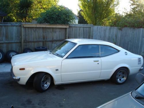

I'm running 13x7 wheels with +3 offset on my 1971 KE20 and have no issues with fit. Tires are 185/60/13.

Nice ride. I have a ke55 sedan in the shed here which has plenty of rust but thats ok as i have plenty of time. the ke35 got stripped back to bare metal and had new sills,new spare wheel well etc all fabricated. They're old cars so expect a bit of rust. 7 inch wide wheels should fit, my wheels on the ke35 are 14x7 with 185/55/14 tyres. i've run it with 1 inch spacers before as well. Looked great but scrubbed the tyres plenty even with the flared guards.
