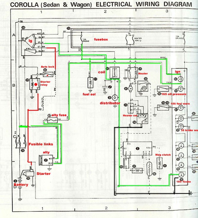

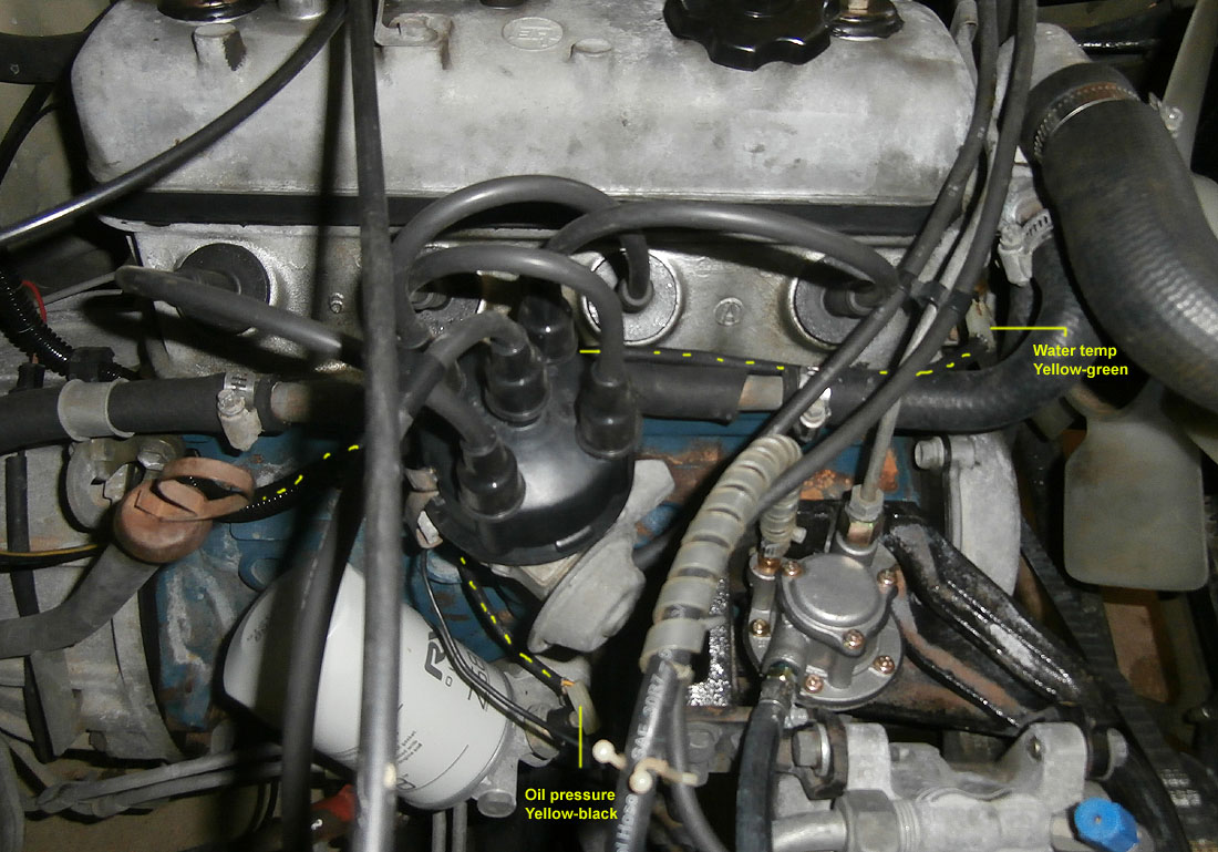

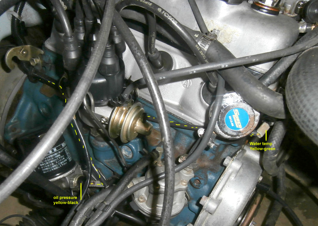

altezzaclub Posted January 23, 2014 Report Share Posted January 23, 2014 Ah- you definately do have wiring problems! OK, the "R" on the coil name stands for 'resistor', and that would have been a 9V coil. Without the 'R', the coil will be 12V. So you will have to run both the 'start' ignition wire that is on the coil +ve normally, and the "run" ignition wire that is on the ballast resistor normnally, both to your coil positive. This is because the 'start' wire feeds 12V to the 9V coil when cranking, so the coil works at 100% efficiency under the reduced voltage from the starter motor load. Then when it starts the ballast resistor drops the coil feed to 9V and just dumps the other 3V out as heat. Your new coil will run at 12V when driving, but struggle a bit when starting under 8 or 9volts. Not that it will worry you, I expect it will be fine for years yet. Now, the temp gauge wire is earthing out if the gauge goes to 'hot' when the motor is not running. I have a feeling it is on the oil pressure sender unit, as that goes to earth when the motor is off. Find the temp sender wire and trace it. On both my cars it is yellow-green on the temp sender, and yellow-black on the oil pressure sender. Those wires join into a loomb behind the dizzy. Quote Link to comment Share on other sites More sharing options...
altezzaclub Posted January 23, 2014 Report Share Posted January 23, 2014 and a circuit tester. Excellent- first thing is to pull off the wires on the coil +ve and the ballast resistor +ve and make sure that the coil gets power when you turn the key to crank it over, and the ballast gets power when you just have the key on 'ignition'. Run the negative wire of the tester straight to the body somewhere to earth it. Then both of those wires go to the +ve of your new coil. Once you can confirm power to the coil +ve, hook it up and check the coil -ve for 12V to earth, then with it all hooked up and the points open, check 12V to earth on the points arm. If the points are closed you won't get a voltage reading as it goes straight through them to earth. Quote Link to comment Share on other sites More sharing options...
