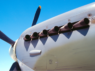

ke70dave Posted February 24, 2014 Report Posted February 24, 2014 Its also common on a spitfire. I can't remember where i read it, but apparently doing this gave the spitfire an increase in thrust. A 27ltre engine moves a CRAPLOAD of air, and if you point it backwards then it will make you go faster! if you do this to your 202, I would almost guarantee it will sound aweful, look aweful and go considerably slower. Quote
snot35 Posted February 24, 2014 Report Posted February 24, 2014 You've forgotten that it's also supercharged at up to 25 pounds :) Another no for side pipes. There is a lot to gain from properly made manifolds. Single pipes like that are just a PITA Quote
