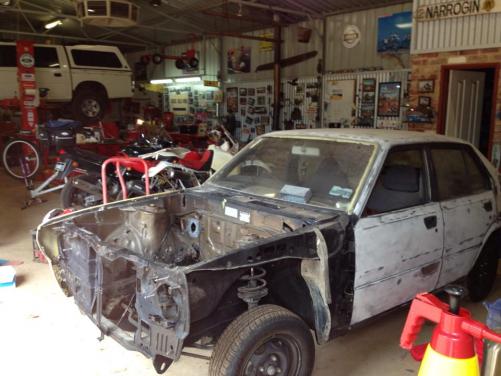

Hey everyone been lurkin on the forums for a while now and decided to start a build thread for my ke55.
The plans are pretty simple;
  • Sand it back and fix all the rust and total open door respray (not certain on what colour yet, any ideas?)
  • Worked 4k/5k. Specs will be, Knife edge crank, bored 60thou, 12.8 to 1 compresion ratio, custom grind cam, smallport head, (they make more power) 350 holley, custom made extractors with 2'' straight through with a spintek muffler and a lightened fly wheel. Iv been racing ke55's for about 5 years now and know how to get them going, and with a dyno in my shed it will be quite easy ;).
  • Need to source a 5 speed! if anyone has one in WA let me know!
  • R31 diff
  • Import some jdm wheel 15x8's
  • get the interior refinished in blaaaaaaaack
  • coilover sleeves for the front?
  • and then all the over obvious one like lowering sound system etc...

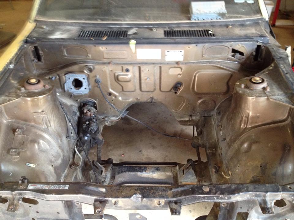

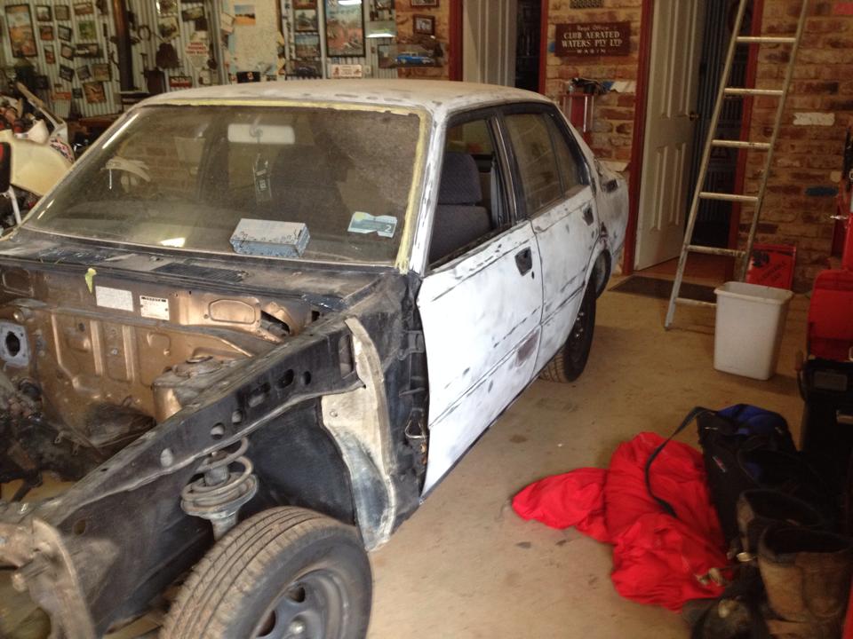

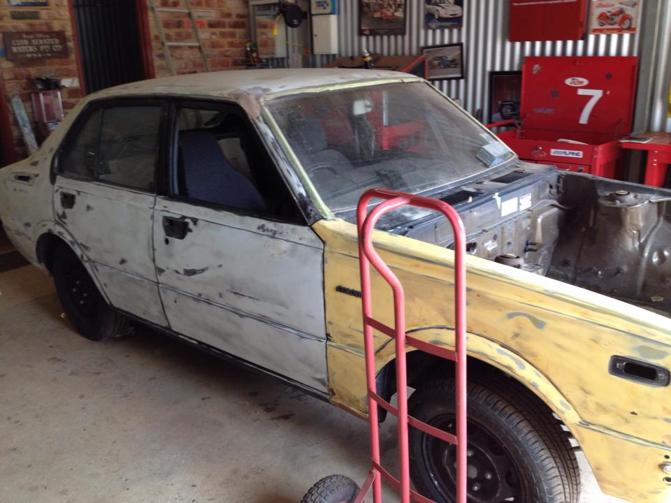

Here's a couple pics of what it looks like now.
