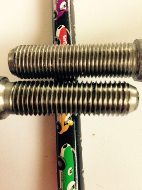

outer
coarse 45047-19015 aftermarket TE426
fine 45047-19016 aftermarket TE534
inner
coarse 45046-19035 aftermarket TE425
fine 45046-19036 aftermarket TE535
Here is a photo of an outer tie rod fine vs coarse. if your really keen you can count the threads, but should be able to tell by sight. It was coarse thread up to Feb 1969, but hard to know what you have on basis of date.

From that comparison it looks like i have the course thread tie rod ends, I'll upload the pictures i have of mine, when I'm on the pc tomorrow.

So to my eye, comparing to your photo Pete, the ends on my car are course thread.

actually after studying the photos again, I'm leaning more towards fine thread, hmm i may have to count the tpi..
